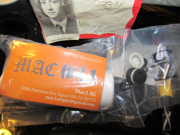

​ The 760 Powermaster variant 1 was my first pellet gun, after having a long-barreled Daisy red Ryder BB gun. Then @ 10, dad teachin' me to shoot and handle guns properly with, " spoils of war". So the 760 v1 means something to me, since I saved paper route $ to buy it in 1970. It was built June 1970. And they can be modded! My 760 v1 is getting a N.O.S. 761xl rifled barrel, and the mac1 seal/piston upgrade kit. And a 1892 Winchester-style butt plate I'm making by hand. Butt that'll come later, as the 1/8" steel is too thick and I had to redesign the butt plate pattern.

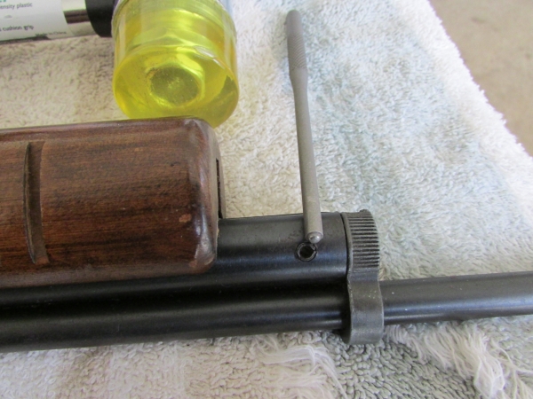

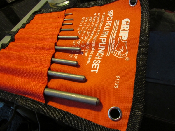

​ Anyway, to come to the point, My son came home from work early this morning and found a package on the porch. My set of roll pin punches arrived late yesterday evening! A 9-piece set you need to knock out the rolled-steel pins Crosman uses in the elbow joint of the forearm stock pump. Crosman's pins require a 5/32" punch so far. Got'em from home depot for 13 bucks.
​ Knocking out the roll pin on the 760 variant 1;

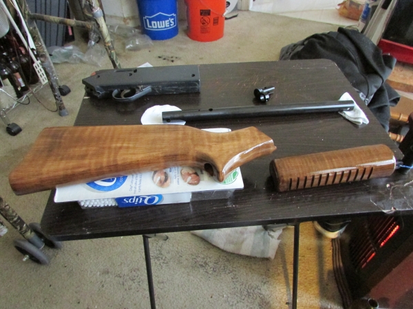

​ And a peek at the stocks and pump tube. That's the original stock's wood grain folks.

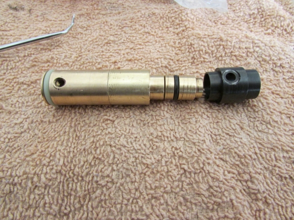

​and the exploded view of the rebuilt gas valve assembly;
Reassembled with new internal parts and seal upgrades;

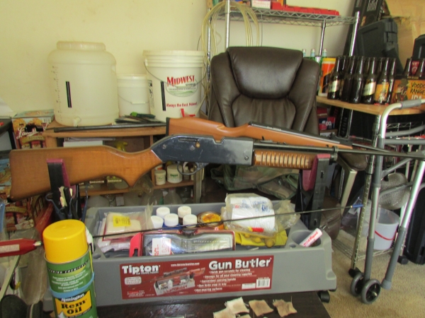

Just got it back together today! I'll have better pics in the video coming tomorrow. The old bolt, polished a little with the Dremel and a wire wheel, along with Nevr-Dull, looks better and fits snugger in the NOS 761xl barrel. Here's a couple pics I took late this afternoon after reassembling it. Needs cleaning yet. Went from this as I found it, cleaned up;
​ To this restored after 5 months work and nit picking;

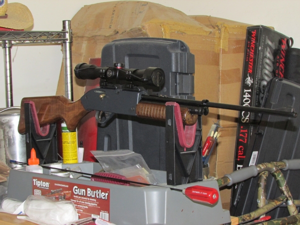

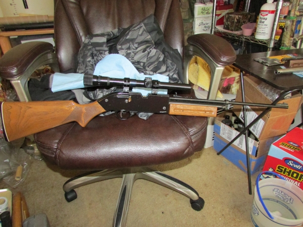

And this, Simmons 4x32 on 2.5" MOE Picatinny rails with Hawke low-rise Weaver mounts;

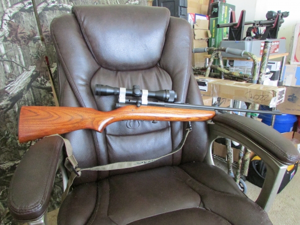

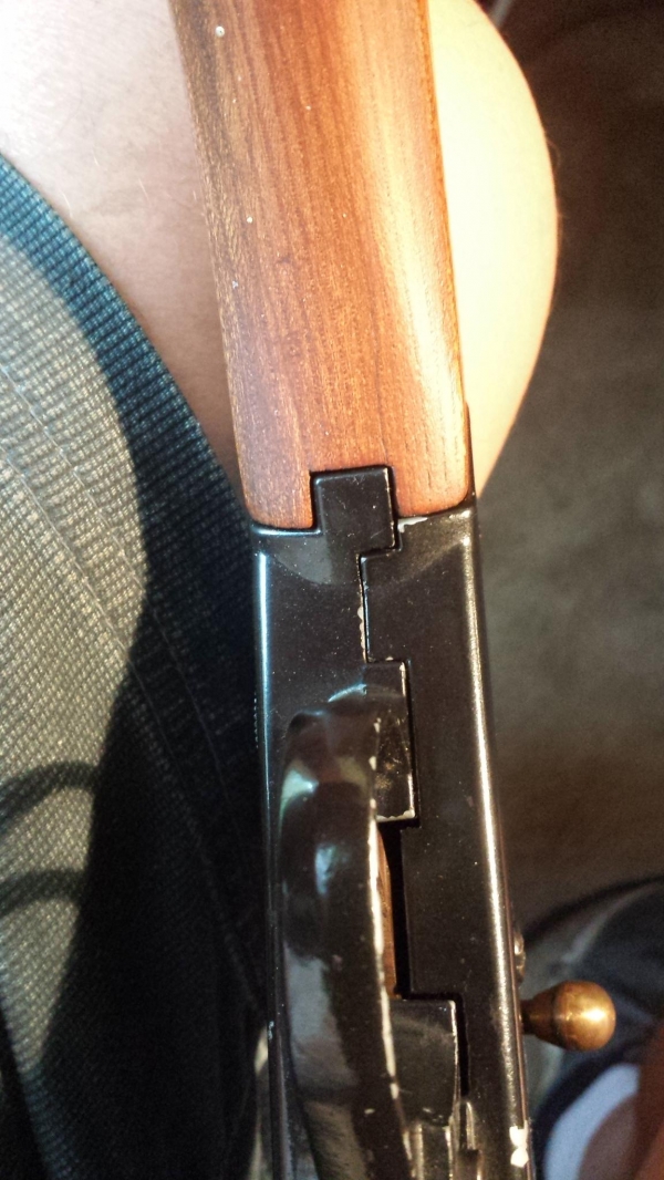

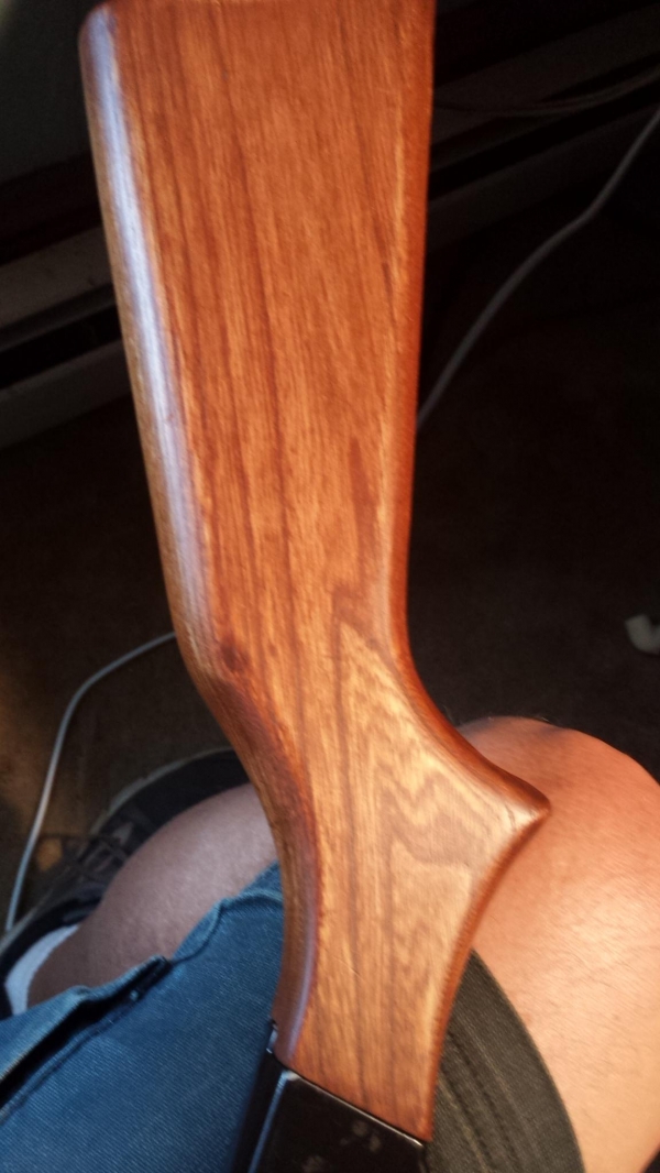

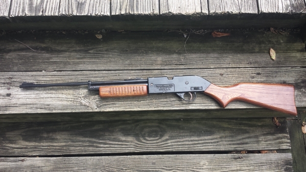

Yes. mine is a variant 1, but they were built from 1966 to 1970. The earlier models had the square dado vs the semi circular one on the later variant 1's like mine. Mine was built June 1970, so near the end of the production run. And the species of wood still looks to be Elm, unlike mine, which looks like low-grade flame maple? Different blank used to cut the stock from can give more or less grain figuring because of that. That depends on the particular tree the stock blanks are cut from, the angle of the cut, and what part of the tree/trunk it was cut from. My 160 Pellgun appear to be an Elm stock...
