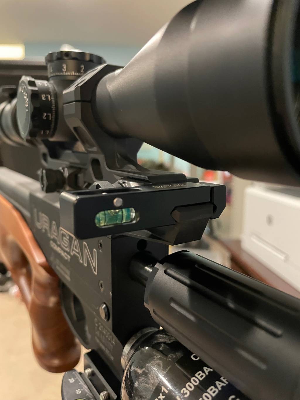

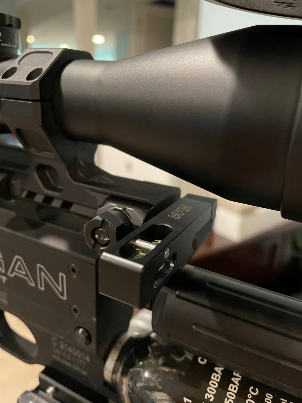

Finally found a good Pic Rail Bubble Level
There's so many out there that leave so much to be desired. I've tried a bunch of $10-$20 ones and they are either off on the bubble or don't mount perfectly level themselves.
Browsing around I found this MK Machine billet Al pic rail bubble level. I took a huge chance @ $50 but I will say this is the best bubble level I've owned.
