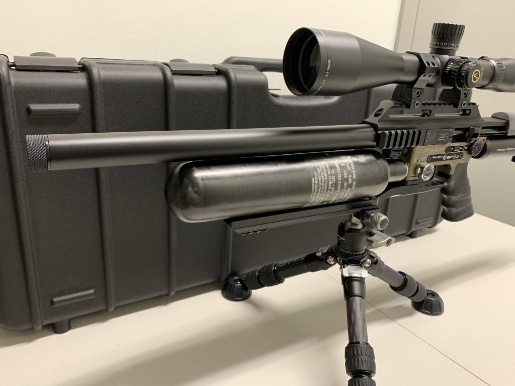

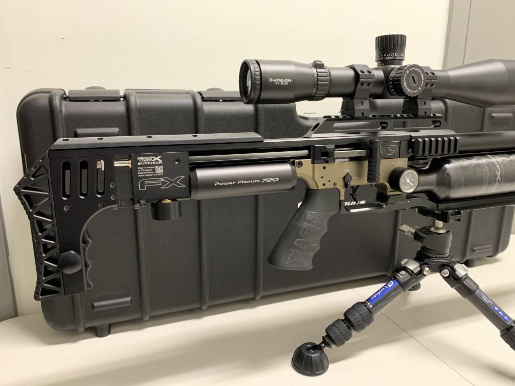

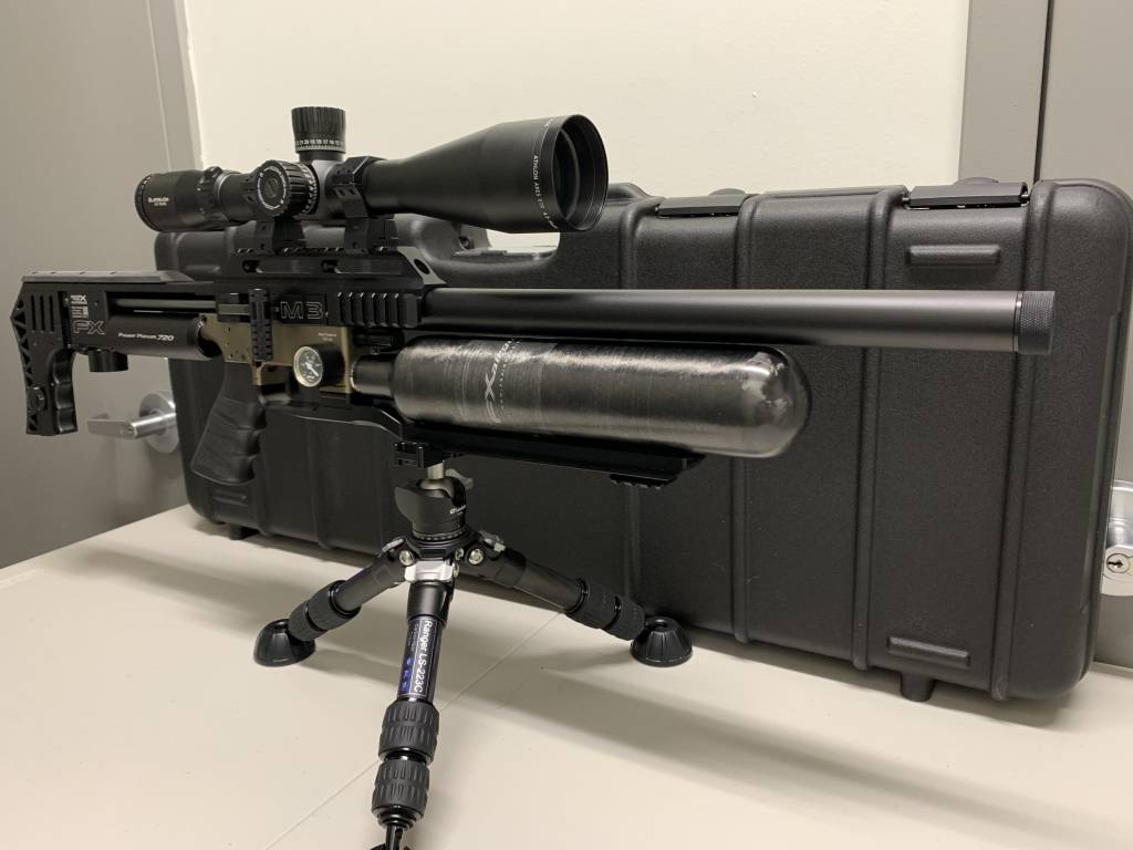

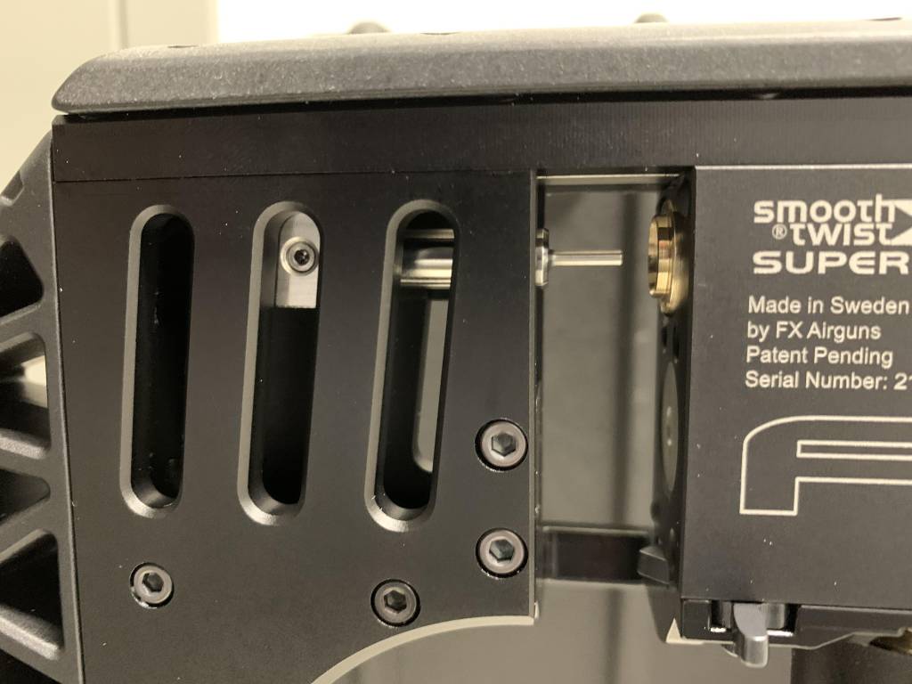

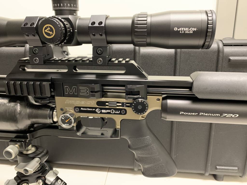

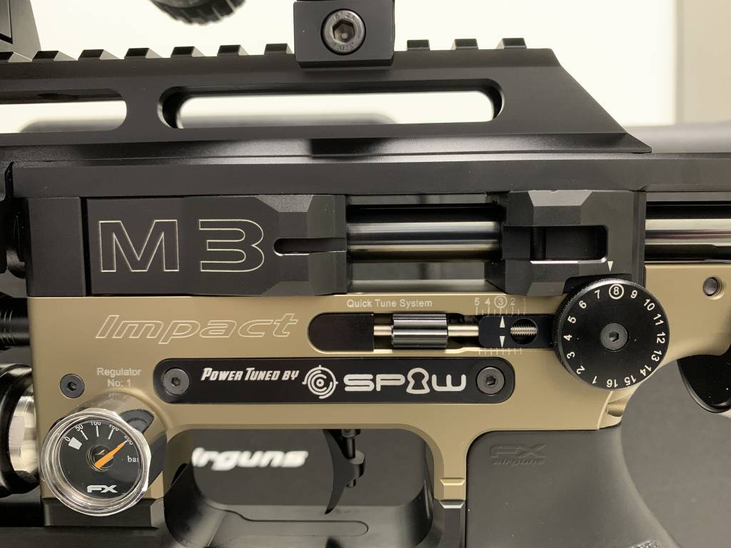

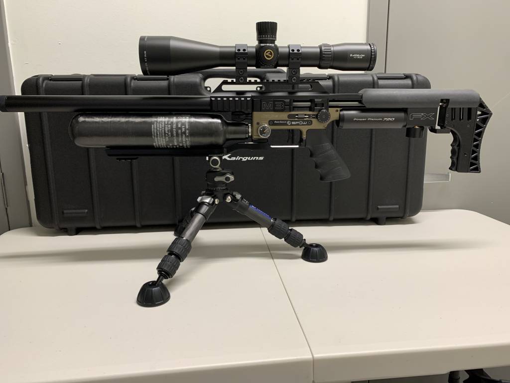

I had a dual transfer port put on by Ernest Rowe I also put a huma slug probe in and had my regulator re-stacked So it will hold higher pressure. And a heavier Spring For slugs. Then had Ernest Rowe do a touch up tune on it. It's truly amazing by far my favorite airgun.

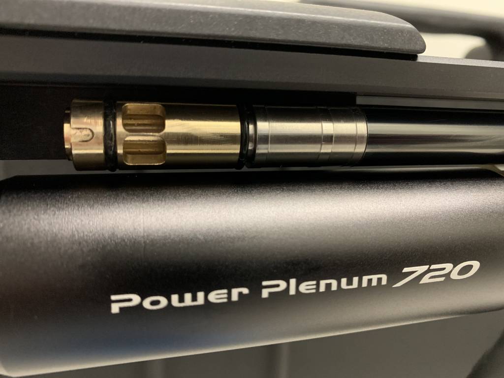

My M3 is tuned for slugs and pellets I have a power tune on it but can shoot pellets as well the resin I am showing this is because when you change calibers the tiny set screw gets stripped and makes the pellet prob loose. So I put on this stronger prob holder because it's better and stronger i also put the pin prob on because I like power when I shoot slugs so to try and answer your question I don't know yet I just put in on tonight that's why in the photo you don't see the Kraford and lypt prob holder installed yet but I can shoot 44gr pellets at 880fps up to 1,050fps and the hybrid slugs about the same I like JSBs and Fx slugs. Last time I shot before the new tune I was half inch at 75yards in a bit of wind am not the best shot believe me hahahah.
