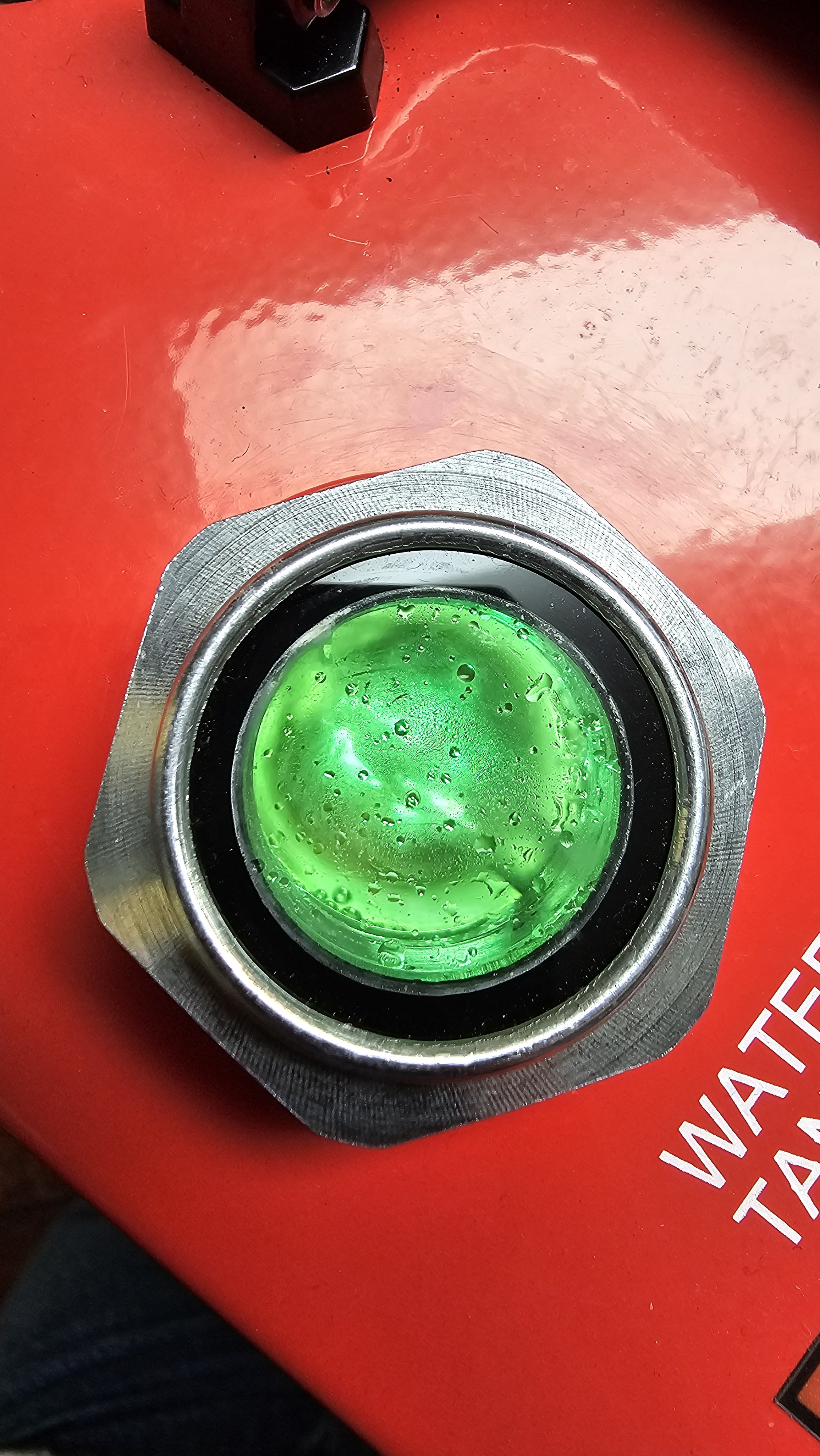

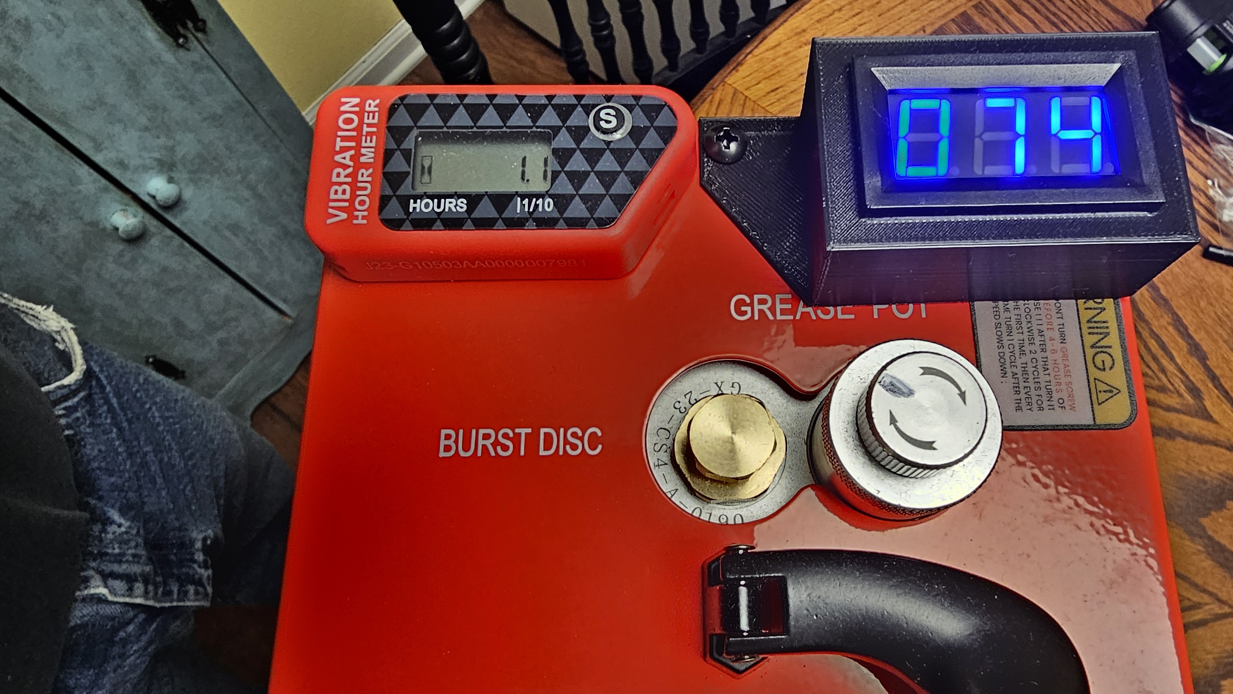

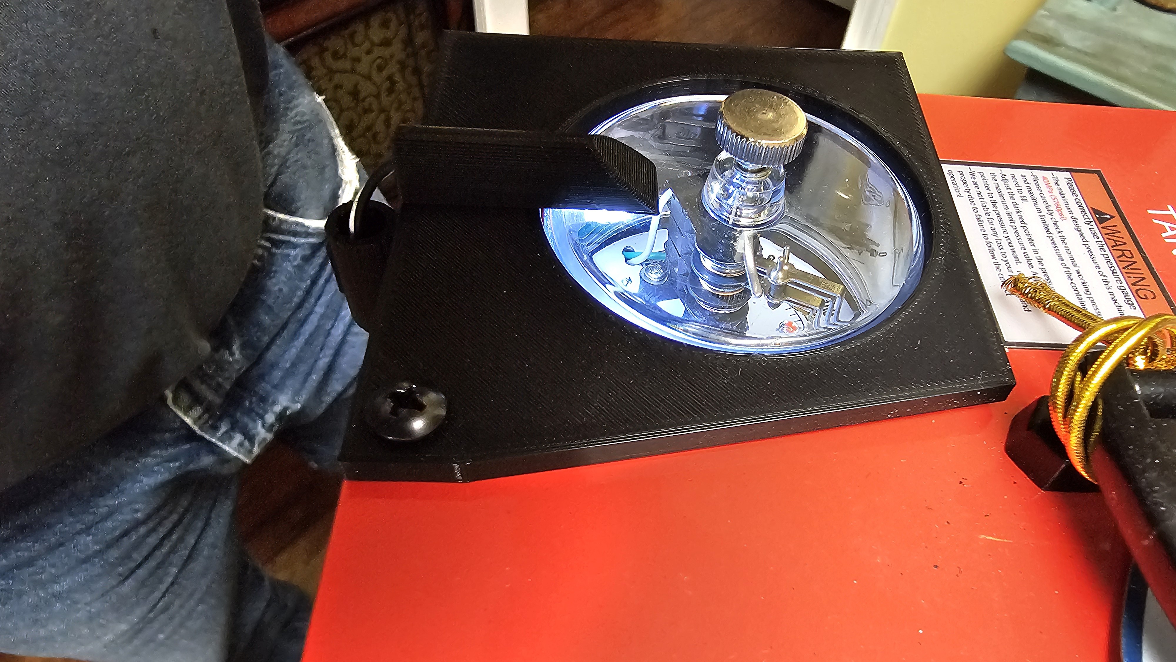

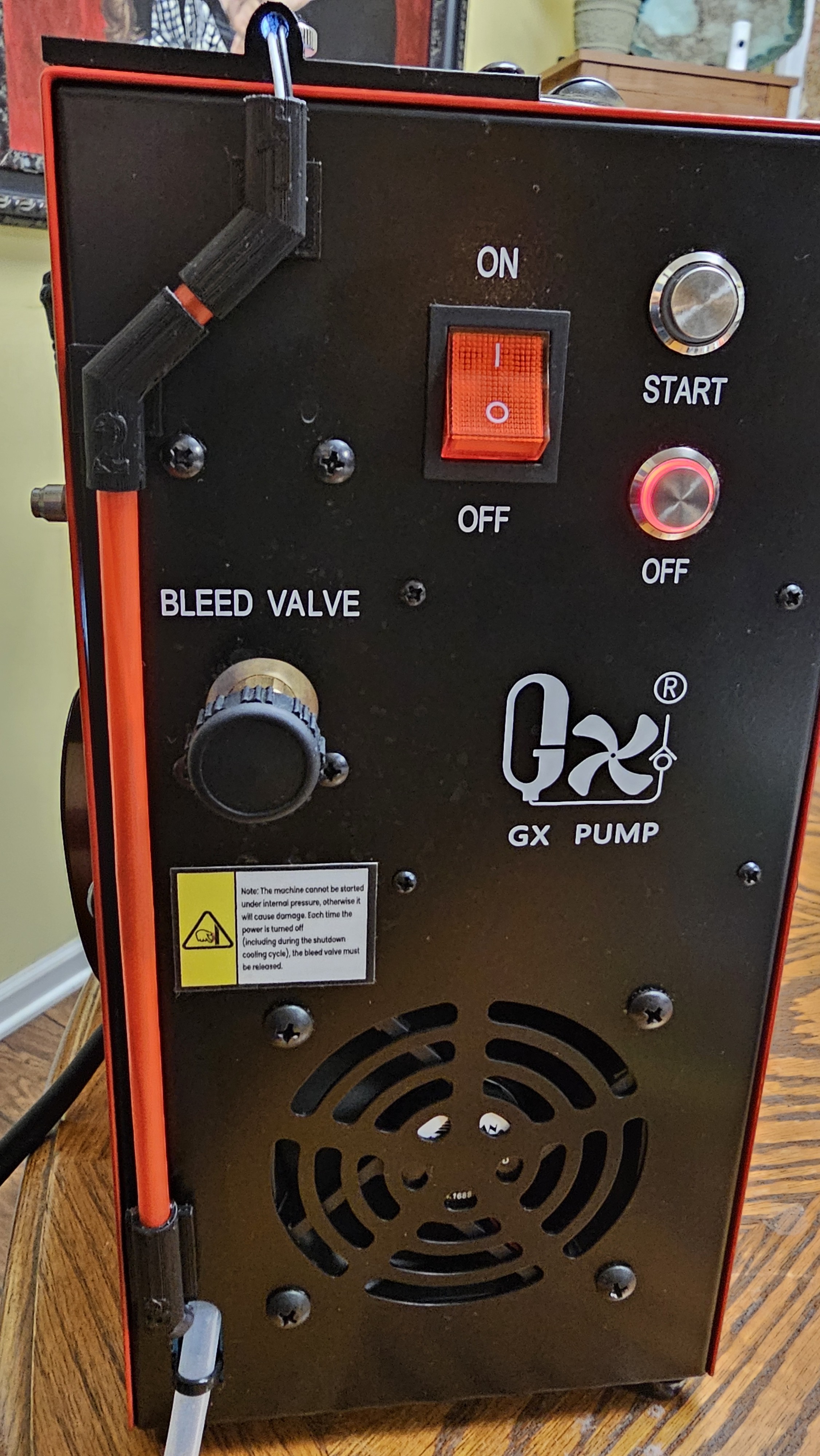

Wanted to add a run time meter, temp gauge, coolant tank light and pressure gauge light. Worked on it off and on 2 weeks, mostly nights after work. I 3D printed all the small pieces to add the mods by using existing factory screws and run the wiring to keep from cutting any new holes in the case. Took a bit to figure out the wiring route but it turned out to suit me. This compressor is totally awesome! It's super quiet, and runs really cool. I've got a tad over an hour on it and so far its working flawlessly.
