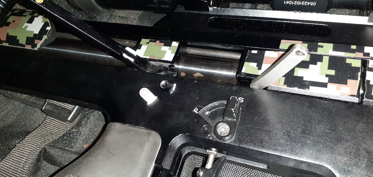

Now it happened, the cocking handle of my M60B broke.
As it has always felt really flimsy, so i was kind of waiting for it, while being extra careful.
It happened when the hammer spring was increased, to give the HP valve a proper smack. but not while cocking, but somehow during the shot (recoil?), as i only realized when trying to re-cock for the next shot.
This will take me a while to fix. Seems like i will have to carve something from steel. Since i have no proper tools, it will be a job for an angle grinder, drill and file.
If anybody of the readers here has an idea what is the best way to proceed, please let me know. I bet i am not the first one with this kind of damage to the gun. Are spares available somewhere in the euro-zone?

Dang that outer pin hole on link is wallered out big time !!
Kinda looking like you have worn the gun out.
Poor metallurgy / materials sadly has a lot to do with it.
as mentioned in a previous response, i have had the gun since february 2024, and it was my 1st pcb. i have used it a bit since then. the lever and link are not just crappy material, but also very thin on top of that. from what i can tell, the weakest part of the construction, Something that looks like it MUST wear out sooner or later.

one thought on the reason for the strong wear-out of the lever, is that the .30 and .35 versions have a stronger hammerspring than the smaller calibers, and additionally i have increased the HS tension when experimenting with a max. power tune with the new HP valve. the cocking handle , besides anyway being made from crap material, is just not made for this. would be really nice to get a stable one, but when made from harder material it might grind away other parts of the rifle....
