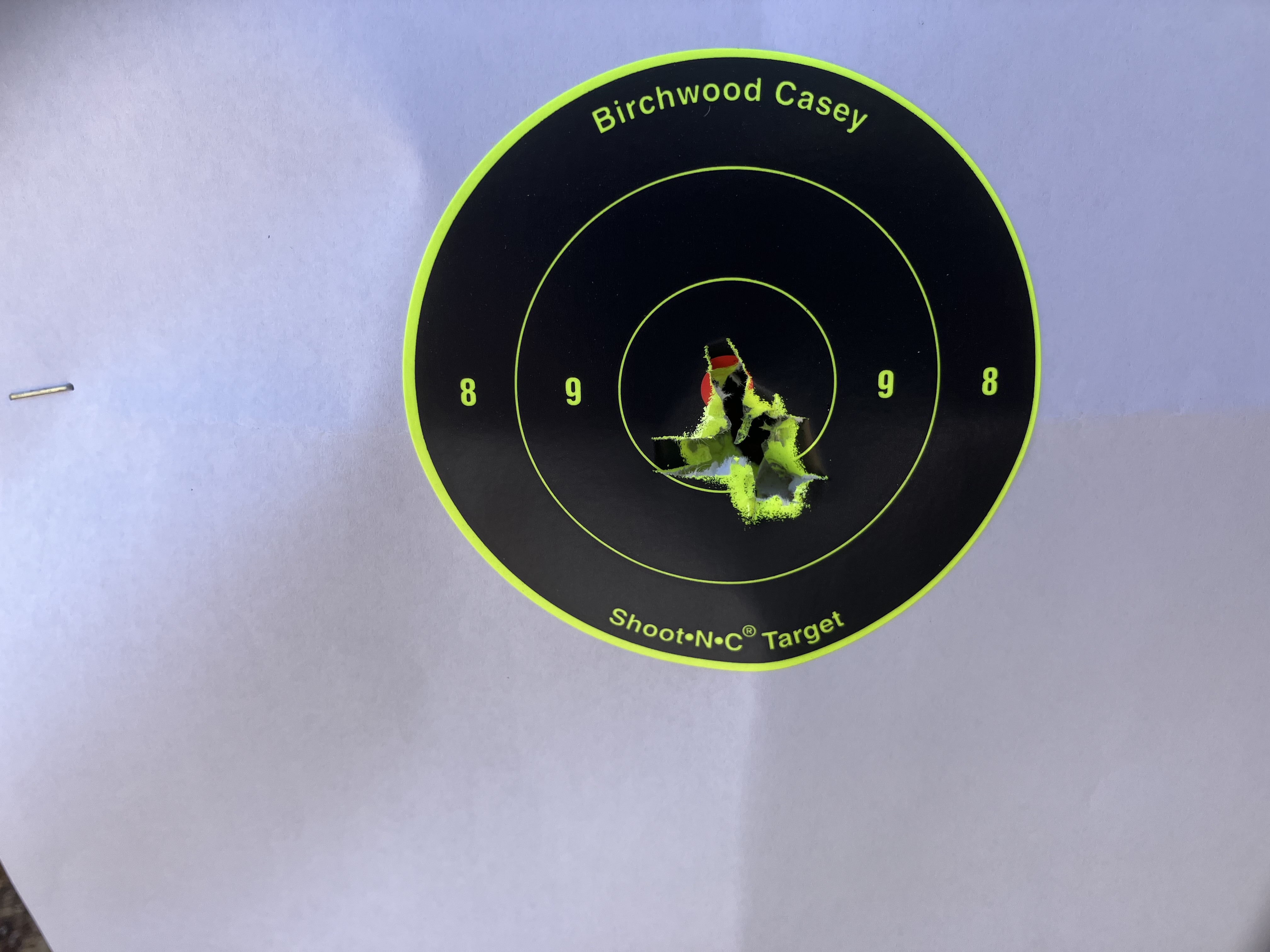

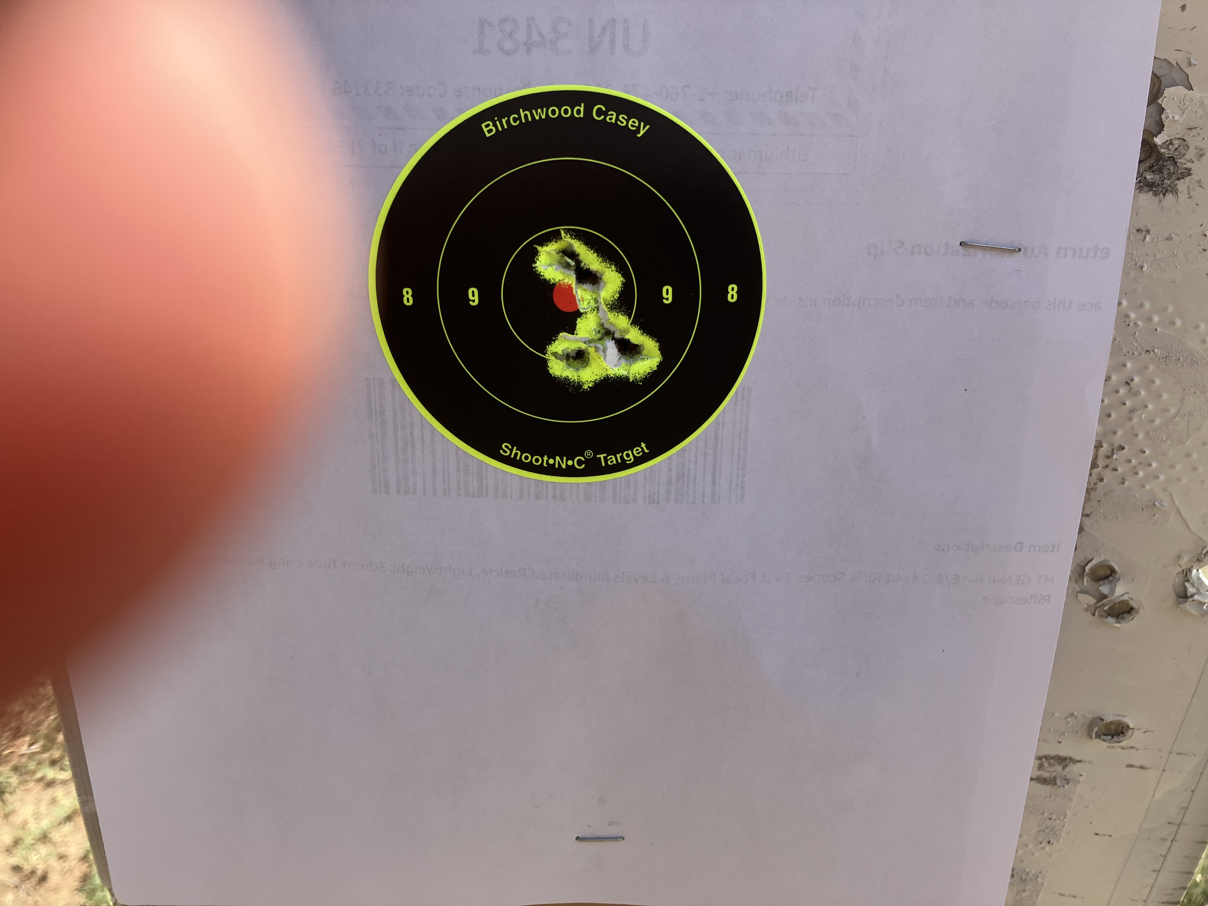

I thought I would have a super accurate light weight Notos with a 380mm FX barrel, And the big question is the FX barrel more accurate than the stock china barrel,,,, At 30 yards NO ! at 50 yards just a very little , Dime size groups at 30 yards and quarter size groups at 50 yards , Just about the same with the OEM stock China barrel, Its still light weight and fun to shoot, The key to the Notos is light weight , If this think weighted as much as my other guns I would just set it aside and not mess with it,, But its light.For my testing I did install a 6x24 Arken scope light scope I should say. I got a carbon fiber 300cc bottle just setting here and every one is saying the dream regulator is the best way to go for a bottle,, Not cheap but if its the best to install on my cheap as Notos , I'll look for one in the US. Hint, Hint who has got them?

i think the same. i have a buddy who has a notos with an fx barrel kit installed with extended plenum but it’s shooting about the same as my notos stock barrel. i fully ported both his and my gun the exact same way.
stock barrel really isn’t bad.. it’s actually pretty good, even better when you’re able to send 18gr near 800fps.

The barrel isn't magic, your tune has to match. You'll have a bunch of money in a notos when you could've bough a zelos or a Dreamline tactical compact by then more than likely. I like to tune and tweak guns and considered a notos but couldn't make it make sense. If it's something you'd enjoy building then I have to say go for it by all means.

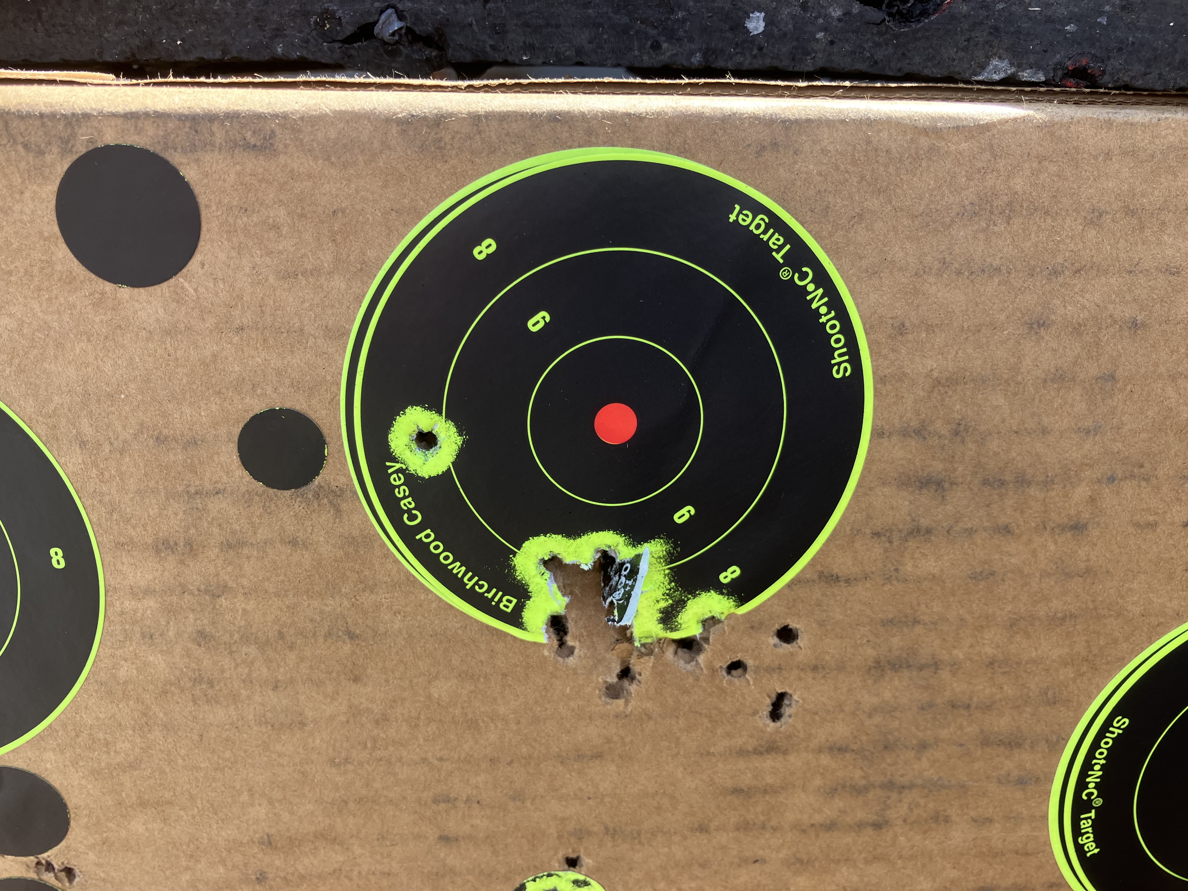

Alright, now I'm going to try to help with that liner ordeal.
What is your plenum pressure?
What pellet?
What velocity?
Is the liner installed in the right direction
Have you cleaned the liner in some fashion yet?
Are you using a moderator, which one and what caliber is it for?
How does the accuracy "fall apart" stringing in a line or willy nilly? Do you ever get 1 really wild one that's way off target?
