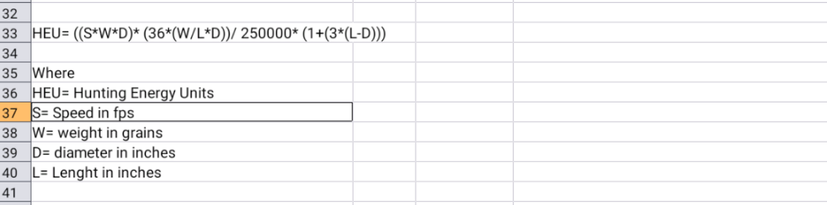

Final formula for obtaining the Hunting Energy Units on Air Rifles.
Taking into consideration:
a) That in Air Rifles (as it is when hunting with a bow and arrow) the killing power is related with size of damage (cut-hole) caused in vital tissues;
b) That the damaged caused is related by a combinations of velocity (fps), weight (grains), diameter, density (expansion and resistance to hard tissue) and shape that facilitates penetration of the pellet/ slug.
c) Not all previous factors are taken into consideration when making calculations of foot pounds, and therefore, foot pounds are not related with size of damage on tissue, and then not necessarilly are usefull for getting to know efectiveness for hunting purposes.
There are of course a lot of factors that could get influence on an effective shot. The main one is shot placement. So the utility of the calculations would be considering exactly the same point of impact on the same kind of hunting and, at the exact fps on the formula (what at the moment of the impact is almost impossible to be precisely meassured).
We only are able to meassure the speed of the pellet/slug at the exit from the barrell. Then we should take that measure.
Taking into consideration all the above explained, the following is the formula that, in my opinion, should be taken in regard of Air Rifles hunting power, because it includes all the meassurable variables that have influence and that we know of the projectile. Those are (speed, weight, diameter, density and shape (that cause resistance to penetration):
Reactions: kirkb
Where did you get your formula and have you done a units check?
I worked a lot in formula trying to incorporate all the meassurable aspects available.
What you see is far from being the first try. I Made a lot of runs to correct the inconsistencies found on previous versions of such formula.
I do not understand what you mean for "units check", could you please explain to see if I can give an answer?

At the end the main idea was to answer the following question:
Considering you have three air rifles, a .22, a .25 and a .30 all of them shooting at the same 55 foot pounds of energy, could you say that for hunting purposes the three are the same?
Trying to answer that question, the exercise gave the answer that the lethality of the three calibers are far away from being the same.
That's it.

I have a spreadsheet where I calculate the Taylor knockout factor and something else that slips my mind right now in addition to fpe. But I don't think the other factors tell us more than the fpe. If what we want to know is how reliably a gun/tune will kill we need to know how wide a hole and how deep a hole it will make. Formulas don't give us any sort of absolute answer on this. I like to test in wet paper, these days I use old magazines. Some may use ballistic gel or soap. As long as you can cross reference your test material to your quarry I doubt it matters what you test in. I tested penetration of my Prod with a couple different tunes and several projectiles in dead squirrels. That gives me a rough idea how many pages penetration in wet paper translates into through penetration from the side on a squirrel. I had to increase the fpe of my Prod to get through penetration and when I did, I got no more squirrels running off after a body shot. Pellets rarely pass through with Prod shots because they normally go through at an angle, or hit the skull or front leg bones. But they do deep enough to reliably kill with decent shot placement.
Shot placement is #1, then enough penetration to reach the vitals, then wider holes kill quicker. I am not a fan of expanding projectiles in airguns but if you have enough penetration with them, the wider hole should kill quicker. My issues are I haven't found any that are as accurate in my guns as simple domed pellets and they dramatically reduce penetration in my tests. At least a couple of my guns would still have adequate penetration but they also drop squirrels well with simple domed pellets. So I occasionally test another expanding projectile but I use domed pellets.

"Shot placement is #1, then enough penetration to reach the vitals, then wider holes kill quicker. I am not a fan of expanding projectiles in airguns but if you have enough penetration with them, the wider hole should kill quicker. "
Absolutely agree!
I have confirmed that JSB Hades in.30 Cal are extremely effective on chest shots on coyotes.
But what you say is the key: Shot placement, enough penetration to get to vitals and wider hole to cause more damage on tissue. That is the name f the game to get cleaner and faster kills.
