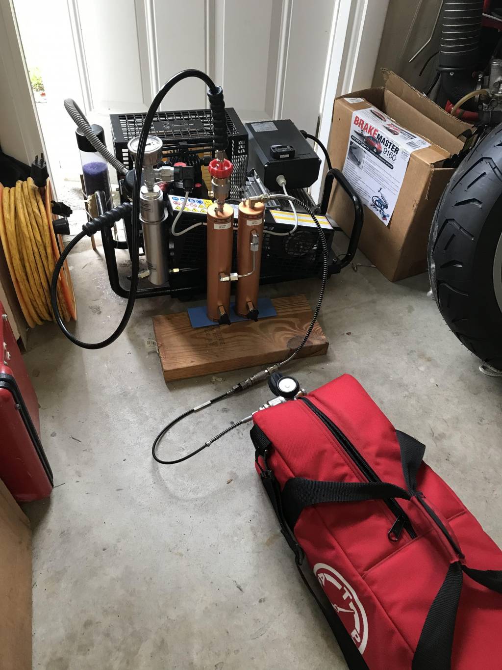

My daystate MCH-3 has a water separator but no filter. I added another combo pack air water separator and filter plus I take desiccant tower.
In addition to purging my Yong Heng every five minutes of use I change my small cotton pre-filter every twenty. This has allowed my desiccant filter to survive for a year. When the small filter on top gets damp, which will be soon, I will replace the cartridge in my Tuxing filter. I fill at 65-70F and 55-65% humidity. I seldom run my compressor over twenty minutes a week.

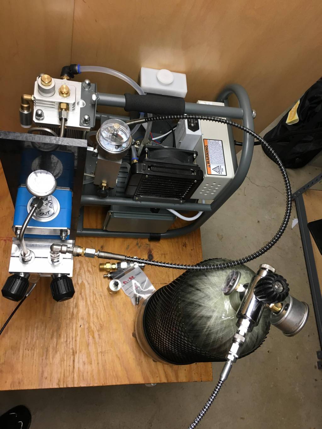

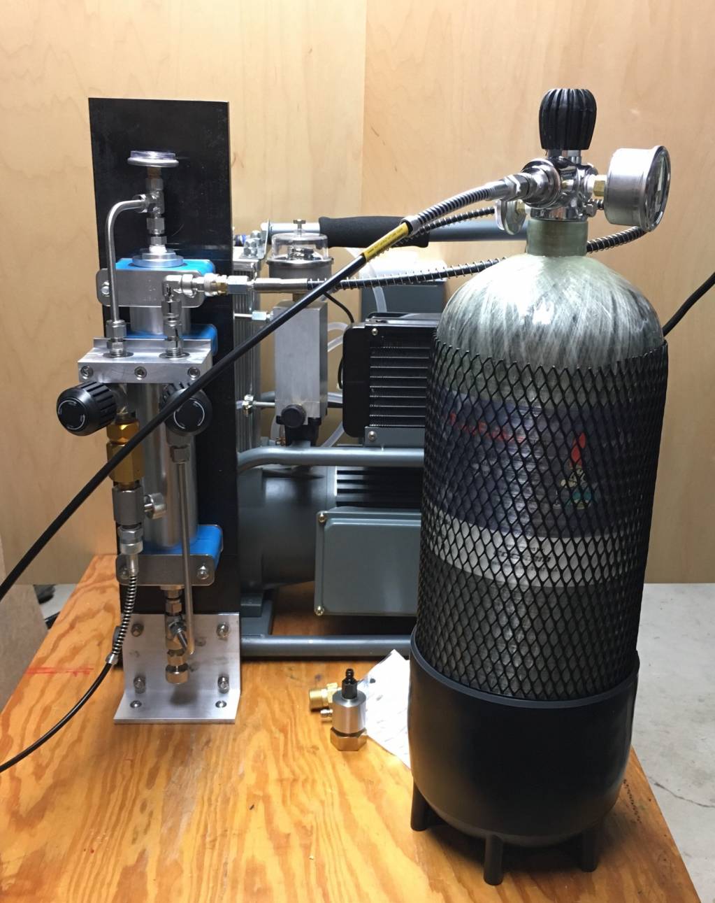

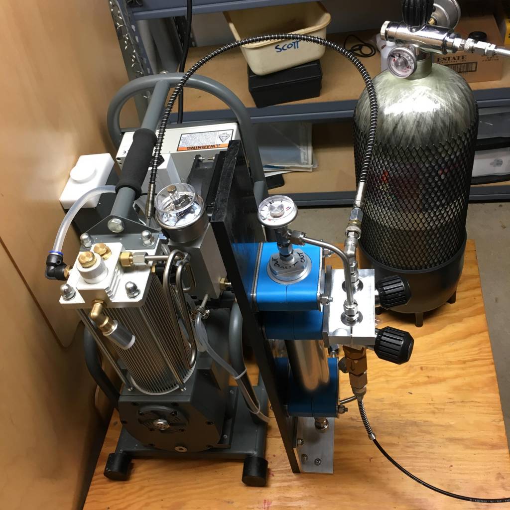

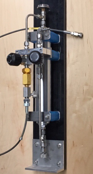

Yeah, one of my considerations when buying the drier was the additional volume a drier takes up. I wasn't really concerned with the driers volume because an important thing on molecular sieve driers is they must be kept at a minimum 1700 psi after initial pressurizing. If pressure is not maintained the water drop out of the sieve and bad things can happen, as in potential BOOM. Molecular sieve beads should never be wetted with liquid water. Your typical set up with a molecular sieve tower is to have check valves and a PMV (pressure maintaining valve) so that once the compressor turns off the pressure stays in the drier, then once the compressor turns on at your next session it only has to re-pressurize a few inches or so of small lines. On my setup, in addition to the PMV I added to Sherwood high pressure valves on the input and discharge side of the drier to guarantee I don't loose pressure between sessions.
As soon as I get my set up complete I'll post some pictures.
dc8cappie and biohazardman,
Nice setups you have. Also forgot to mention above that the molecular sieve driers MUST be vertical at all times. One thing I changed on the plumbing that Joe Brancato did was put a tee at the bottom of the drier that one side went into the drier, then a straight down leg went to a drain valve and then the one that tee's to the side (horizontally) and then straight up to a male Foster fitting that is the air input so that all condensate went down and not into my valving.
Randy
