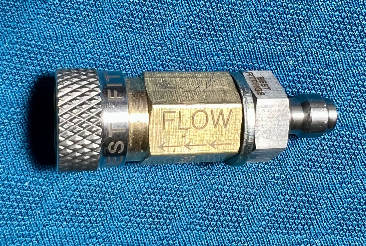

I recently found this little one way valve from Best Fittings, it allows me to fill my tank using a smaller compressor like the Benjamin Traveler. It prevents back flow from the tank to the compressor, so there's no chance of a higher pressue flowing back at the compressor when resuming a fill after letter the compressor cool. This thing has been a real game changer for me when refilling my tank!

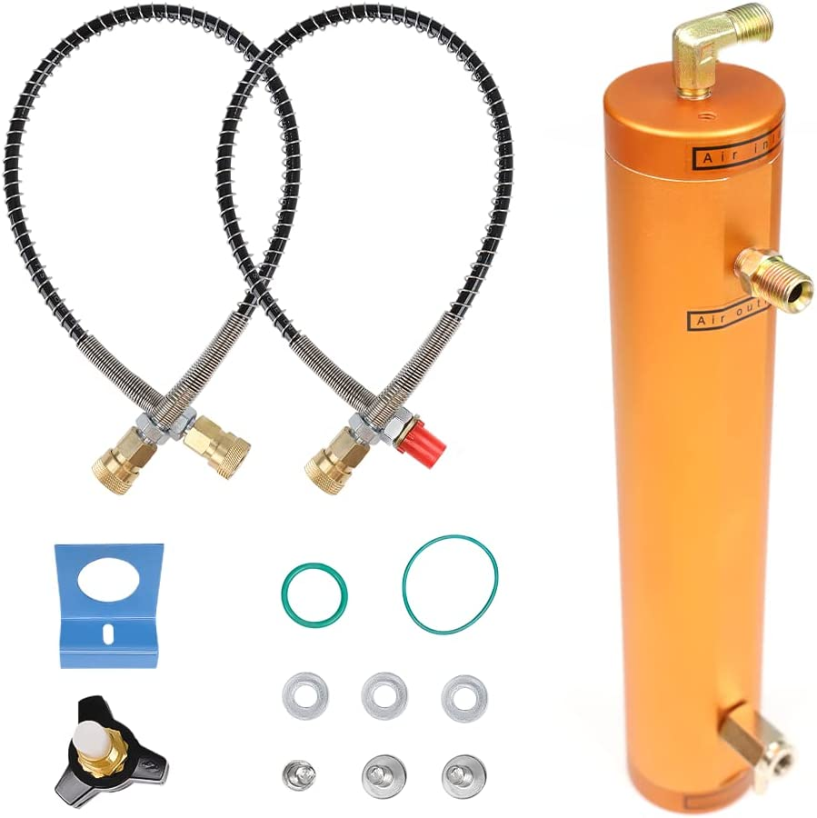

A good water trap is pretty much a requirement for the Yong Heng. I bought a huge double cylinder Tuxing setup but wish I had gotten the second one instead:
The external cotton filter / trap that comes with the Yong Heng it does a good job at removing "crud" from the air. The built in water trap gets rid of quite a bit of moisture as long as you give it a quick release every now and then while filling, but a final water trap seemed like a good idea for filling my tank and expensive guns.
If you want to be able to keep pressure in your final water trap / filter but still be able to remove the gun from the fill line and restart the compressor with no pressure load in the line, you will need a one way check valve on the compressor side of the big water trap / filter and a shutoff valve with a bleeder on it on the gun side of the water trap. If all you want to be able to do is shut down the compressor to let it cool and start it up again with no pressure on the compressor side, but to not disconnect the gun or tank, then all you would need is the one way check valve.

It is as easy as putting a male to male in to connect the hoses. But the stock YH filter may not get all the water out of the air. I bought a black filter about 8 inches long before getting a big gold Tuxing filter and have never installed the big one. I put color changing desicant into the black one and it takes about 6 tank refills for it to get wet. So I do not think the really big filter is necessary. I have the filters oriented so that the lines slope back to the YH, however, and vent every 5 minutes which removes a significant amount of water. After a tank fill the YH filter has significant water in it but the color changing beads will show very little change.
