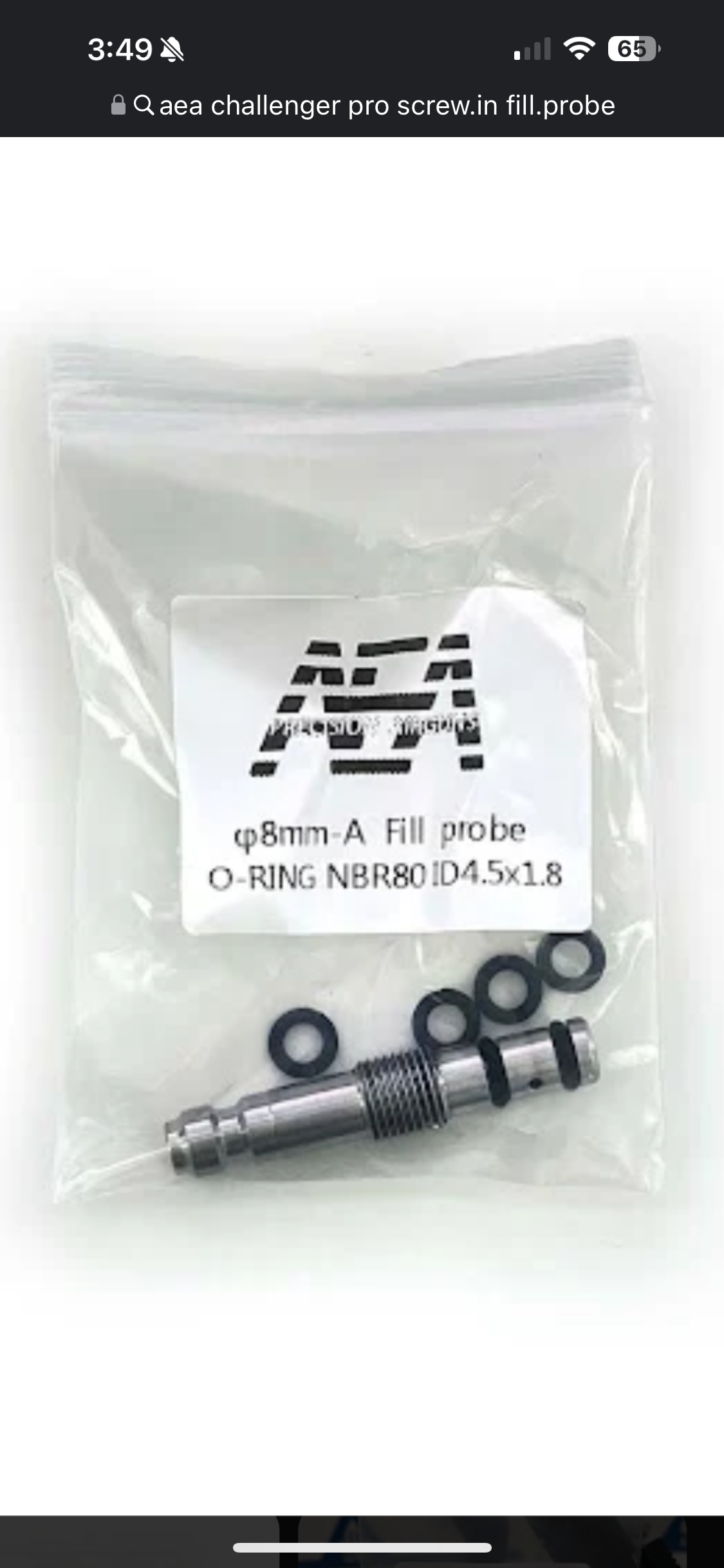

I am having a weird issue. I am filling my AEA Challenger with a bottle.. Gun fills fine.
Once full I shut off the bottle, vent the line but the hose won't come off the rifles fill probe. It comes off the bottle. After fifdling with it for a few minutes it finally popped off but a large burst of air came out, leading me to believe the reason it didn't come out was due to pressure locking it in.
Any ideas? Maybe bad check valve on fill probe? Or is something wrong in the rifle fill port?
Mike
Can you post a picture of the probe. Don't think I've heard of a "screw in probe" until your post. If you've truly bled off the air in the fill whip there has to be even a small pocket of pressurized air getting trapped in there somewhere. Hence, asking for picture(s).
