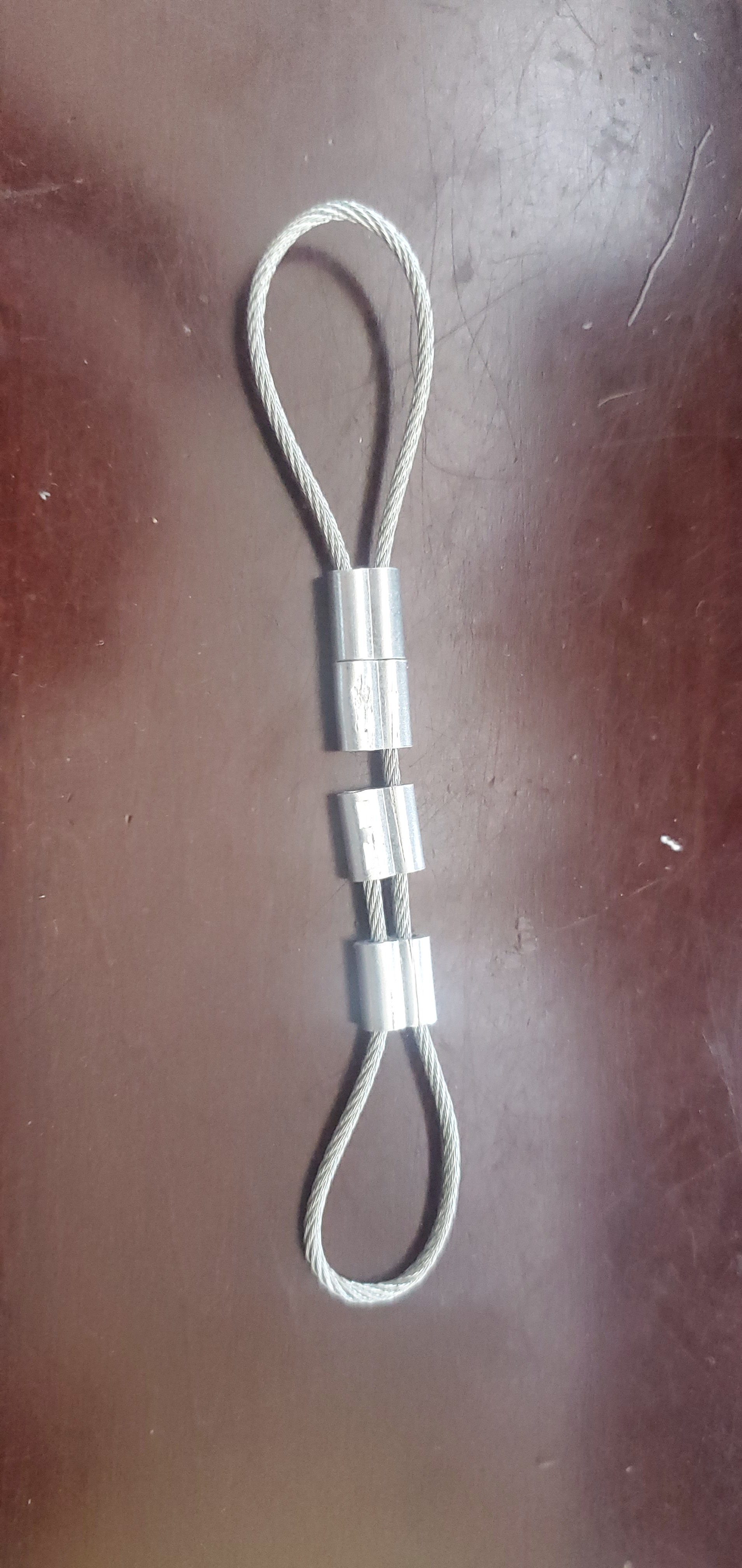

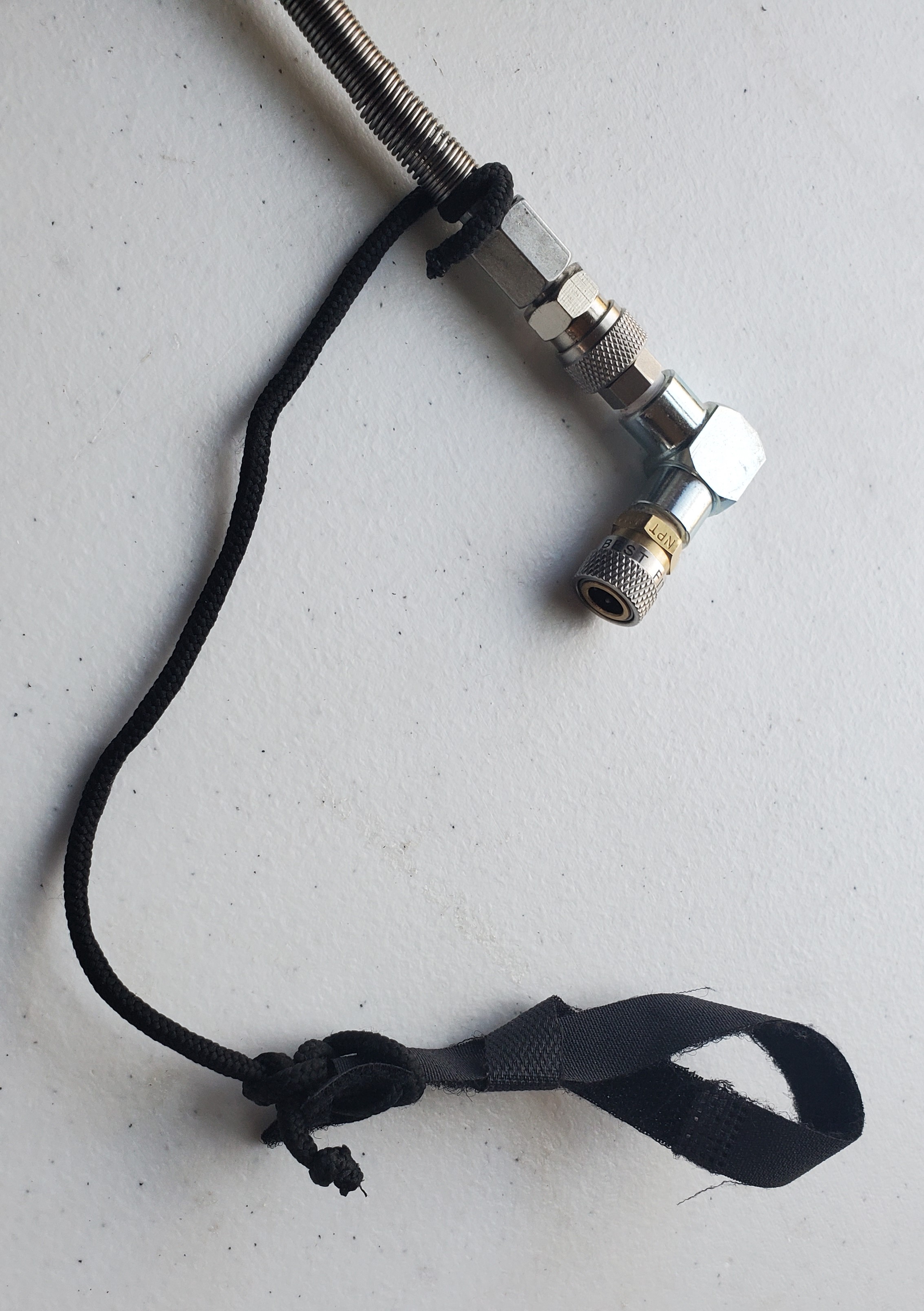

Lol, Exactly! Except I never really knew they existed! Or what they were called for that matter. So I'm not the only person who thought of making some type of restraint to tame or prevent a whip from happening. Originally this is what I used, just a small diameter made with a slip typ choker loop on each end just to hold onto the hose incase the connection broke.

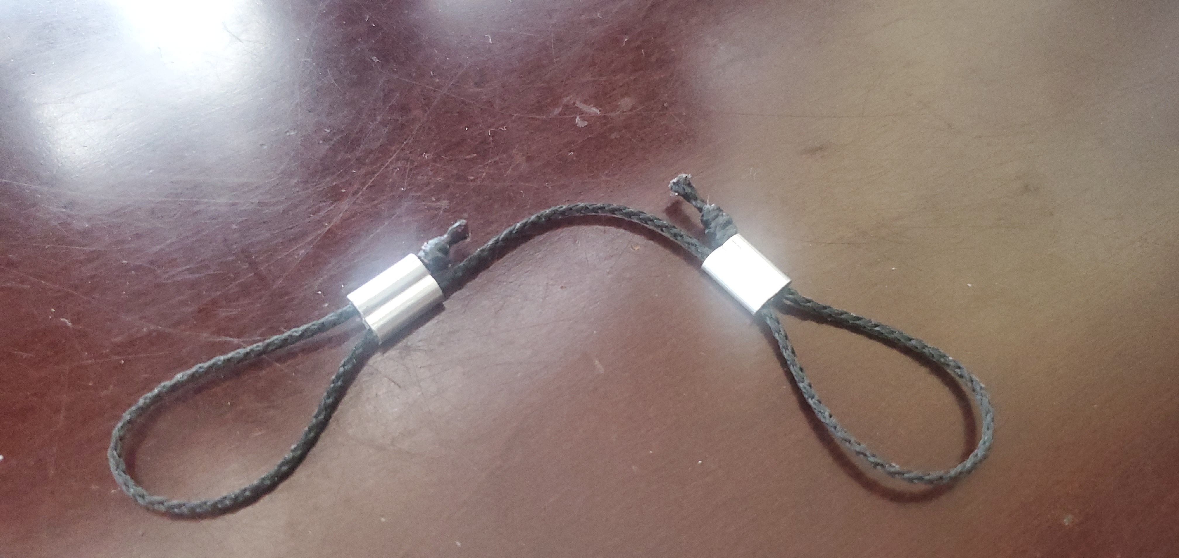

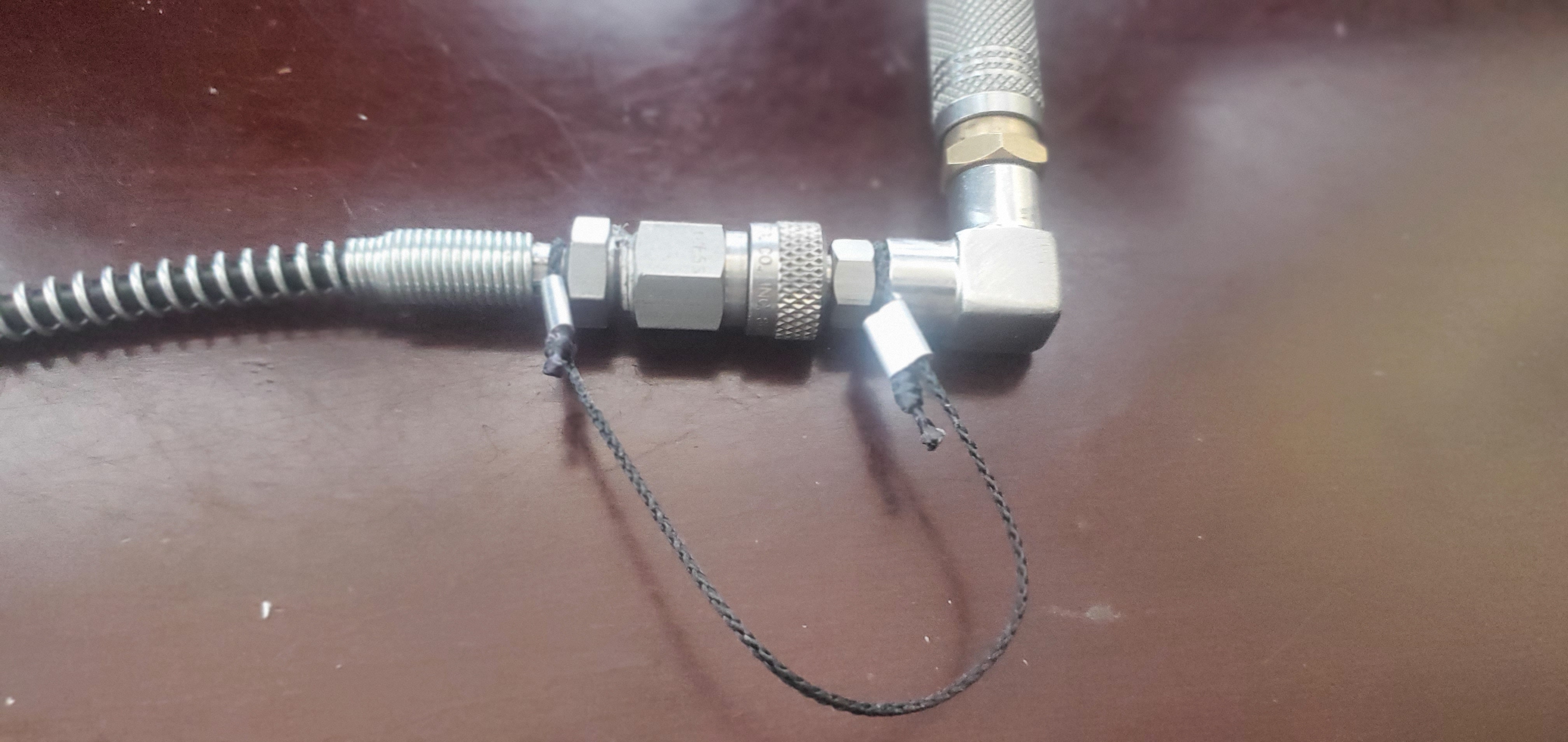

But then I was afraid that the cable itself would be abrasive and damage the area where the attachment points were. So I started making them out of Kevlar string. Which actually had more holding power than the wire cable.

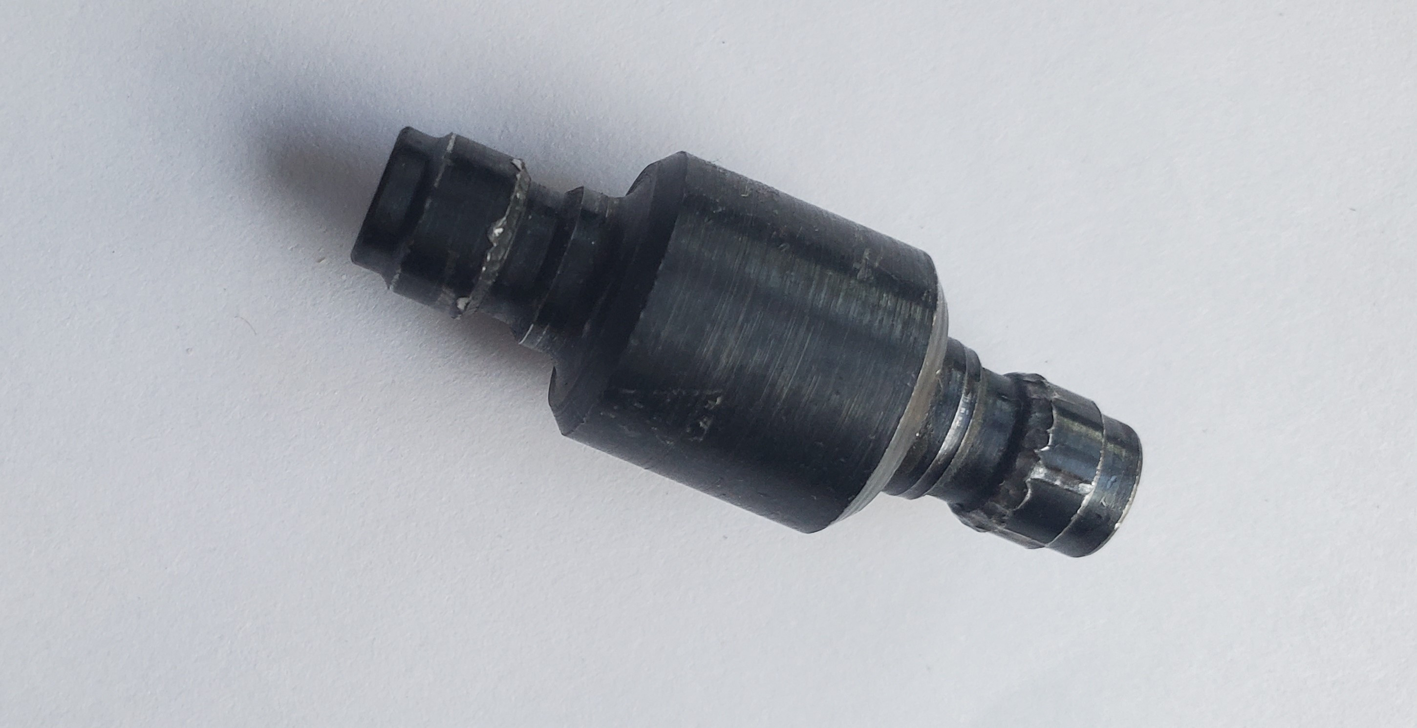

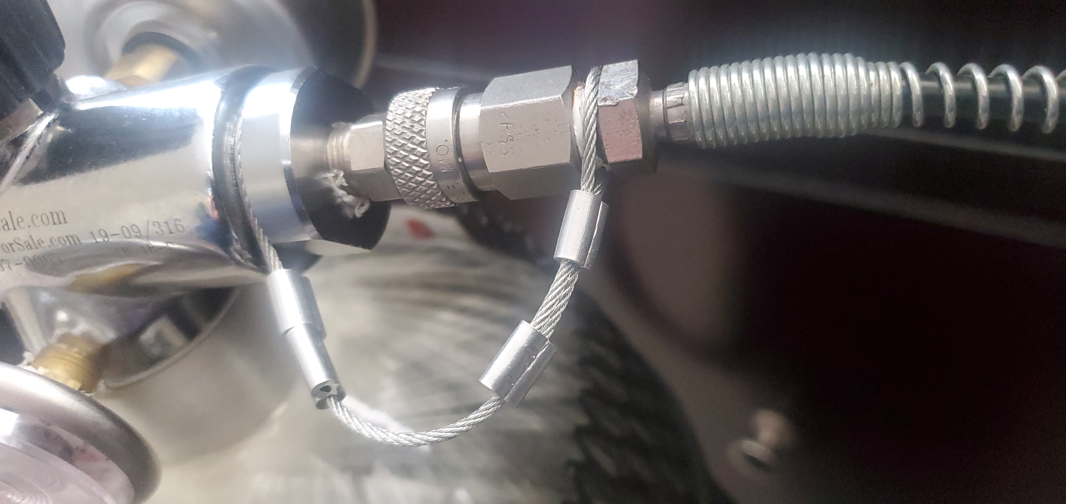

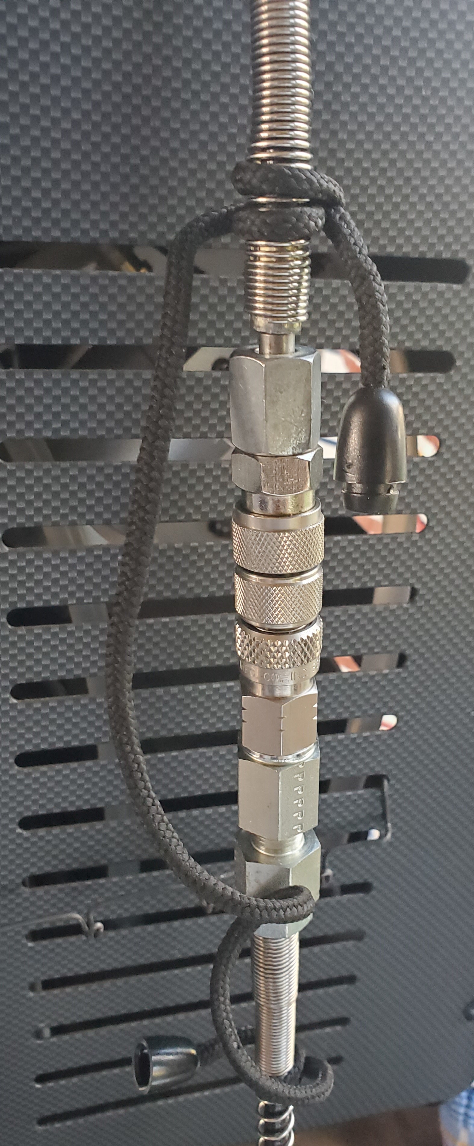

Back in the day I worked with pressurized hoses and lines, both high volume air up to 160 psi, and fluids up to 4500 psi. Two things that eventually became second nature are to assume that all lines are pressurized, and to use whip checks at EVERY connection not permanently hard piped. That practice served me well at work, and yesterday where I had 2 HPA disconnects within 5 minutes of each other, of coarse both at over 200 bar. The first disconnect was at a male to male connector where the fitting evidently deformed from use to the point it bypassed the quick-connect design. The other was most likely the result of the violent surge to the line which apparently affected the quick-connect at the end partially disconnecting it, but not obvious to the eye. So after replacing the failed male to male, I resumed filling. Both disconnects were controlled by the whip checks, so no property damage nor injury. Hopefully this will remind us to ensure that we have this safety measure in place at all times and regularly checked for adequate application to the potential risk.
The fitting that went bad.
Replaced with a quality Best Fittings connector. Note whip check.
The second disconnect occurred at the fill probe. Note the whip check on that end.
