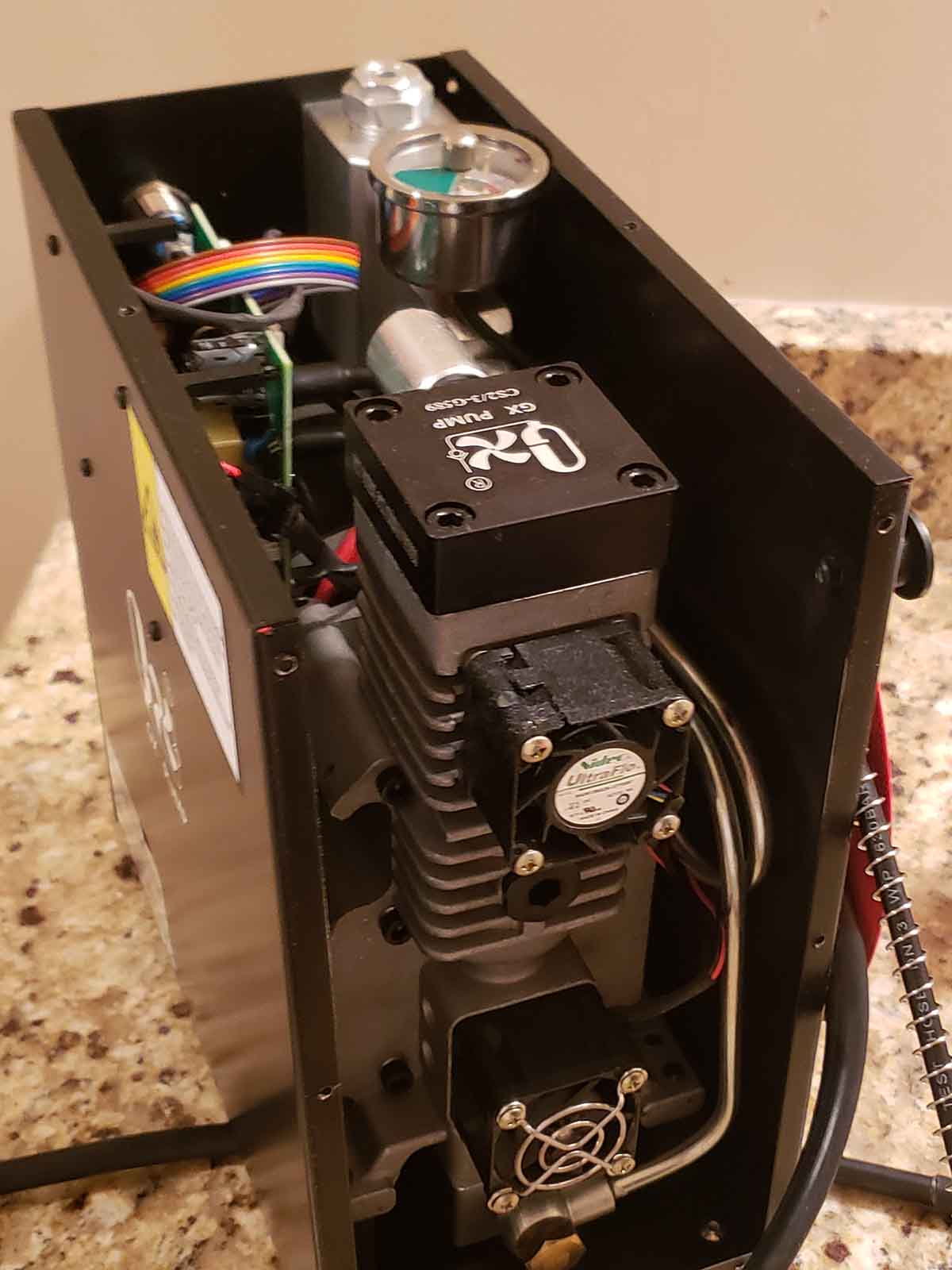

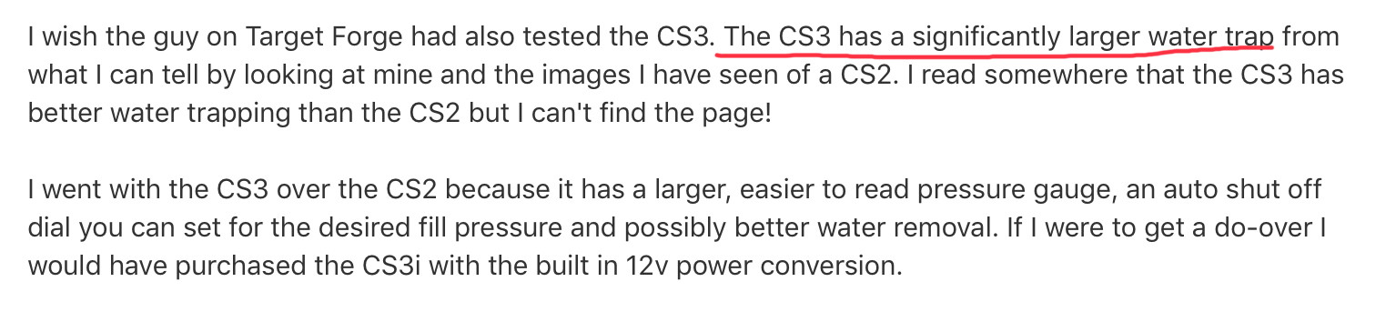

I wish the guy on Target Forge had also tested the CS3. The CS3 has a significantly larger water trap from what I can tell by looking at mine and the images I have seen of a CS2. I read somewhere that the CS3 has better water trapping than the CS2 but I can't find the page!
I went with the CS3 over the CS2 because it has a larger, easier to read pressure gauge, an auto shut off dial you can set for the desired fill pressure and possibly better water removal. If I were to get a do-over I would have purchased the CS3i with the built in 12v power conversion.
GX CS3 below
GX CS3 below
