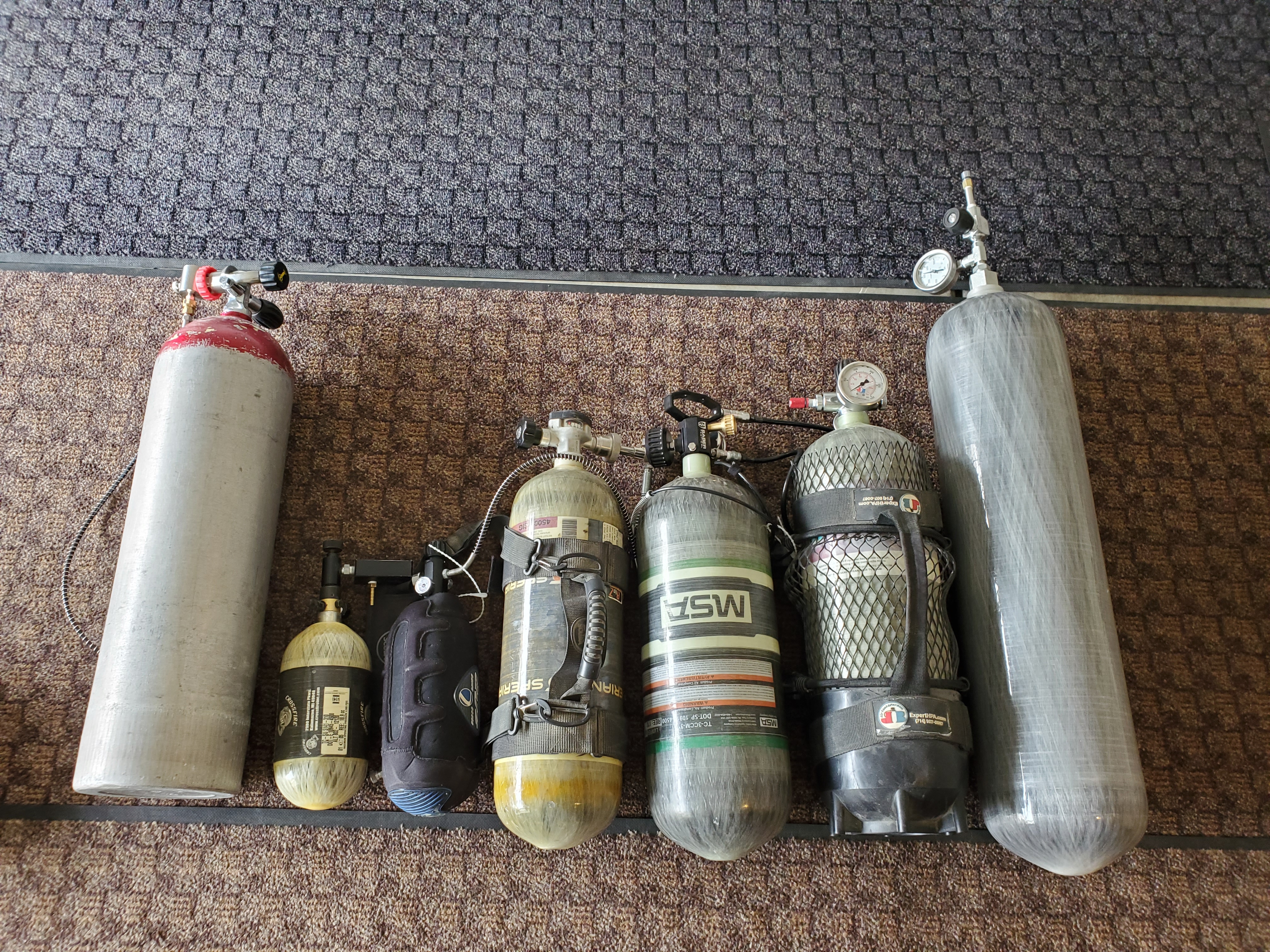

I've got a joe broncato valve, an scba Scott valve and a Saber valve. The Saber is a dead head setup and it's generally my favorite. I don't dead head check it at all because I fill after every use and have tons of air stored.
I like the Saber because the valve has its own carry handle and big easy to use knobs as well as an easy to read black guage face. I absolutely HATE transporting my Scott used fire scba and my Brancato great white horizontally in carry slings. I also dislike the valve in the Brancato the most, but it's got a safe flow rate restrictor and dual gauges.
The really big bottle is really light, but don't worry about that guy it's an airplane part.

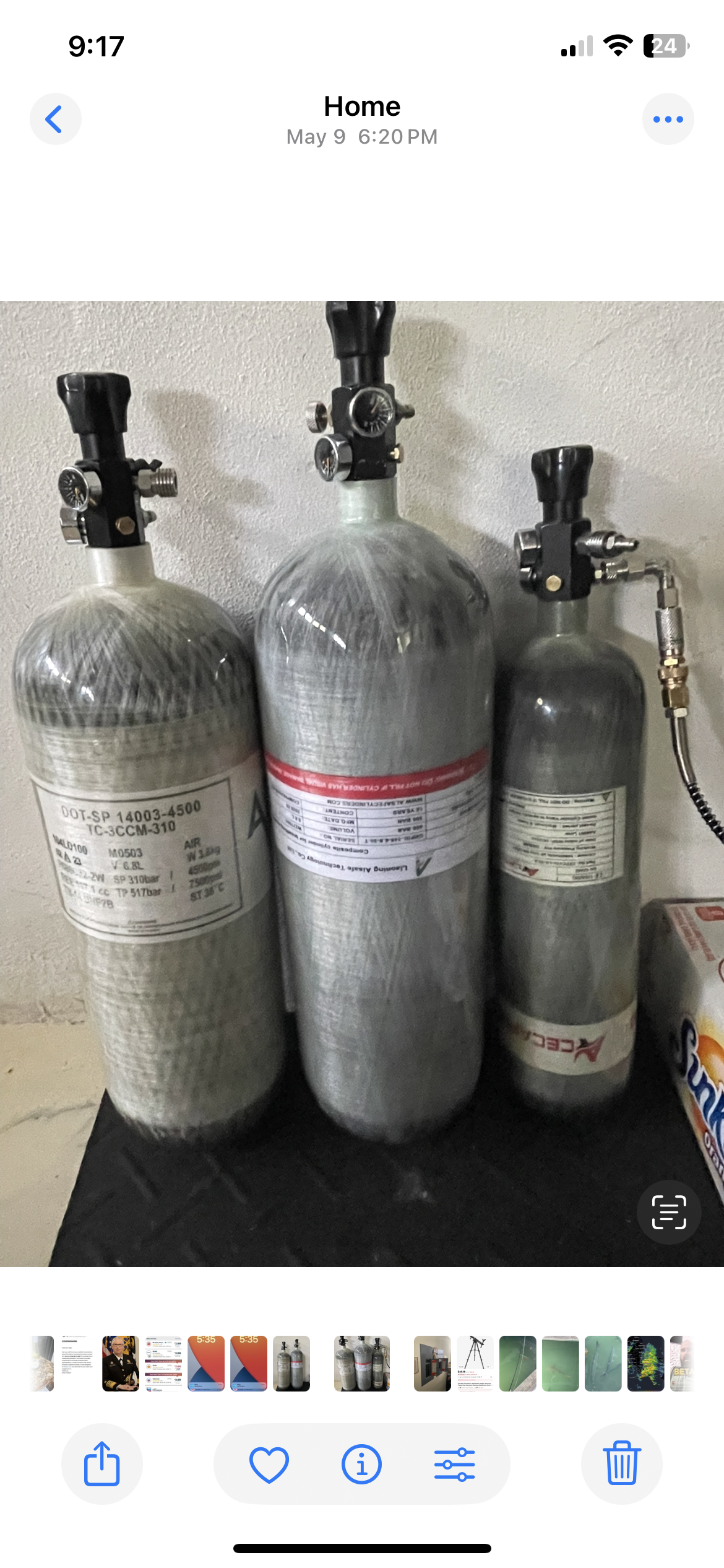

The valve on the third tank from the left looks very similar to the Tuxing valve in question. Does it have a direct to tank fill fitting? If so, is that fitting useful?

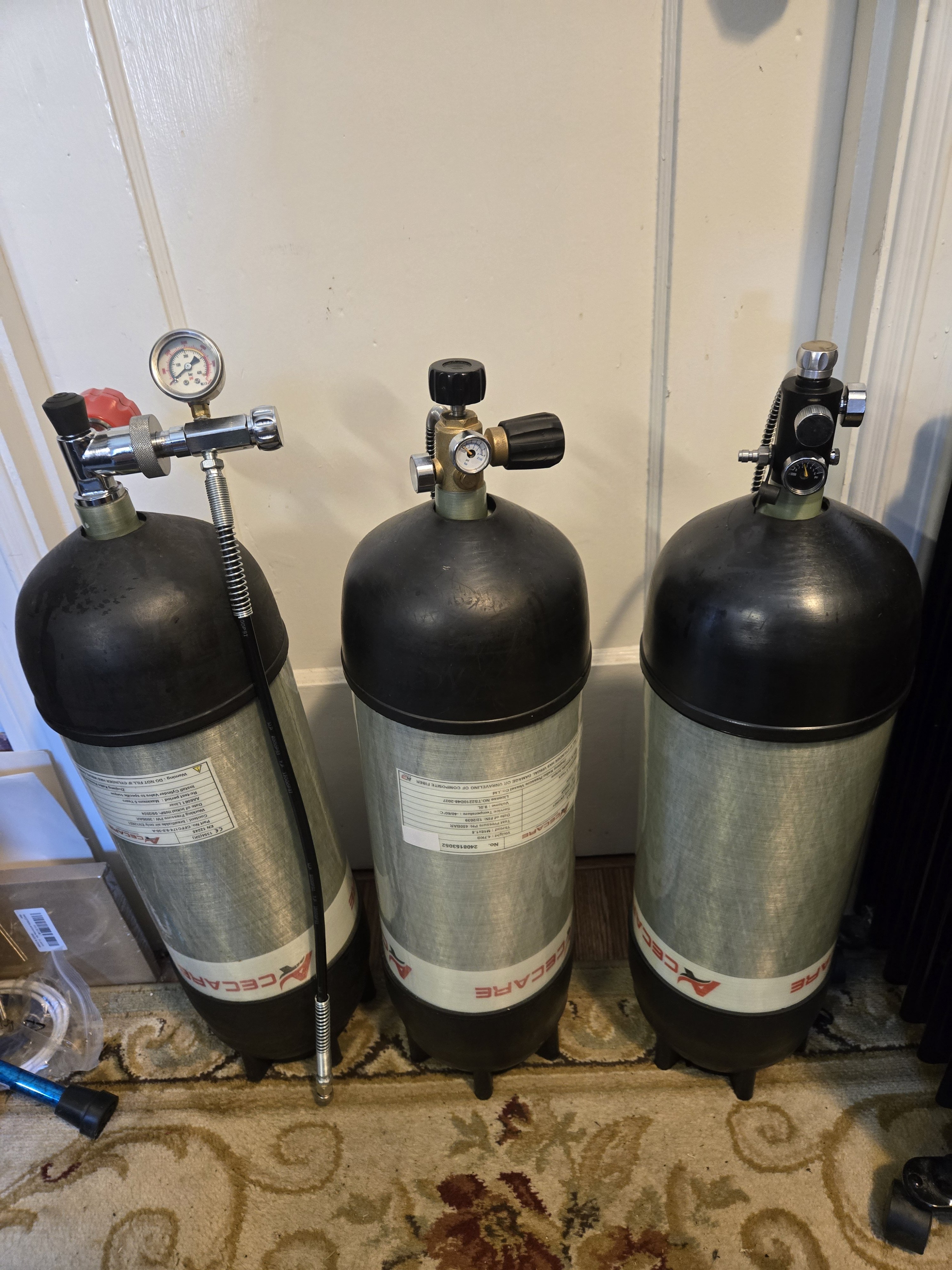

I have 3 types of fill valves.
Left: Dual gauge, fills through hose. Very high outlet volume air through the hose. Can adjust pressure, grossly, when filling from bottle.
Middle: Dual gauge, has fill nipple. Most restrictive outlet volume of air. On/off no adjusting pressure.
Right: Dual gauge, has fill nipple. Moderate outlet volume of air. On/off only.
I also have adjustable fill valve. I use them when tethered. Tanks filled to 300bar/4500psi. Have one set for 250 bar outlet pressure and one set for 200 bar outlet pressure. 250 bar for my regulated guns. 200 bar for my guns that are unregulated. No worries about over filling. You can use them as fill stations, just open the adjustment all the way and the outlet is tank pressure.

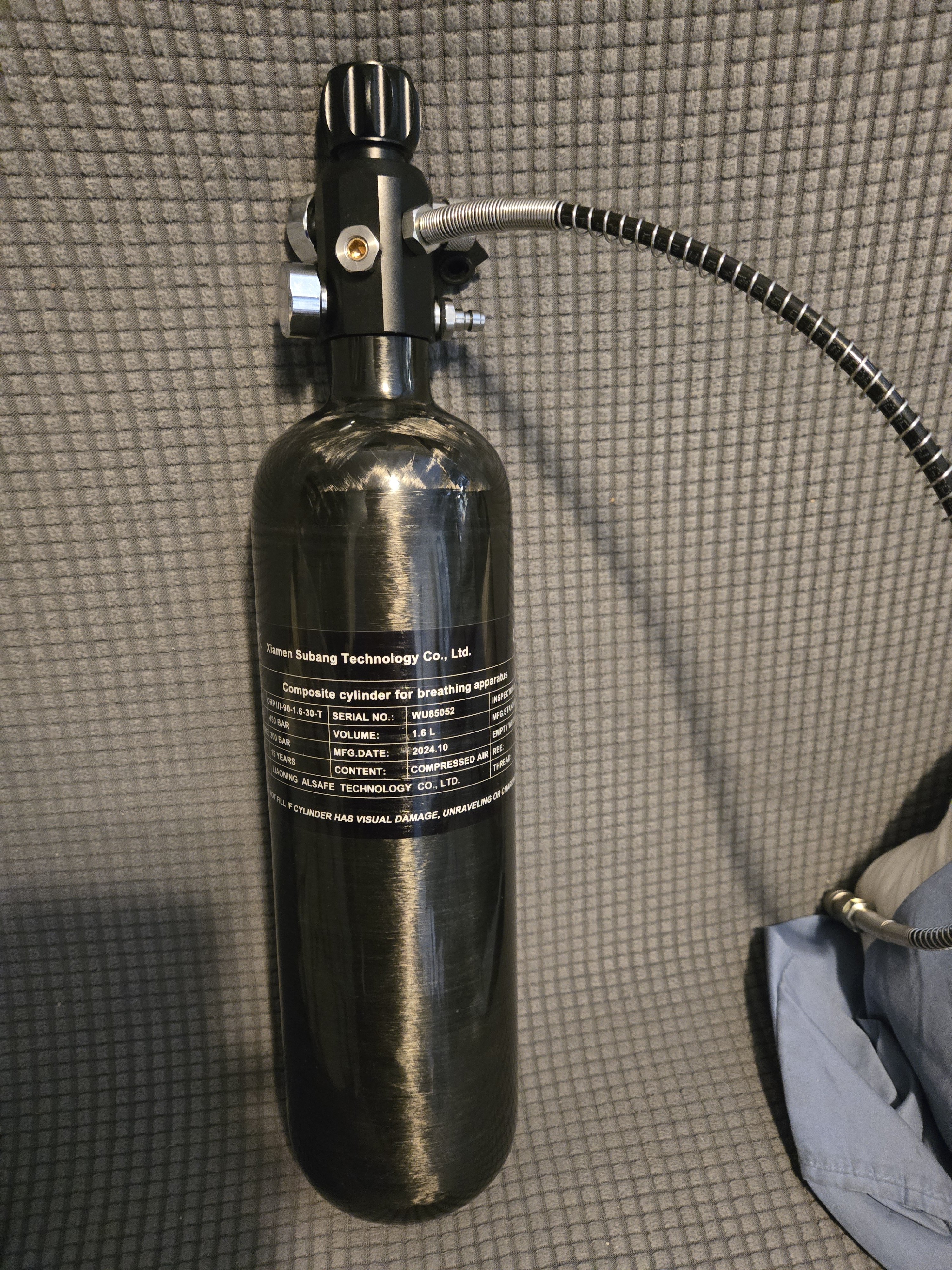

Just added a 1.6L tank for tethering because it only weighs around 3lbs with fill valve. A bit more when filled. Stick it in my backpack with an extension hose and I can shoot all day.
