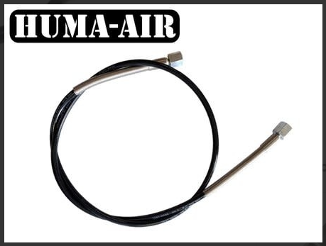

I've mostly been using these fill lines from Huma Air.
These fill lines have a loose connection between the hose and the attached female fastener. So I find I have to be a little careful when attaching quick-detach heads to these lines. In the gap between the hose and the fastener there's a little teflon washer. But if I don't attach the quick-detach component "just right" it will result in a little leak when pressurized.
The problem is I don't know what "just right" is. Sometimes I get it right, but I also get it wrong often-enough to question what I'm doing.
Any advice for attaching quick-detach components to the ends of these hoses, so that they reliably don't have any leaks?
I kind of wish the ends had male fasteners, so there was nothing loose and no teflon washer was required. Does anyone recommend other hoses?
