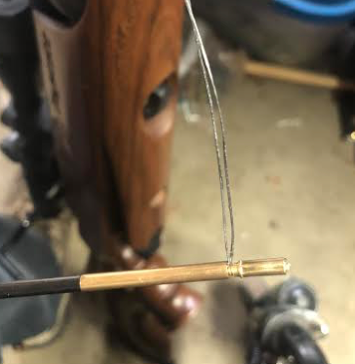

Then, it hit me. Use that little .177 patch holder to trap a loop of tiny string in the threaded end of the .177 rod and then use the rod like I'd planned to use the PatchWorm and pull a cloth cleaning patch up, out of the barrel. And it worked like a charm.
The following pic is of the string trapped inside the end of the cleaning rod. I just inserted the two ends of the loop of string into the rod and then trapped them inside by screwing in the patch holder. I had to cut most of the patch holder off so that the string would emerge and I could fish it out. To fish it out, I used a dental pick. I've used it several times now and the string has stayed put.
