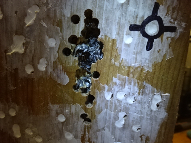

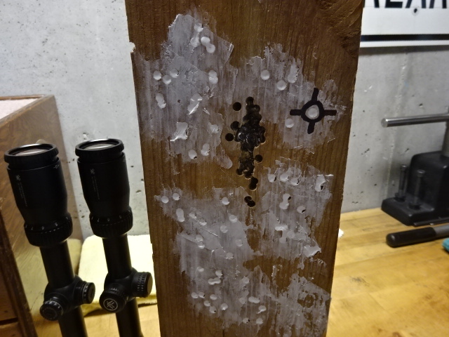

Taking advantage of absolute calm conditions early this morning I bench tested....(yes me bench shooting😉) the 80 / Leupold set up. I placed my 4" x 6" fir wood scrap at 50 yds. for a test.

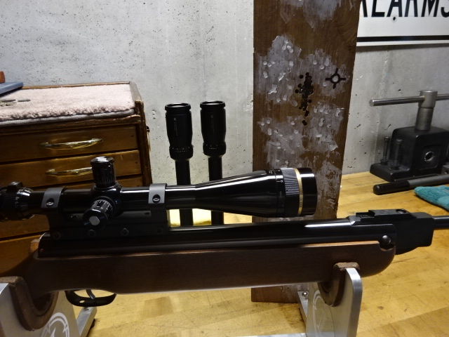

I did not touch the knobs from removing it from the Kimber. A shot at a small rock was very close. I chose a previous plugged hit and circled it for an aim point. Power was set to 14X. I went 50 carefully rested shots with out stopping. Pellets were H&N 5.54 14.66 gr. No question the Leupold is up to the task of holding adjustment on top of a strong spring gun. But for how long? I am not sure this scope will stay on it too long.
The 80 now has three tins, 1500 shots fired.
The Leupold was mechanically centered for windage while on the Kimber. I have the Leupold windage adjustable , two opposing lock down screws rear base. It was used to get the scope close to aim point. There is plenty of turret rotation both L R up and down. To place a scope on a different gun and actually be that close is amazing. I made no scope adjustments after mounting to the 80. The same goes for the Vortex scopes. Not even close to either knob maxed out in rotation. The NIB Vortex was only an inch off both directions at 25 yd. right out of the package.
The only "tuning" this 80 has is a new Vortek spring and Vortek seal.
The RWS rings have friction tape on both halves. No scope slipping happening at all.

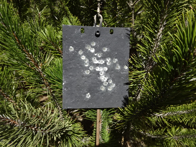

Meantime, I put the older high mileage (approaching 20K shots now) Vortex back on the 80. It was very close to the zero it had when taken off. I just put about 35 hits on this 5" x 6" aluminum plate standing offhand at 40 yards. Near calm conditions. All shots went to call, had a couple of wide shots that I blame on bad follow through. The scope showed no indications of losing zero point. Closing in on fours tins fired on the 80. I love this rifle so far.
I tightened up my shooting some after eating lunch. Same distance offhand, a little breezy. Scope zero stayed put. (don't look at the edge hits.)

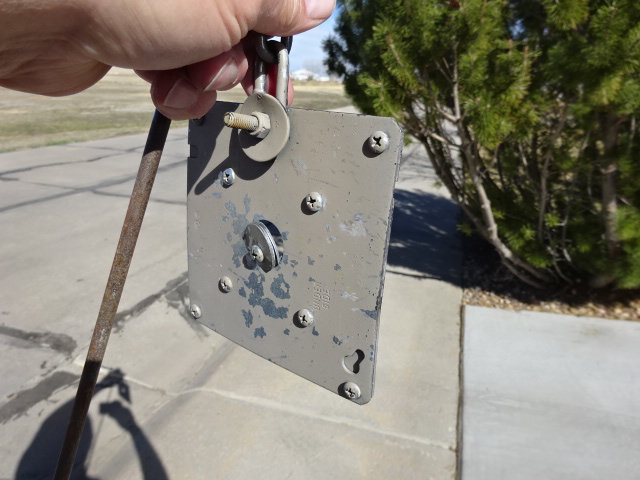

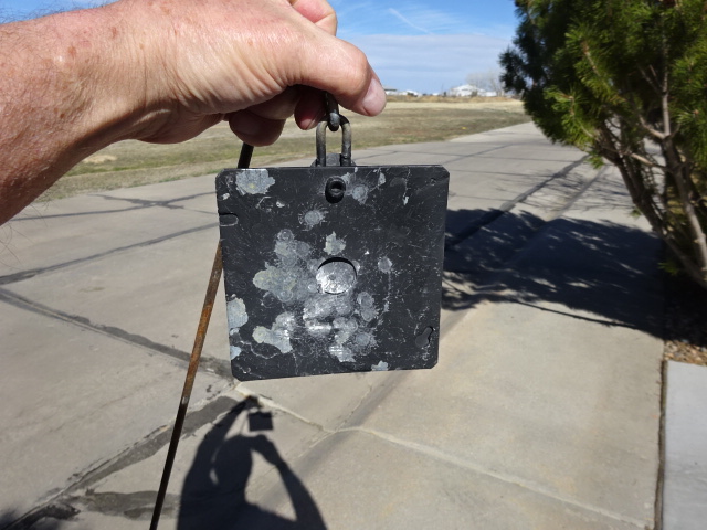

Visiting the family in the SW again this week. Of course the 80 and two tins came with me. On Sunday me and my son in law were doing complete pass throughs on 16 oz water filled beer cans at 138 yards. They left full depth head dents in a chunk of 2 x 10 fir directly behind the cans. Gallon plastic milk jugs filled with water stop them from passing through. Easy to hear a dull thump when hit. You have time for another two hits before the water
all leaks out. Forgot to bring the camera with me. That brake grease is sticking really well and the 80 remains buzz free after 600 shots. No issues with the Vortex holding zeroes, either. Got the 10" aluminum fry pan hanging at 138 yd. and can't hardly miss it. A nice clank with every hit.
