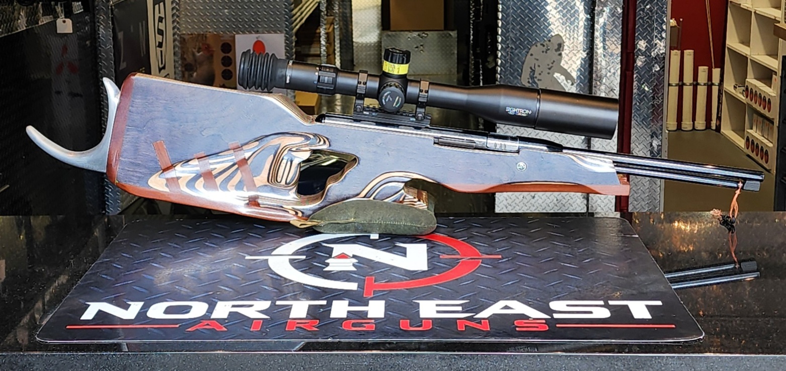

  1. Gun one is a Browning Leverage with a 4-12 UTG scope. It is tuned by the spring and trigger work. It shoots 8.4 @850 fps

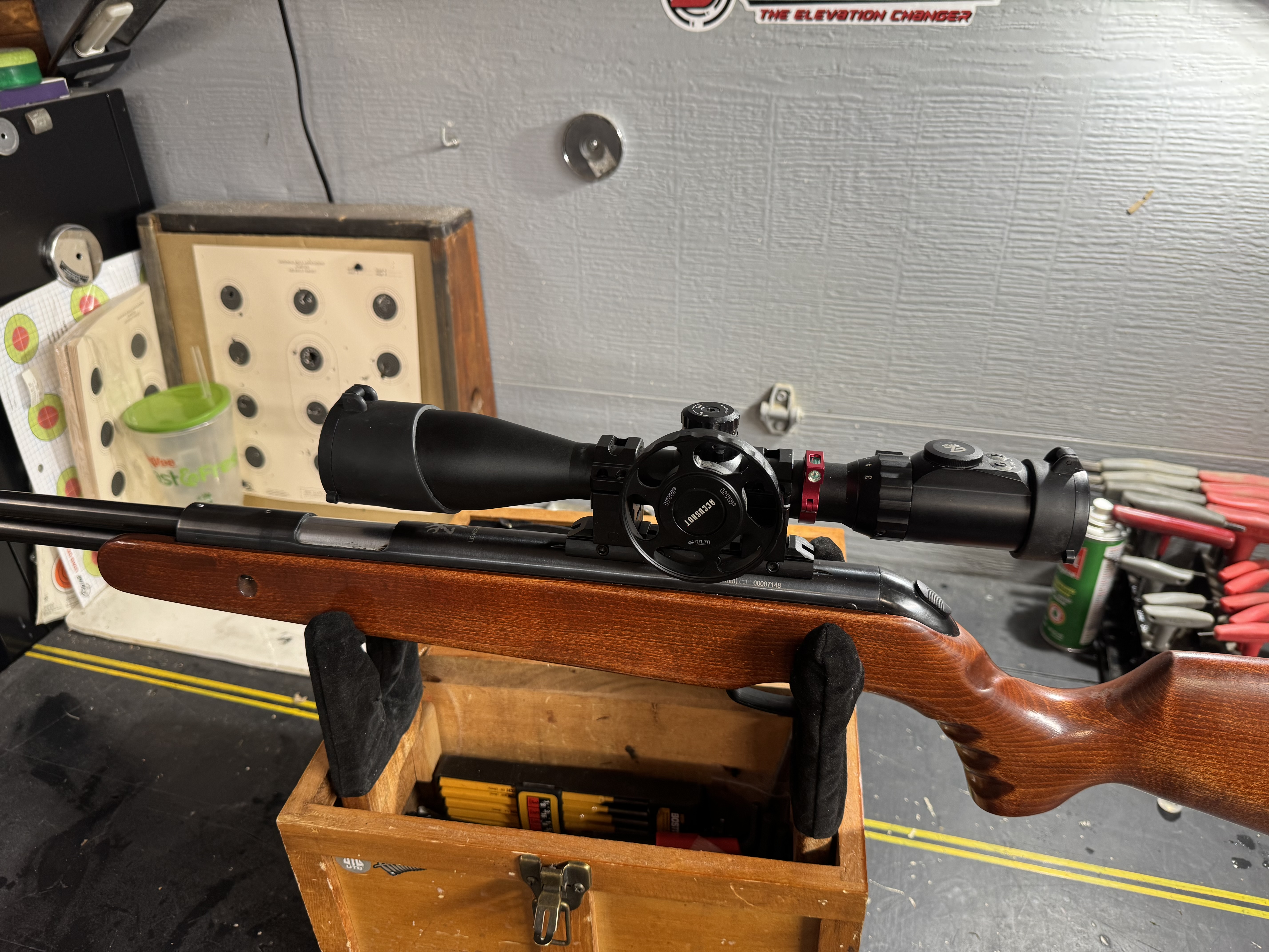

  2. Gun two is a Diana 48 tuned to 18 ft lb with a 6-16 UTG scope shooting 8.4 @ 900 fps
  3. Gun three is a TX200mk III with a 5.5-25 scope shooting 8.4 @ 800 fps . This is a 12 ft lb gun

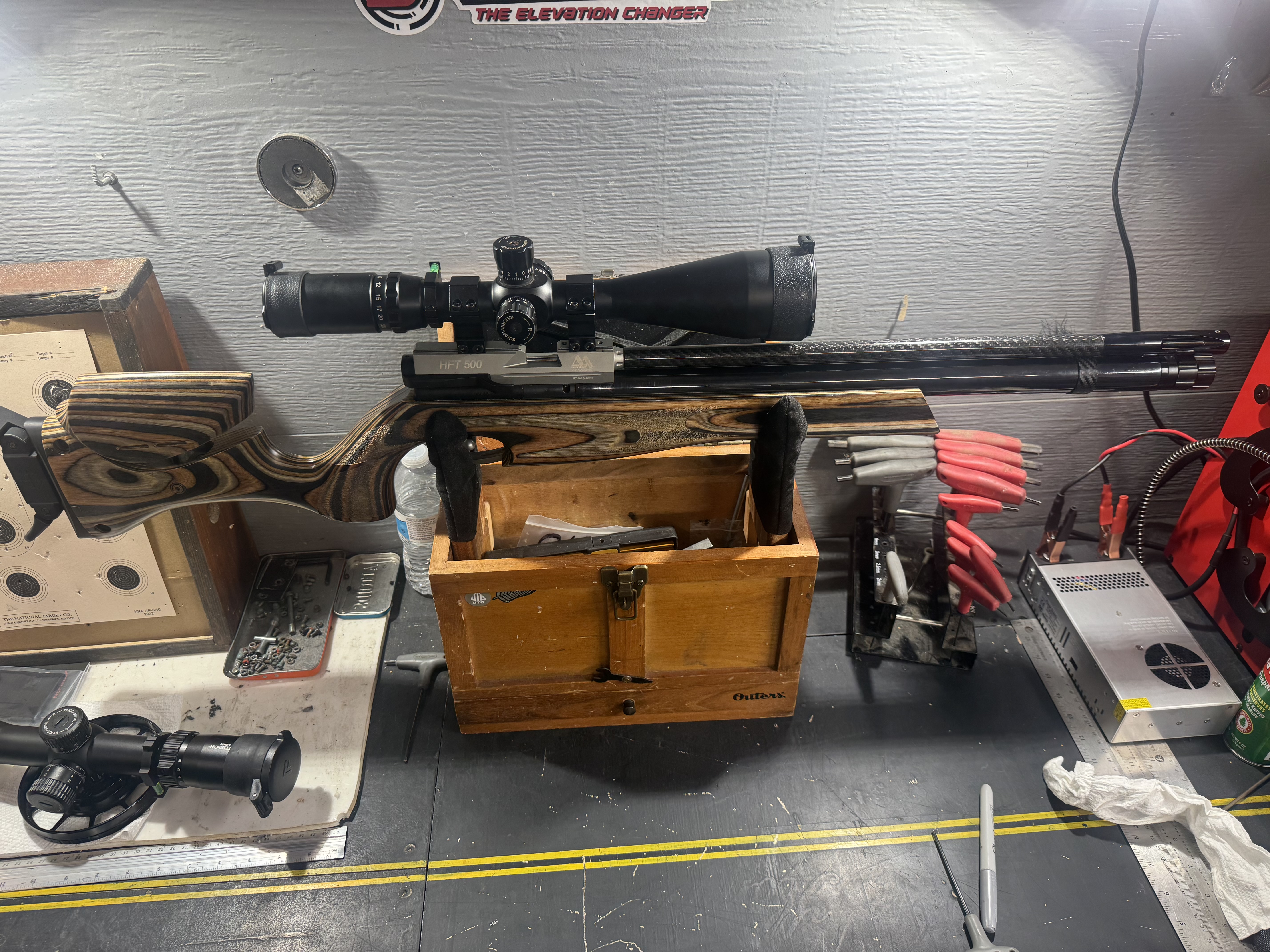

  4. Gun four is an HFT-500 that is highly modified by a professional and shot in competition by a professional. It is temporarily fitted with a 10-40x56 scope and is shooting 10.3 @850 FPS

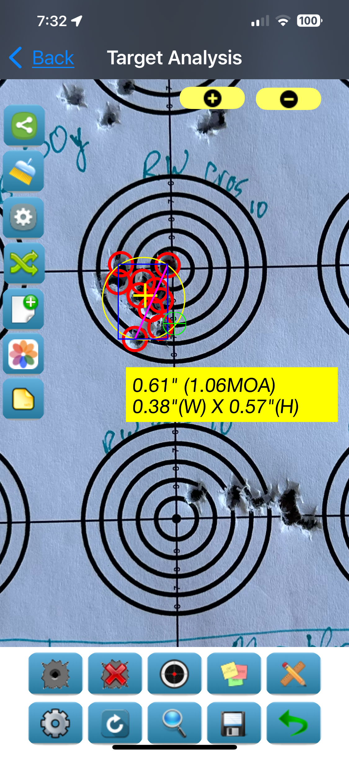

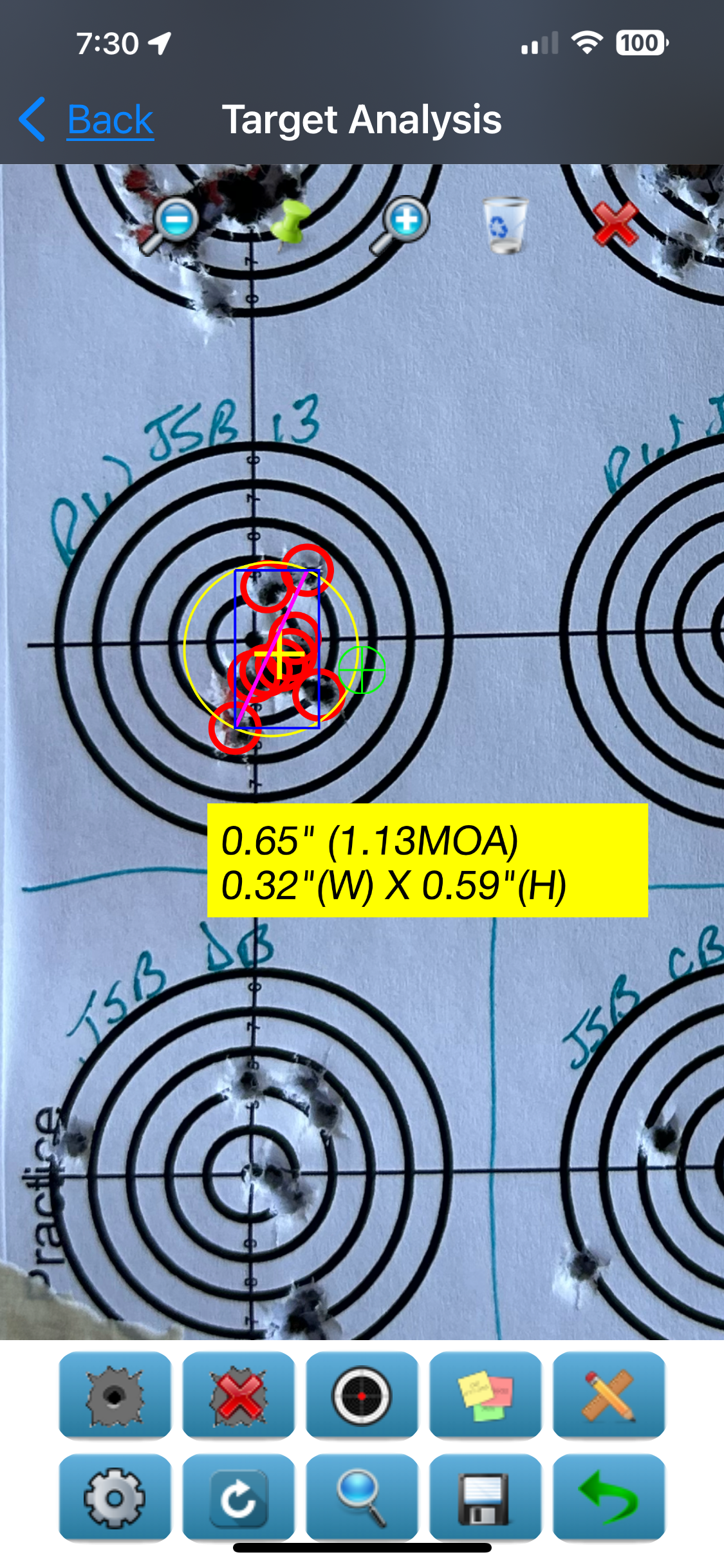

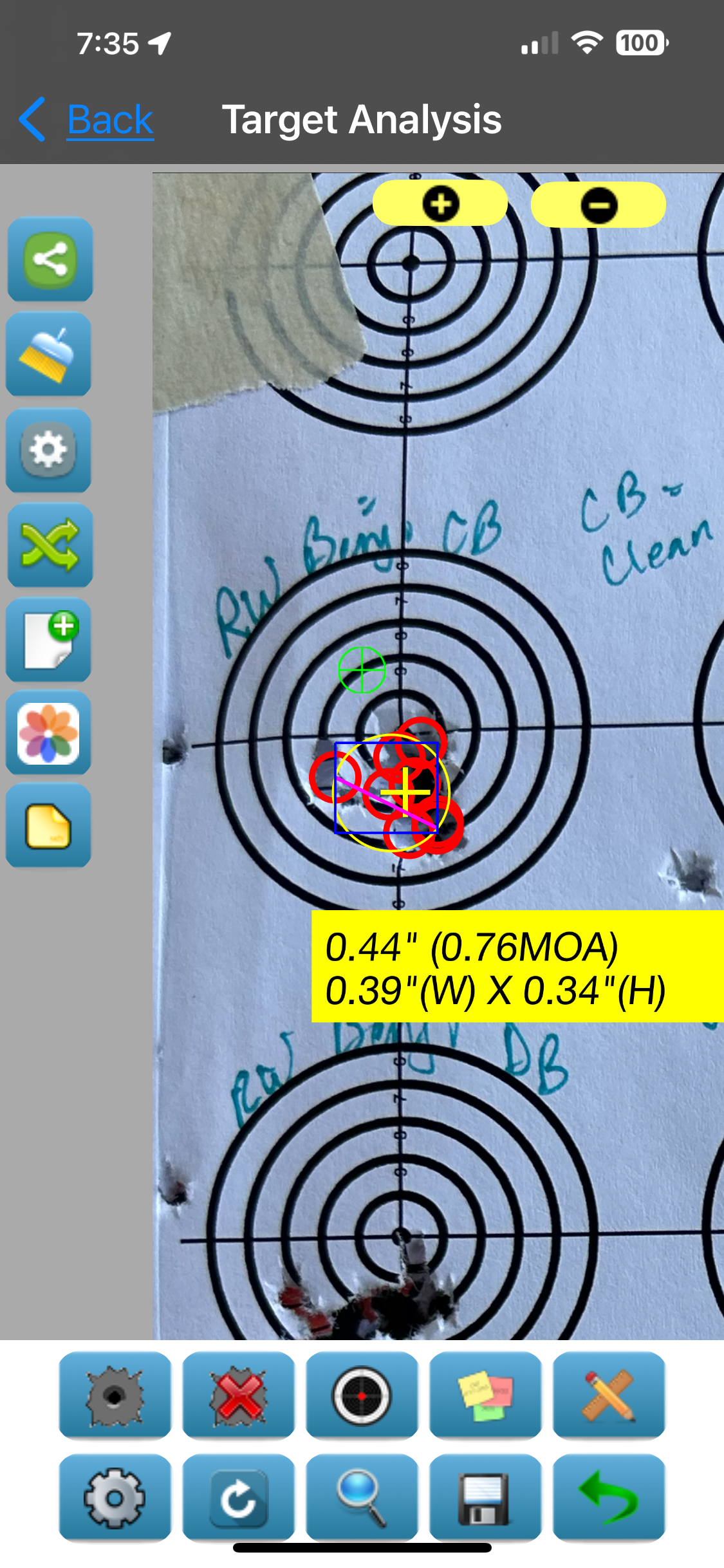

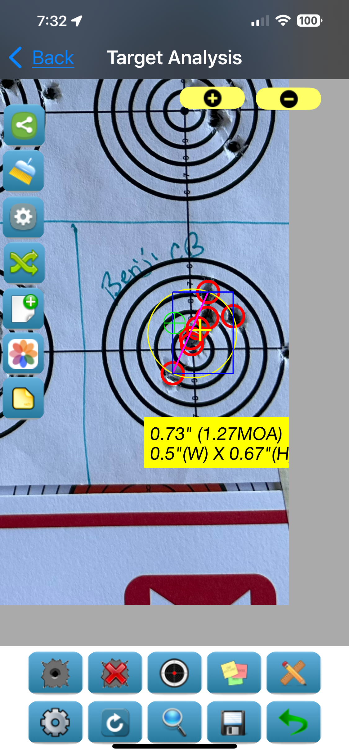

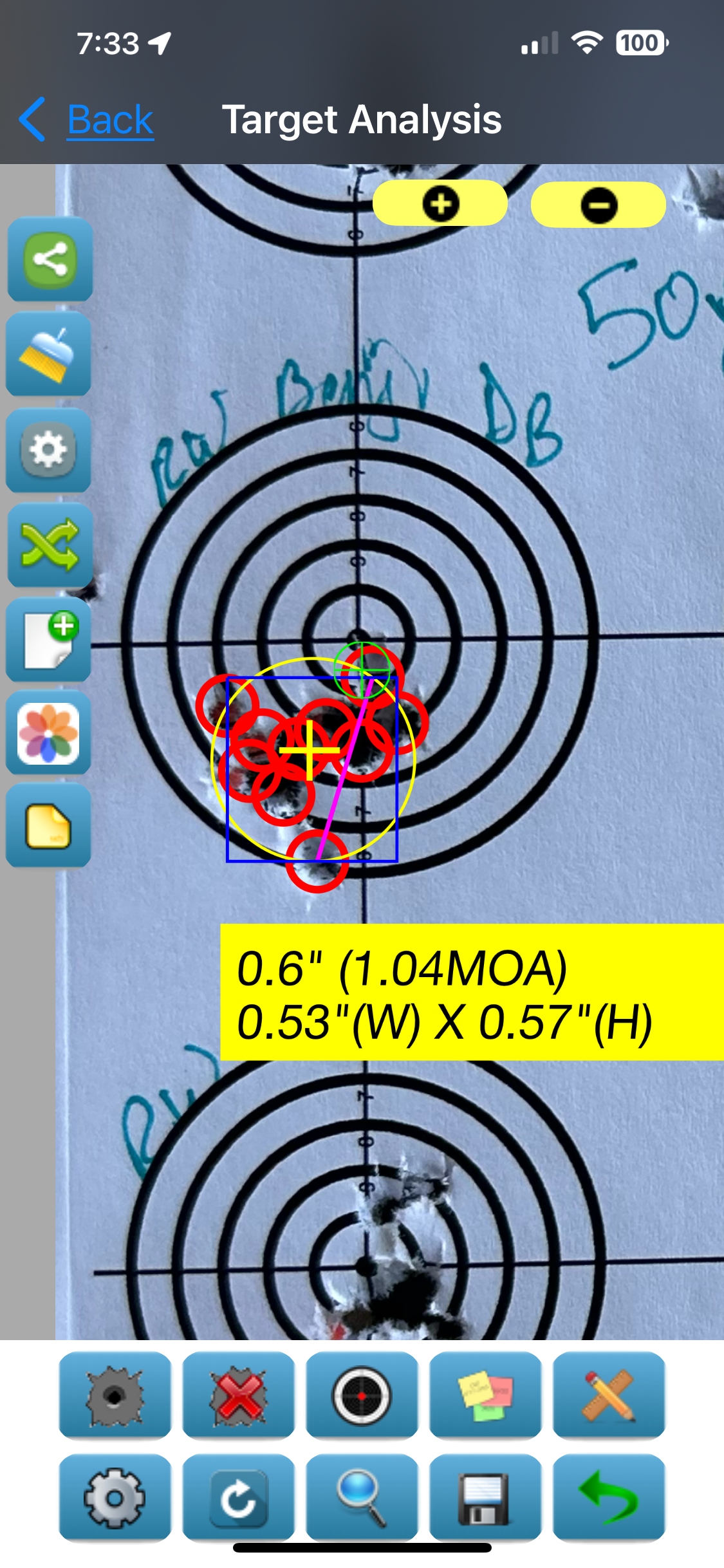

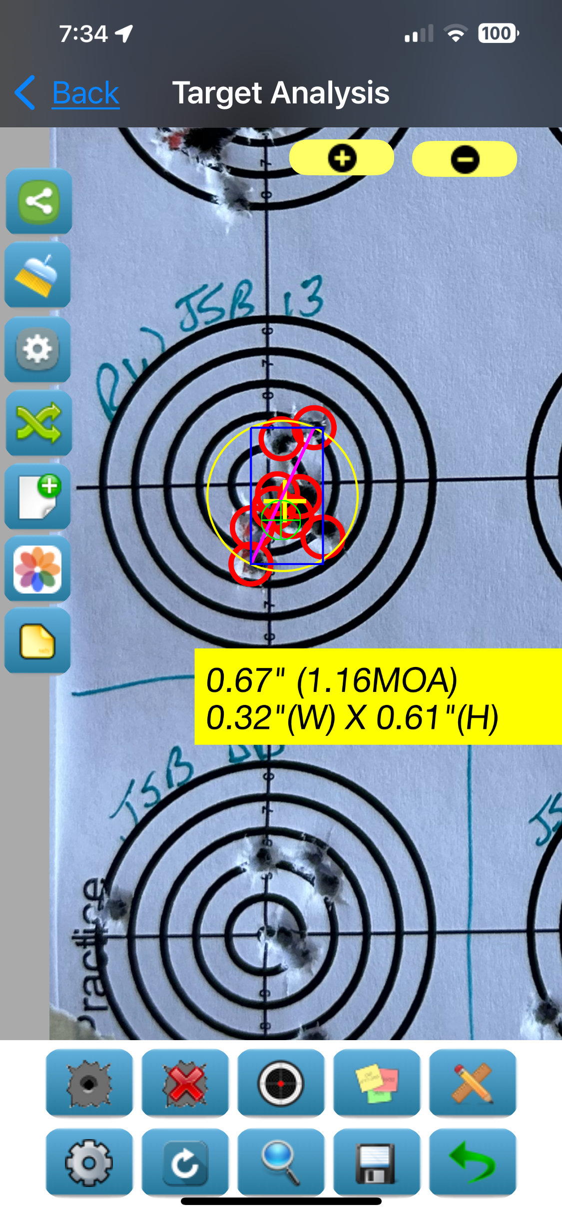

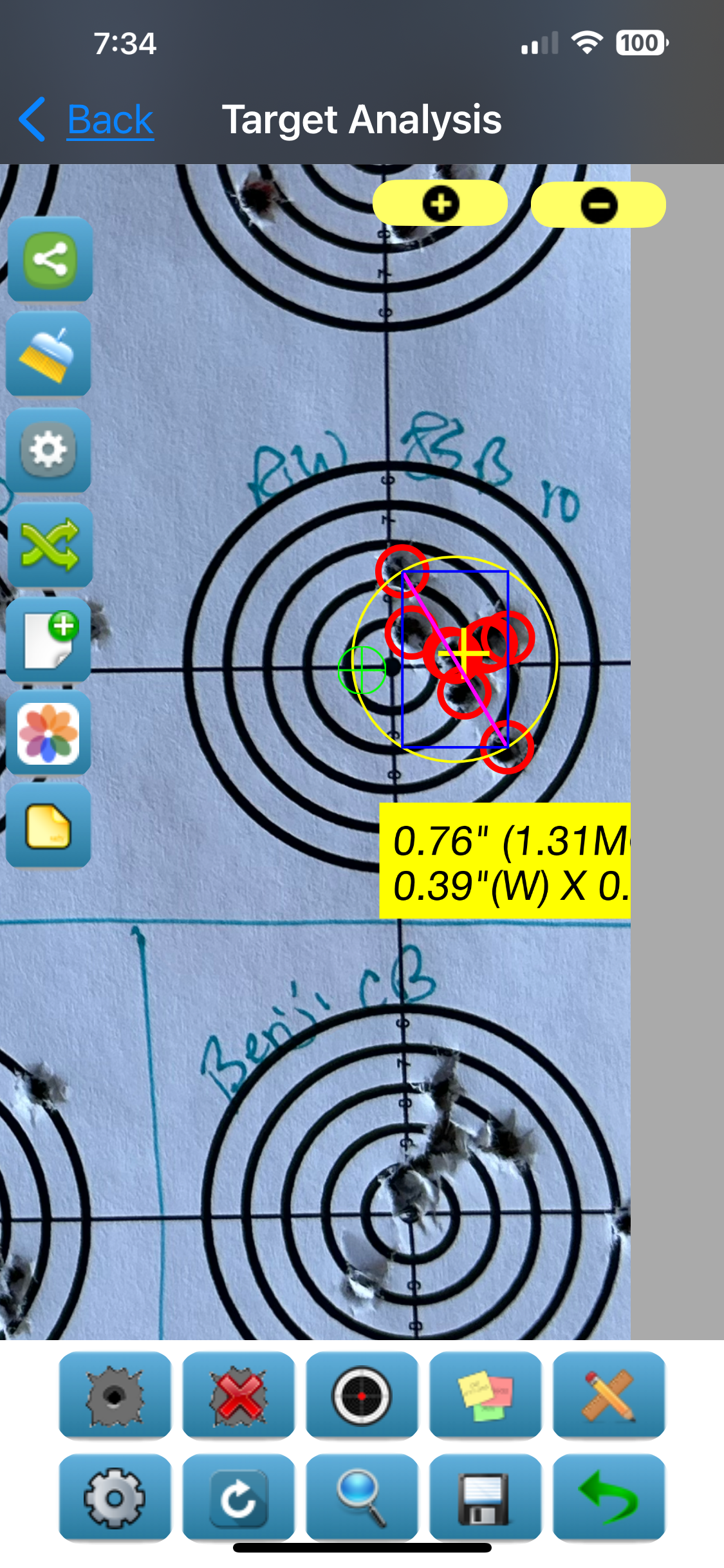

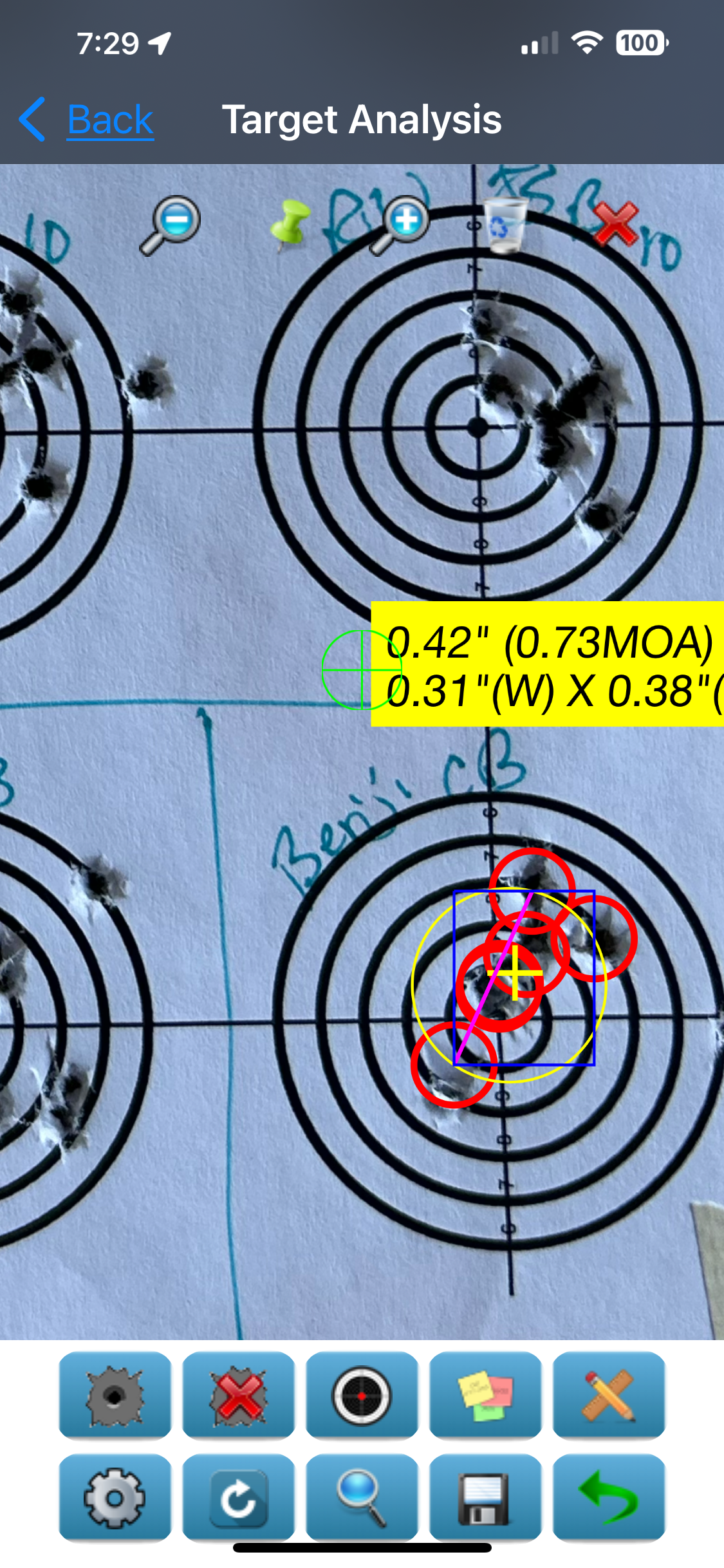

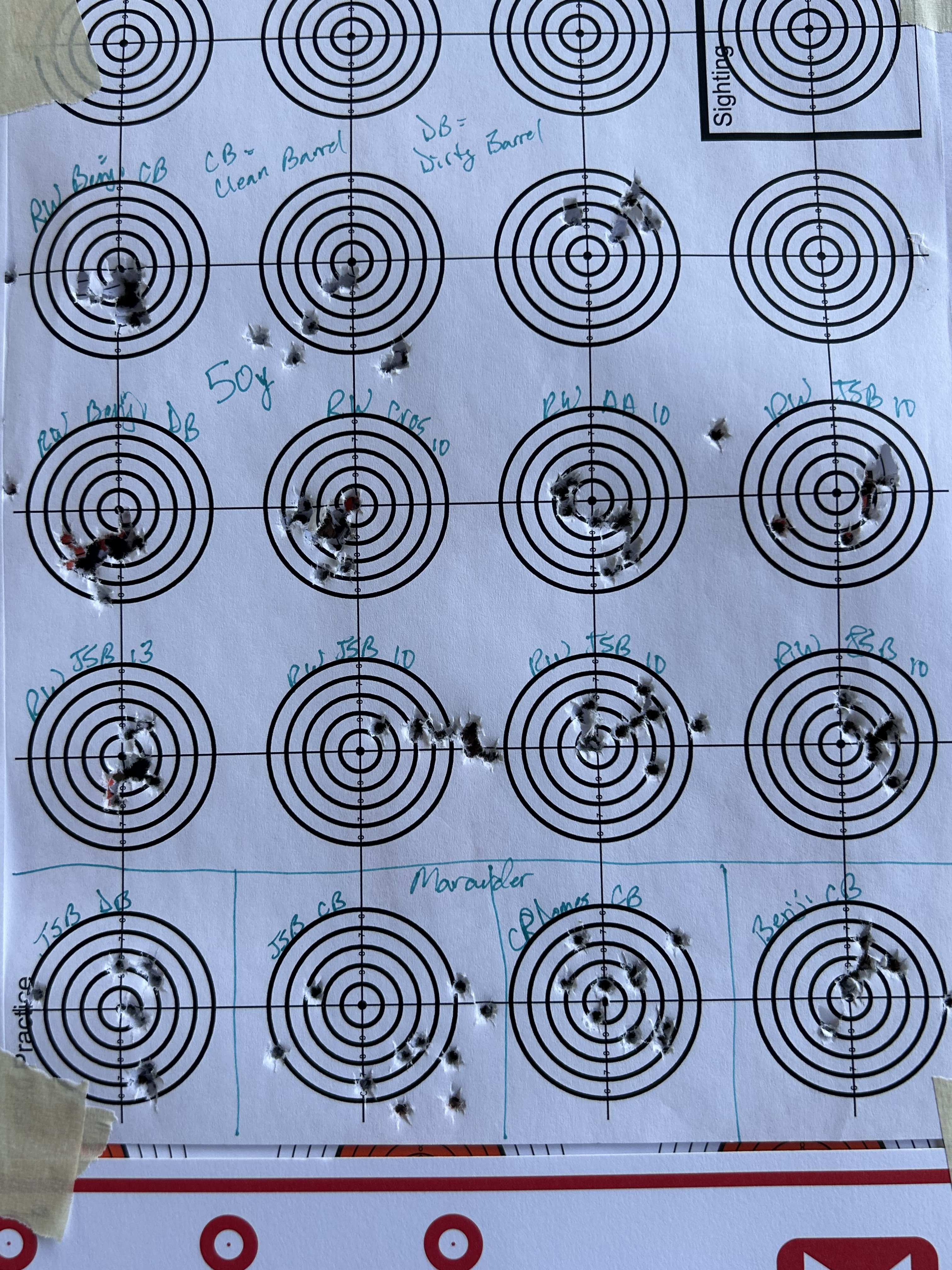

Ok, here is some info I did last night shooting a lower end gun and a high end gun (which may be for sale).
First gun is a Marauder with a LW barrel and a Hawke Sidewinder SFP Scope. Retail is about $1300 combined.
Second gun is a Daystate RedWolf and a Hawke Sidewinder scope. Retail is about $3700.
Here is the main target sheet. Shot at 50yds since thats what is available to me from a bench. Had some times of very light wind. Some groups I waited while others I didn't.
The marauder is on the lower portion and the RW on the upper portions.
The best groups from the Marauder were Benjamin 10.5gr on a cleaned barrel and measured about 3/4". The RW was also the Benjis and JSB 13RD at 3/4" with JSB 10,3gr about the same. Seems to be about the best I can do with these guns. I have others that are more accurate at times. Surprisingly the cheapest pellets hung closely behind being the Crosman Premiers 10.5gr in the RW and the Marauder. The best group of the session was a 12fpe RW group with QYS at .16" at 50yds. Guess the RW only likes lower power! Now if I can just figure out how to get it to shoot like that on higher power id be happy.
Marauder Benjis (870fps) - .73"
RW Benjis (890fps) - .6" Dirty Barrel and 925fps .46" Clean Barrel - liked pushing them faster but still feel its not tight enough.
RW Crosman Premiers (890ish fps) - .61"
RW 13gr RD (815fps) - .65"
RW 8gr QYS 810fps - .16"
I may test indoors next and can do 55yds for only the RW. For the money, I am NOT happy with this gun. Maybe my expectations are too high?

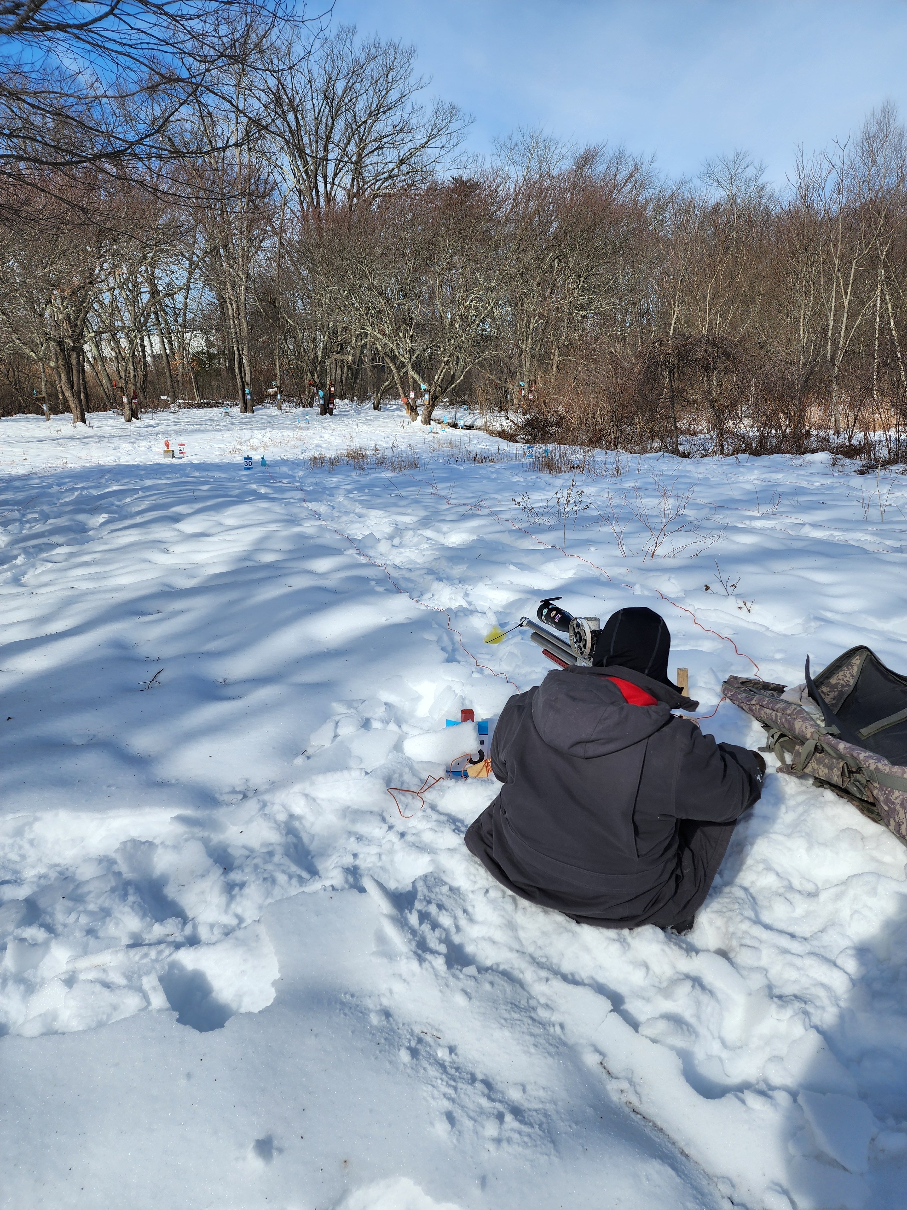

I mark my parallax wheel with numbers. And I use a silver sharpie to pinpoint the distance. I plan to shoot deep into winter. We get -10 . I’m gonna use a gold sharpie at below 32 deg and silver sharpie up to 100 deg.
I have a thermometer on my shooting tote.

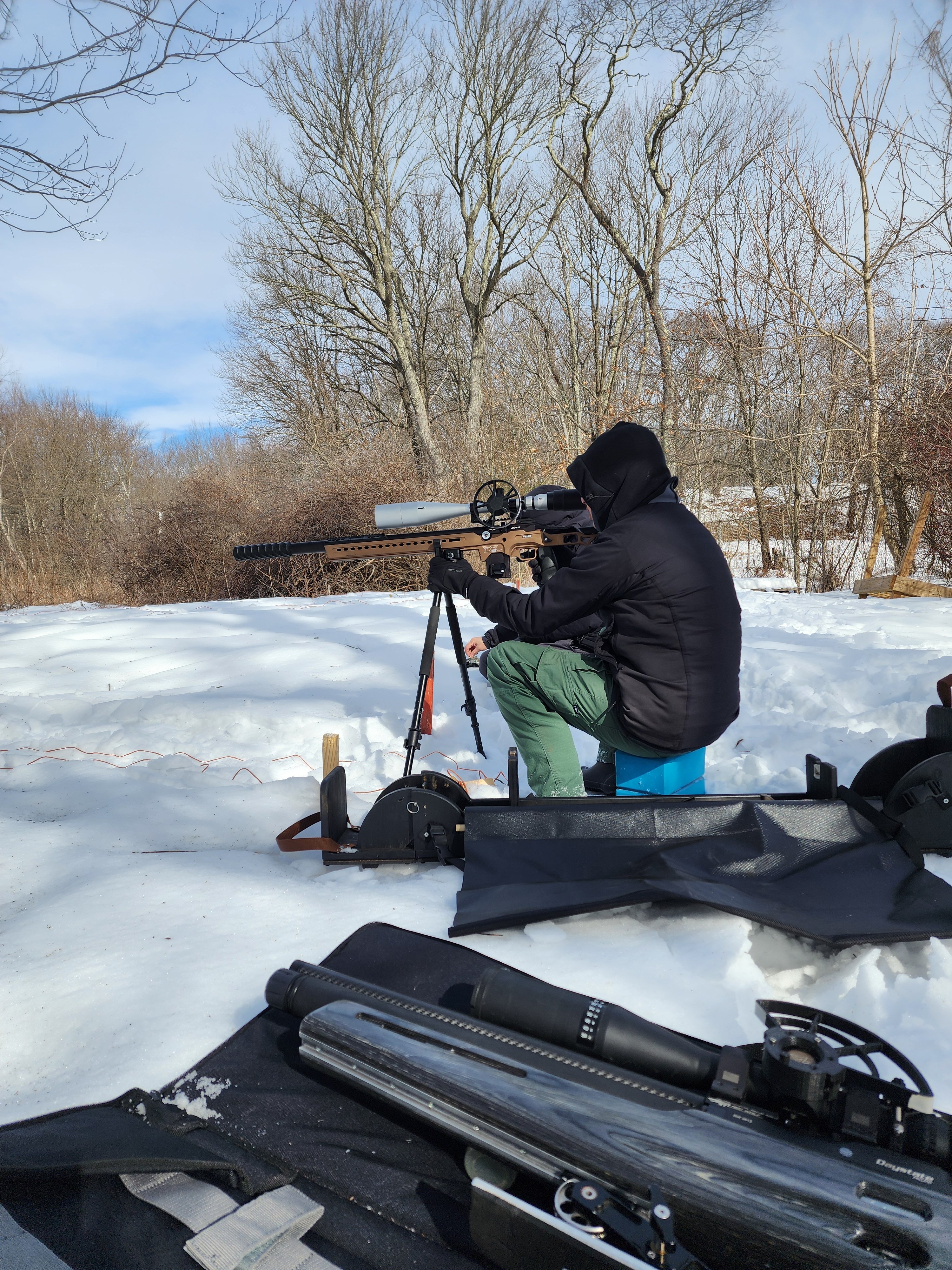

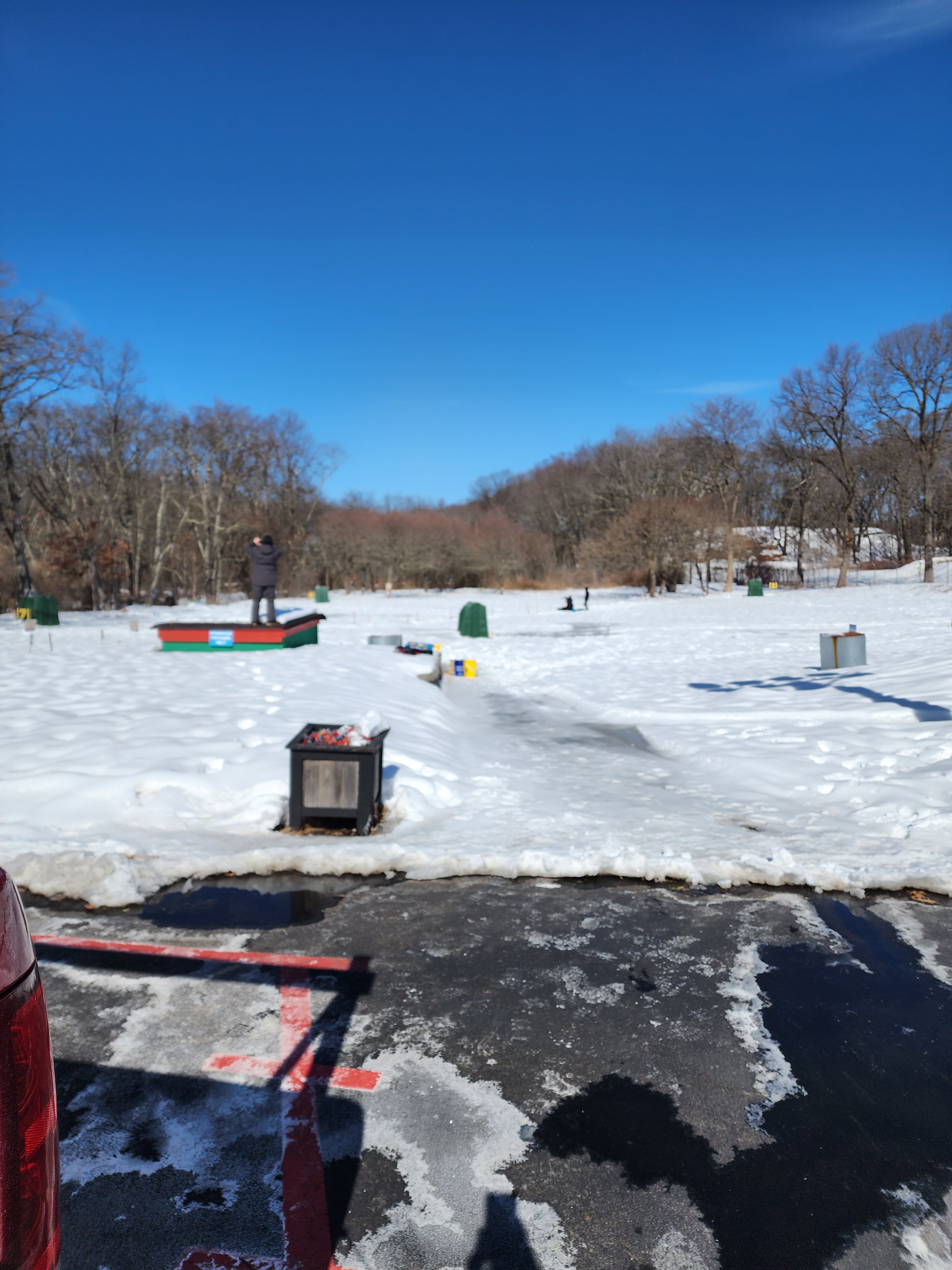

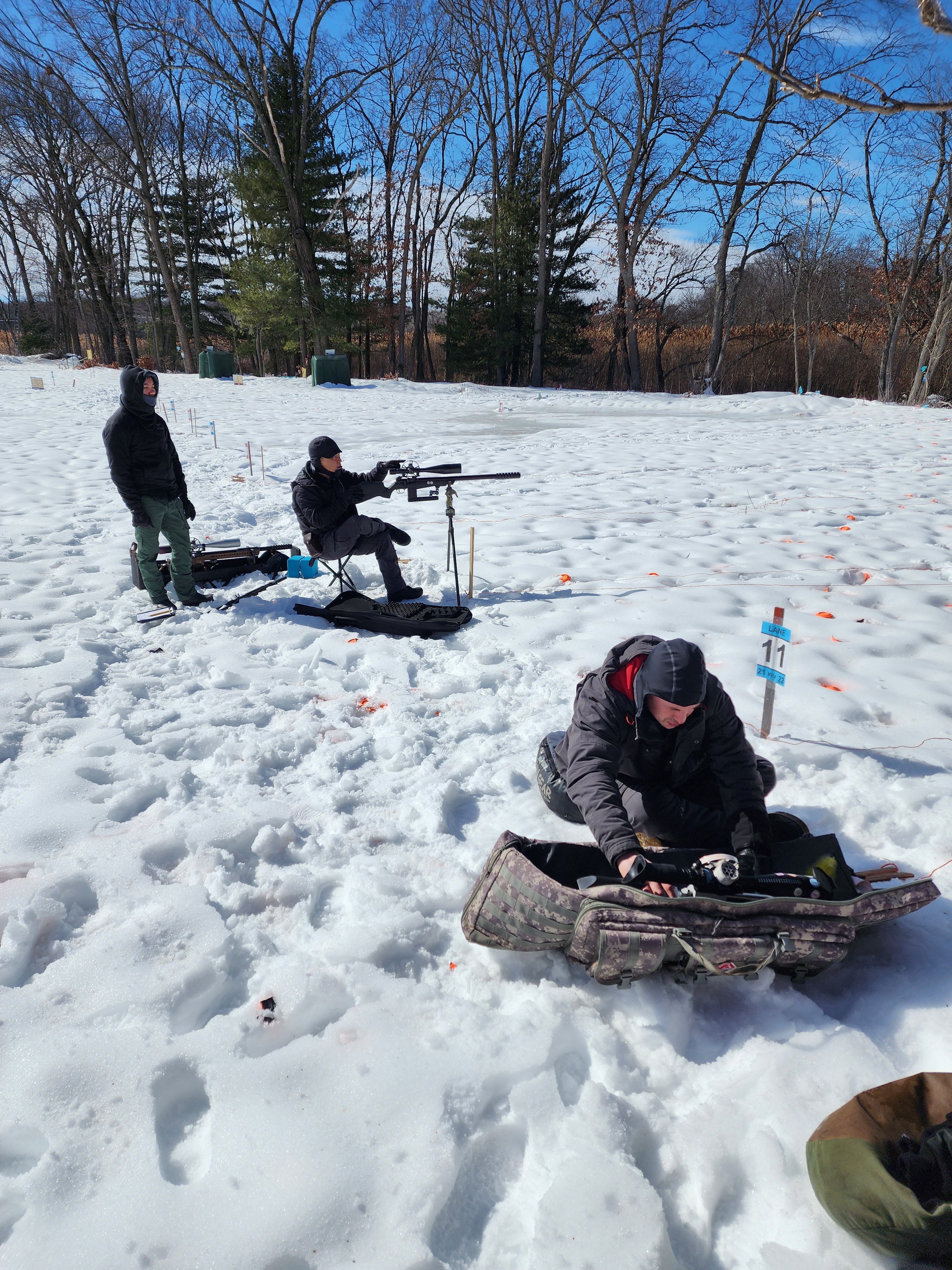

At Mass Rifle FT we shoot year round. Three is good attendendan ce for a winter shoot. Sometimes it five or six. Temps in the single digits aren't uncommon for three of those matches. It sucks. It's also fun as hell trying to figure out what not only your scope, but your rig is doing.
Our last winter match of the season there was a foot of snow on the ground. I was running lines and stomping down shooters boxes with my snow shoes.
Temps started around 8f at sight in. The thermostat slowly rose to 29 by the end of the match.

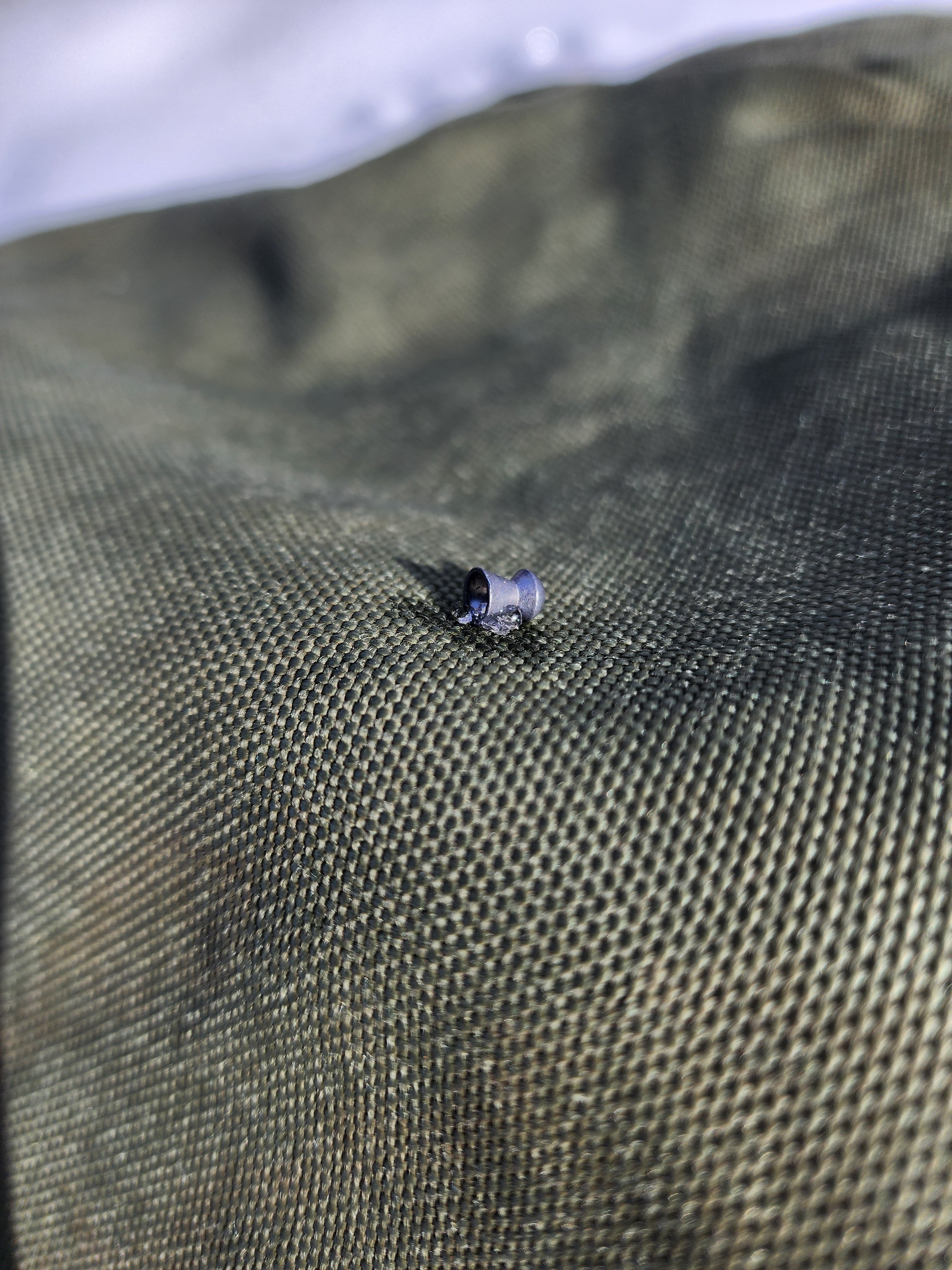

The last picture is a pellet frozen to my bum bag. Fun stuff.

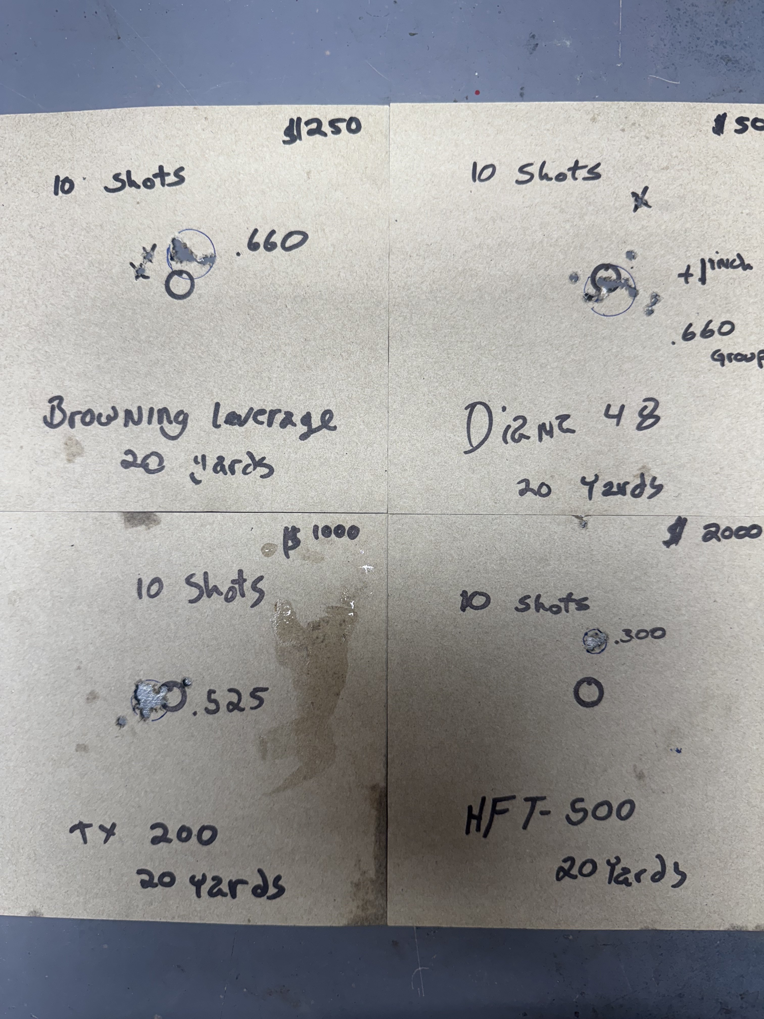

Ok this was just a first test . Four guns at 20 yards indoors/ outdoors no wind.
Problem is it is very humid. I was dripping with sweat by the time I was done. And shooting from a roll cart . The Diana was not stable so I will shoot the whole thing over on Saturday or Sunday. Depends on the weather.
But I predict this will be the end result also.
20 yards. 2000 dollars is just over 1/4 inch tight group.
For 1000 dollars it’s a 1/2 inch group. I was sweating and the rifle bounced causing the flyer.
The 500 and 200 guns are about the same. Most are under an inch . Aside from the flyers. They will do better at the range with the proper bench.

Can't wait to see how it all goes out. The .3 at 20 should be .75 at 50, which is similar to bramezy's marauder that's half the cost of the hft500.
