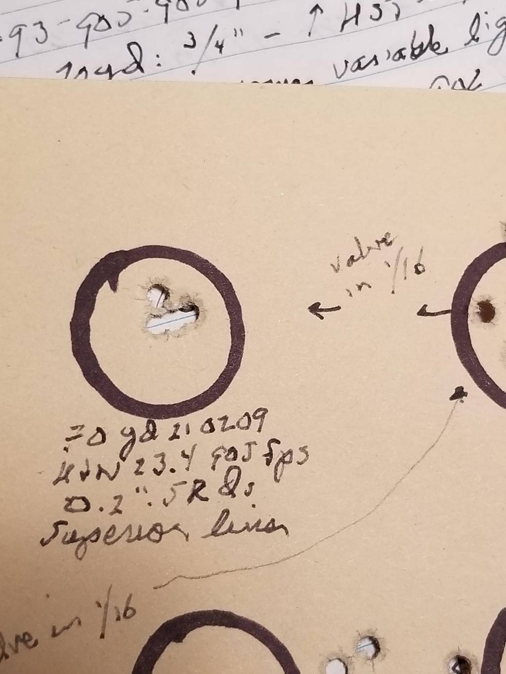

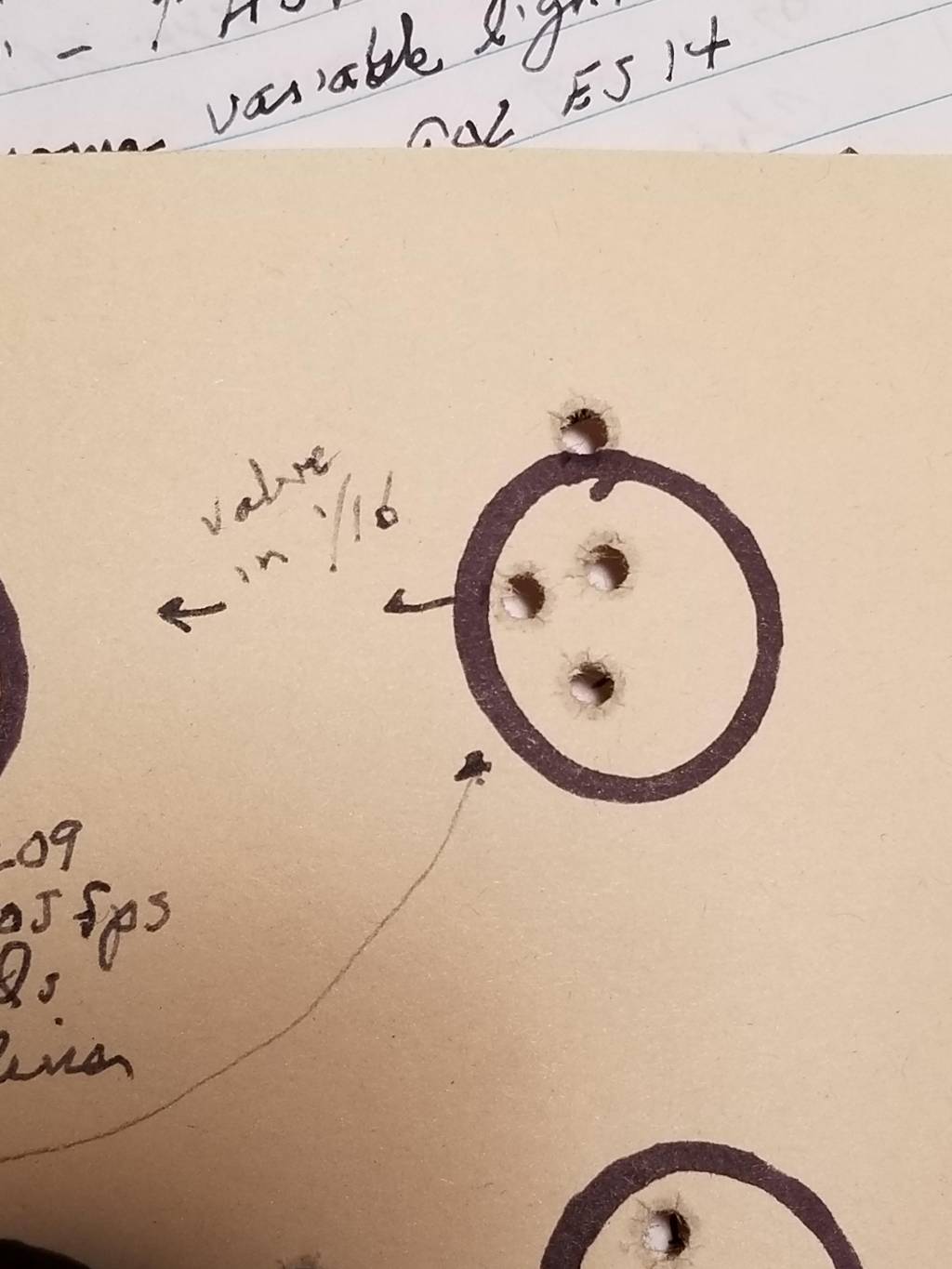

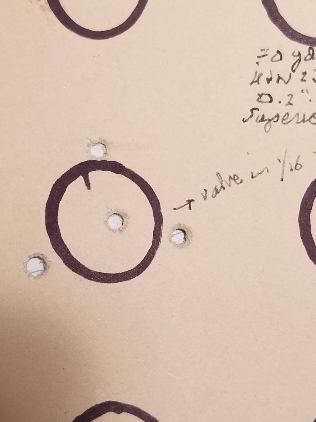

I watched Bob's video in which he says to tune to a one-hole 30 yd group, then go for 100, and if not good at 100, adjust the valve, and if no better, the hammer or regulator etc. What struck me most about it was the idea of using the valve adjuster to find the best barrel harmonic in an Impact. I'd been doing pretty well at what passes for long range in my backyard, 70 yards with H&N 23 gr .218 slugs, with 0.5" 5 shot groups the expected, 0.4" very common, and once 0.35", in the original stock pellet liner 700 mm. But of course I wanted better, so I bought a Superior (not heavy) liner, polished and installed it and set to work. Got it to just about equal my prior groups after about 200 tuning shots, then groups opened up, so I cleaned the bore that night. This AM, shooting over a chrono while re-seasoning, I found my velocities had risen a bit, from the previous 896 average to 910, but with ES only 7. Knowing from experience that a tight ES by no means guarantees accuracy, I fired five at 70 yd and got this, in still air:
Sheesh. So I closed the valve a 16th. Next five:
OK, progress. Closed it another 16th:
The 905 fps is just a guess, since I haven't chronographed it yet. Heretofore I'd only adjusted the valve to fine-tune velocity and ES. Guess I should stop caring about ES.
