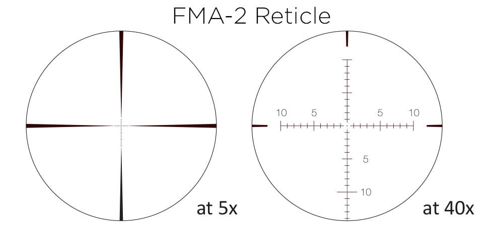

FFP Disadvantage: The size and distance between the hash marks becomes smaller when the scope is at a lower magnification — and can become so small as not to be usable for holdoffs.
➔ But this does not always apply: This effect usually only applies for scopes with a large magni. ratio. 4x ratio seems to be fine, 6x ratio not so much. E.g.:

➔ To offset this disadvantage: —Usually I use a low magni. for close range shots — when for many gun/pellet combinations the holdoffs are very small, I'm usually in my point blank range.
(Sure, really low powered guns, or very heavy projectiles, or very high scope heights still will require large holdoffs even at shorter ranges.)
—I can use the reticle ilumination to make the reticle hash lines better visible; most scopes have IR, I might as well use it.
