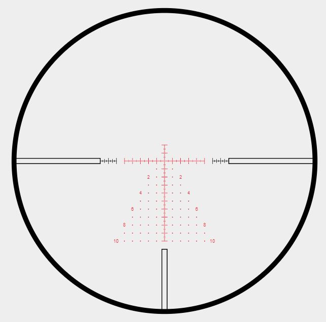

This is the reticle i'm currently using and really like it.
As most of you know, there are "challenges" with using the reticle and hold over/under points while changing magnifications so I would like to alleviate that by moving to a FFP scope. The issue i'm running into is most of the reticles at 2.5-3.5x don't look usable.

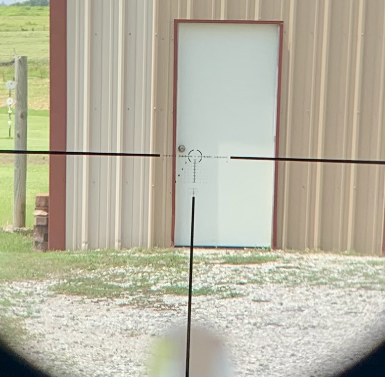

Athlon Helos BTR Gen II 2-12x44 FFP
This is what I have on my HW95, took this pic with my phone. It looks a lot better than what the pic shows. The door is 31 yards away with the scope set on 2x. You would have no problem shooting the center of the door handle at this distance on 2x.
Teber thanks for posting this. I watch a fair amount of YouTube reviews and so often at best you get a quick scroll through the magnification with no reference to distance, size of the target in the background or even stopping at a few different power levels so the viewer can get an idea.
If you happen to have pictures of the reticle at higher powers that would be interesting to see.
This is really useful Teber, thanks!
Would you say the hold over marks are usable at 2x? I ask because i'm zeroed at 25 yards but from 35-50 yards I need to use hold overs due to my limit of 495 FPS. It looks like they might be useable to like you said, a little hard to tell from the picture.
Yes you can see the holdover marks on 2X.
