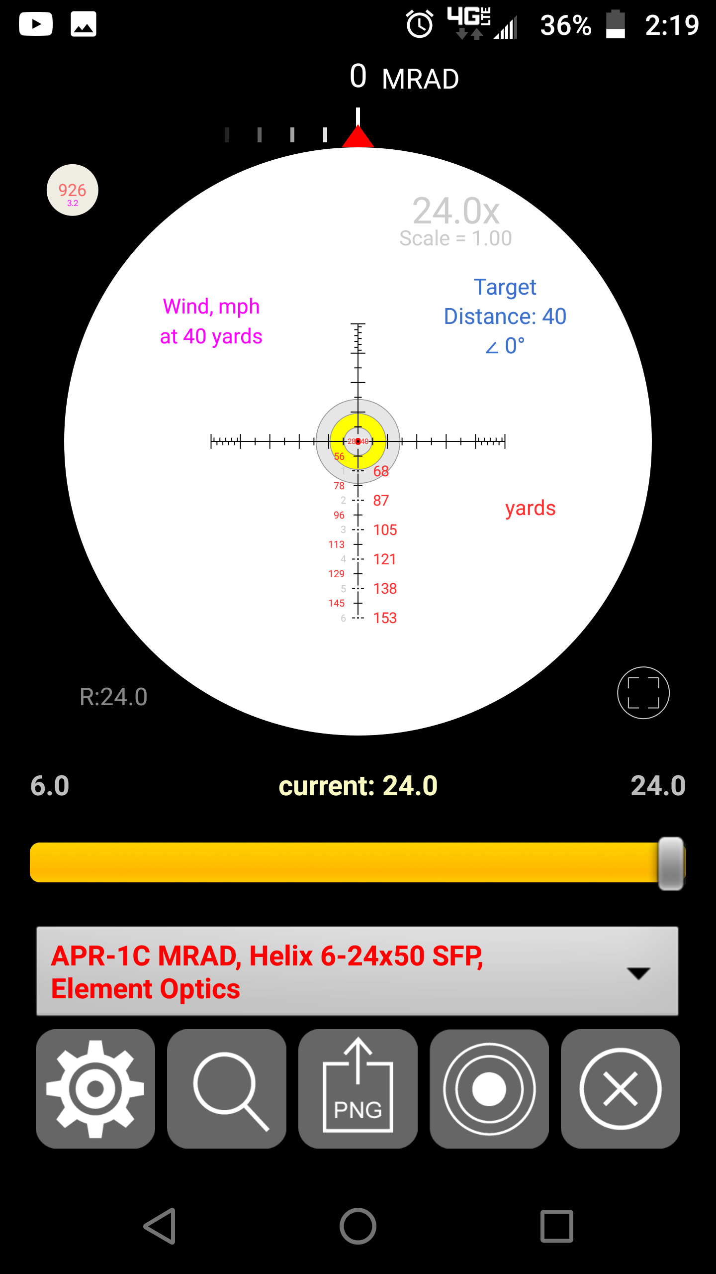

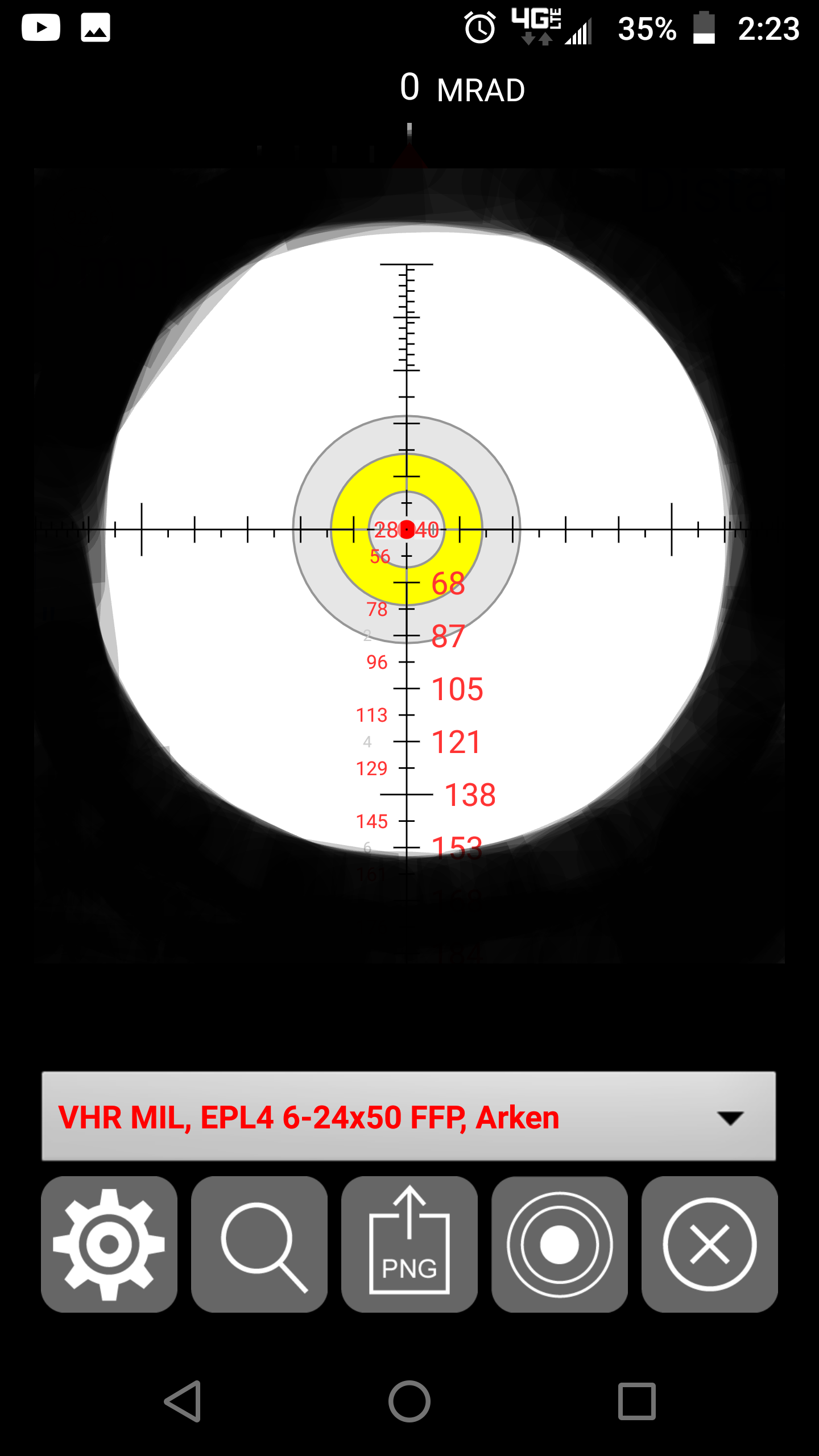

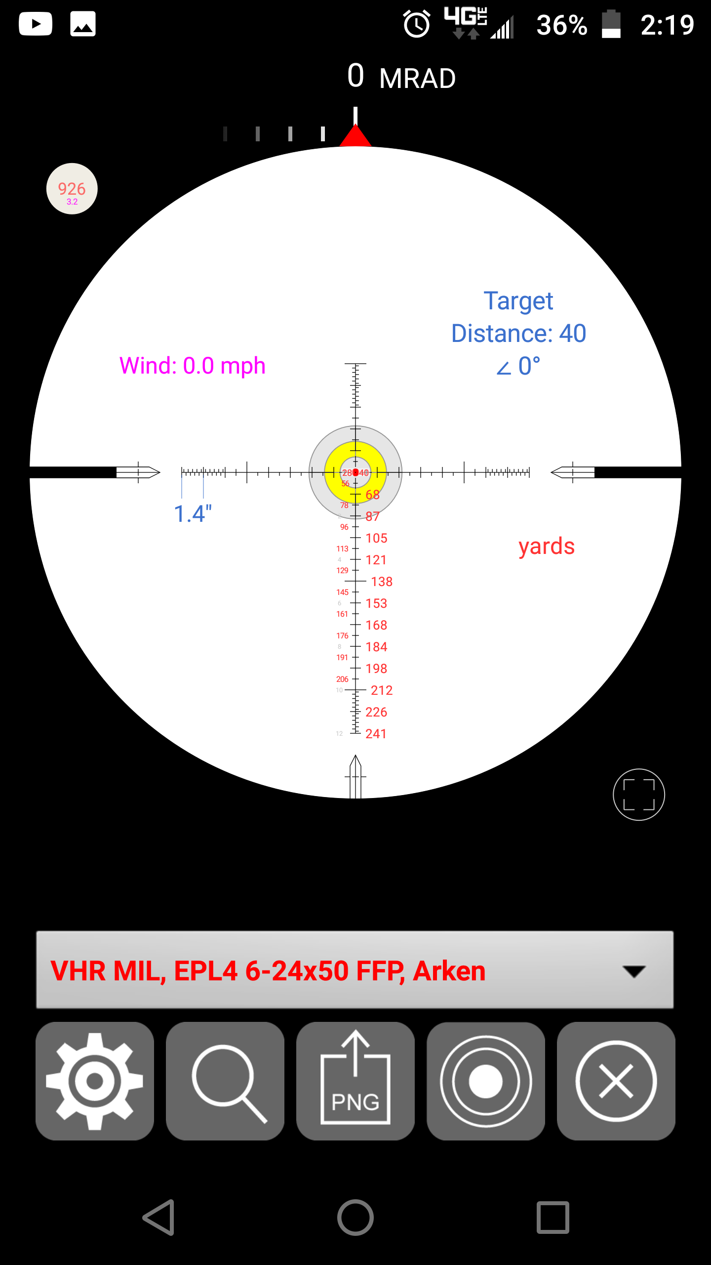

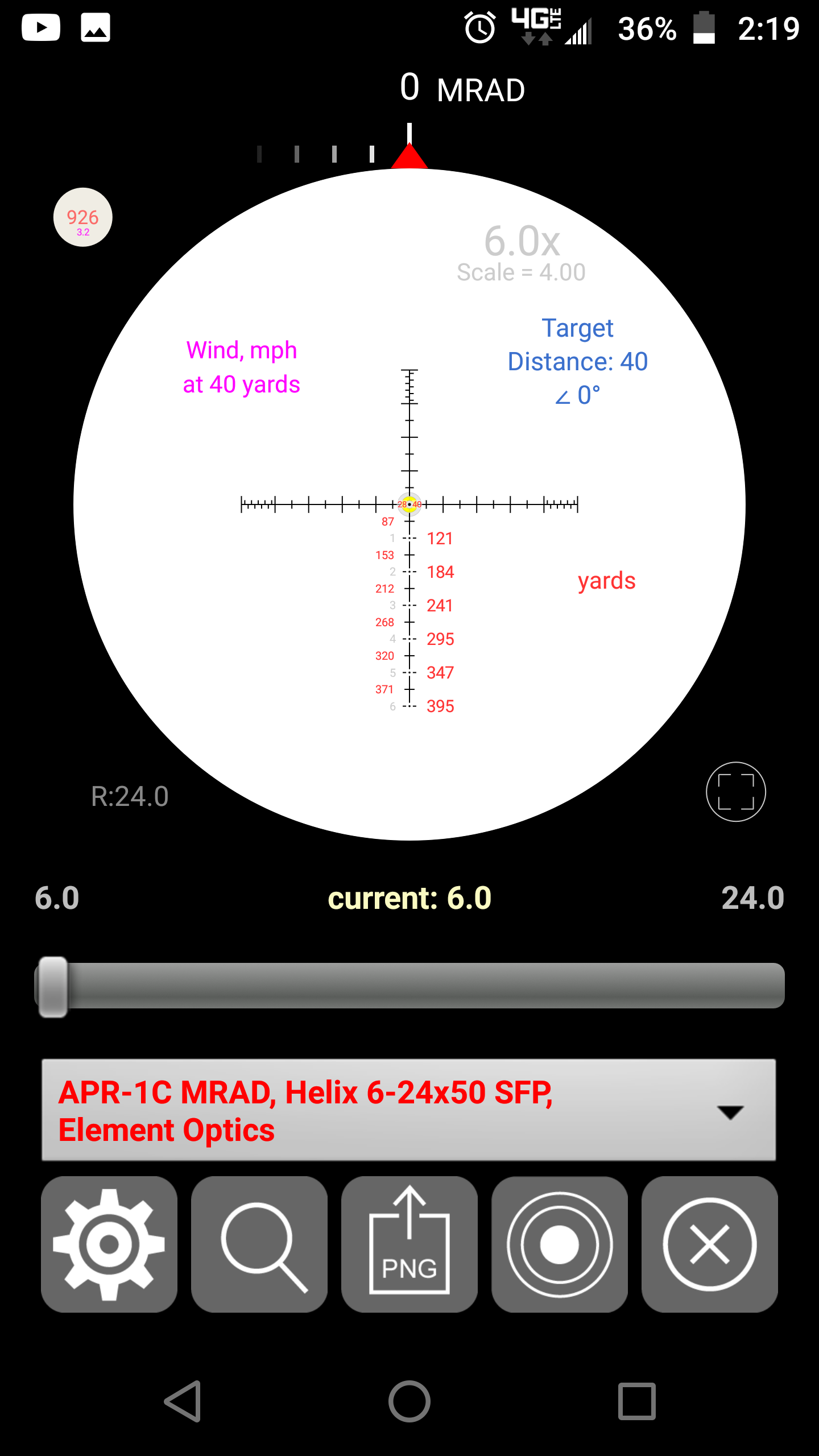

Some screenshots of the two scopes on target at high and low power, from Strelok Pro so you can get an idea of how they will look:
