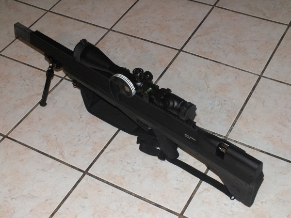

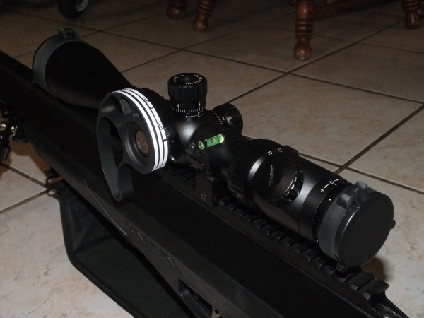

I will toss in an opinion on clarity and turrets. The turrets with the thick factory grease can feel mushy. Wipe off the thick grease and replace it with a thinner lubricant and it clicks sharply. As for locking turrets, this is true, they don't lock. However, if you send an E-Mail to the kind people at Athlon, they will send you a plastic washer kit to set a zero point on the vertical turret. When installing the washers, make sure your vertical turret knob is aligned with zero. I think the non-clarity at higher magnifications comes into play from a perceptual thing. As magnification goes way up, the eye-box (the sweet spot for your eye to be in behind the scope) gets smaller. At 34X, precise eye placement becomes very critical, and being slightly outside the sweet spot gives a reduction in visual quality. This last factor is true on a lot of scopes at 34X power. At 100 yards, I can read the small print at the bottom of the paper target through my scope, so being able to resolve 1/8th of an inch text at 100 yards is not a bad standard for clarity. I will also agree that the parallax distance marks did not match actual distance for me. I purchased a snail-style sidewheel, went to the range, and calibrated the snail.
