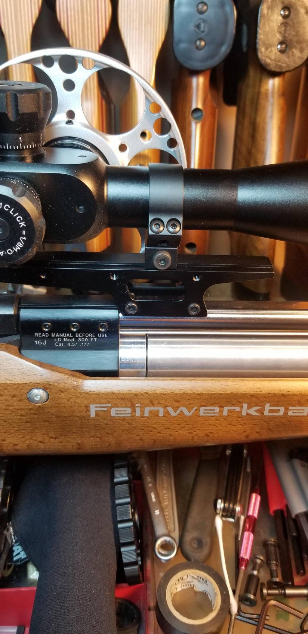

The trick with the 800 is to use a rail that mounts on the barrel dovetail and bypass mounting anything to the receiver blocks, front or rear. The 800 basic has a dovetail milled into the barrel shroud, not sure about the other variants.
My 800 suffers no radical shifts that cant be compensated for with 1 or 2 clicks, and thats with a Falcon T50, supposedly one of the shiftiest scopes around.
Going from AC environment inside the house to 80 or more outside, no extreme shifting isdues have arisen for me.

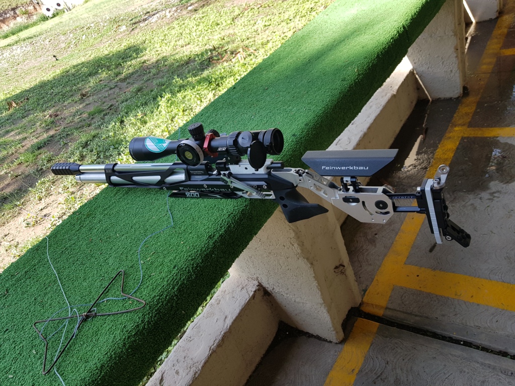

This is the second 800 FT I´ve had, sold the first one and regretted.
With the first one I tightened the hammer spring screw, but it started to group like a shotgun :( , thought it would be like a steyr, in which power can be adjusted up and down without it loosing its accuracy
I am going to ask Feinwerkbau if they can sell me a regulator so I can tinker with it.
By the way, your gun look great with that hugget...mmmm I have one I am not using, think I will copy your idea :)
Thank you very much !
Here´s a picture of mine
