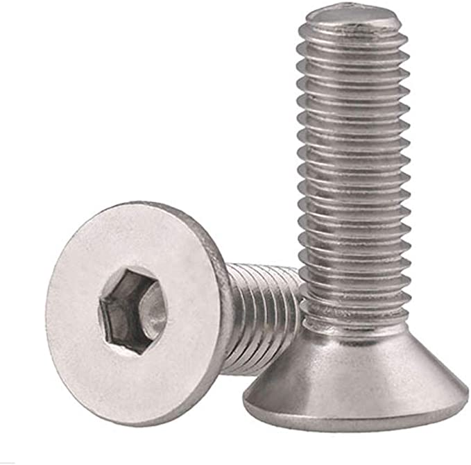

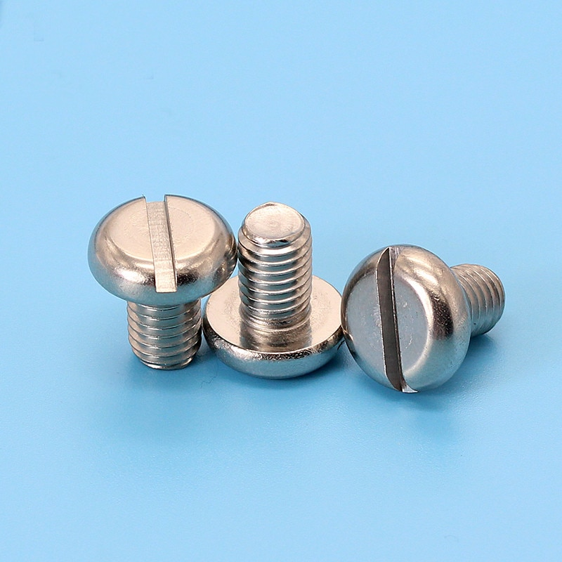

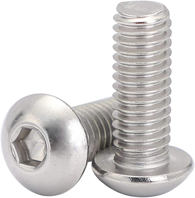

Screw designation (style) refers to the top. Not the seating side.
Your 124 uses a round head screw.
Mine has what in the US is called more of a pan head. Flat across the top and edges are rounded. What we call a round head is actually more "domed" . I guess there is a lot of controversy as to terminology. Go to a supplier of fasteners such as McMaster-Carr and you will see shapes and terms used in the industry.
Reactions: AirShot
Pan Head
Button Head
Flat Head
