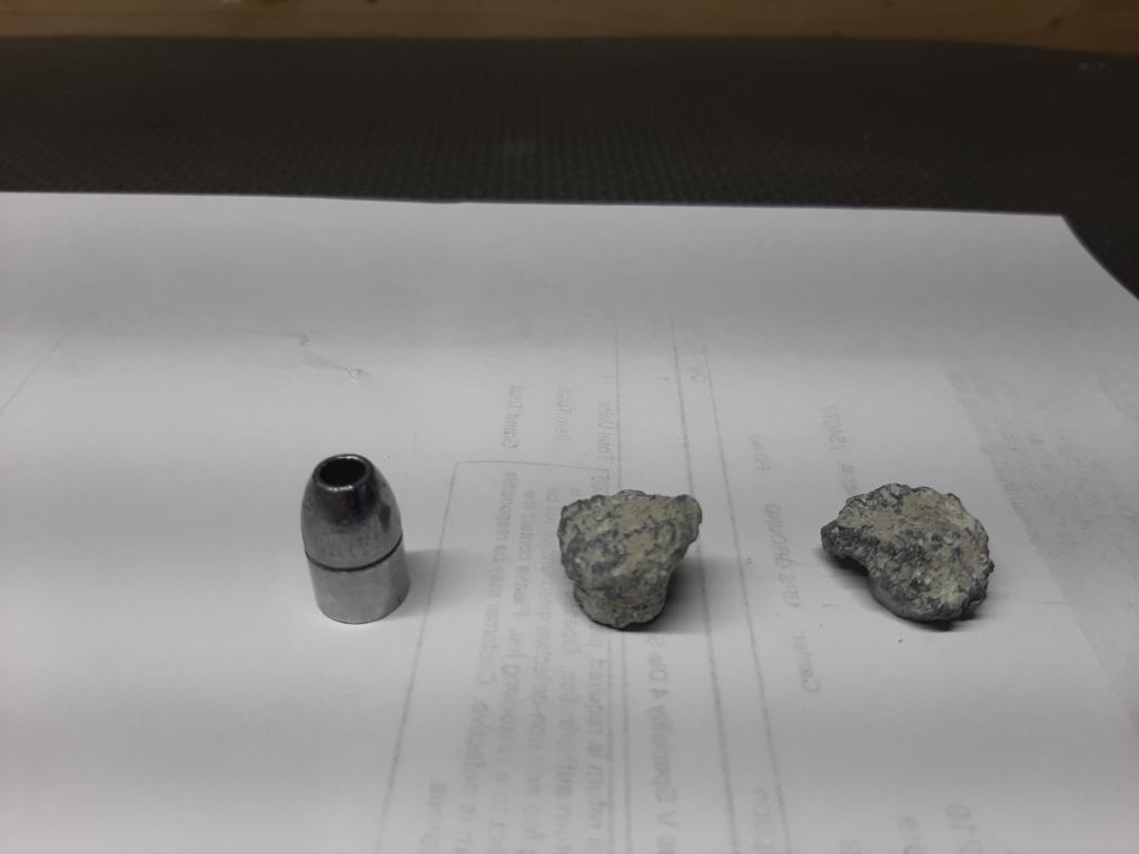

Chickentheif here's the NOE mold I've been using it casts a 286-290 grain boolit using pure lead it's the HTC459-300-RF here's a picture of the bullet the one on the right I dug out at the range at 25yds the middle one at 50yds.
Some guys go for the heavier slugs I like the flatter trajectory with these I've shot the NSA 350gr BTHP and they were really accurate but I had a looping trajectory out at a 100yds which is about max range for the woody places I hunt so I've gone back to the lighter boolits also I like to cast my own boolits probably the reason I'm in the $1000 club at NOE, by the way he makes some real quality molds. I've talked to Brent at Extreme big bore had one of his 50cals and he told me a 250gr bullet was what he shot because it would take any big game animal in North America except maybe a Grizzly bear.
