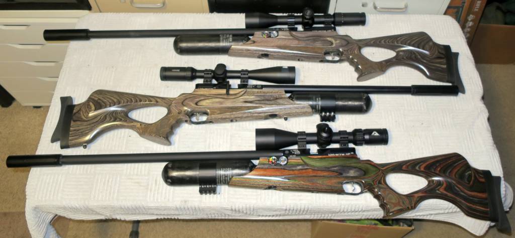

Well, we don't have exactly what you are asking about, but we currently have a Wolv .25 HP R, a .22 HP R and my wife shoots a .177 R.
Accuracy on these rifles is excellent, although I've only taken the HP's out to 50 yards. Tried shooting the .22 HP out at 100 once but ran out of scope elevation adjustments and my hold-over skill is pretty non-existent. (Now my favorite 100 yard gun is a 65 FPE Red Wolf instead of the 45 FPE Wolv. HP).
Of course accuracy is impacted by the quality of the trigger, and these triggers are excellent and very adjustable.
I do a lot more shooting at 25 and 50 yards, because that is what I have in my back yard. Daystate says that I should get about 50 full power shots out of my .25 HP and about 65 out of my .22 HP. I find this to be accurate, or maybe just a little conservative. I probably get 60-65 shots out of the .25 and maybe 75 out of the .22 before I see any POI change. Daystate says that you should get 100 full power shots out of a standard power .25 Wolv., and I don't doubt that at all.
We have never had any issues with our 3 Wolvs.
Have you had the opportunity to handle one? The Wolverine's grip is quite large and I sometimes find myself getting sloppy with my hand hold position because of this. And I'm a size XXL glove kind of guy. But I'm also a more casual shooter. If you take your shooting more seriously you will want to handle the gun for a bit to make sure that the grip is comfortable to you.
While I like the Red Wolf a little better than the Wolverine, as a fully mechanical gun the Wolverine is hard to beat. They are not as light as some comparable rifles (for example a Crown wearing a laminate stock is lighter than a Wolverine), but weight is your friend when shooting off a bench or from a blind. Not so much when walking around.
