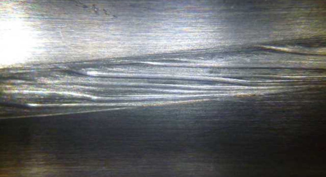

The quote and photo are from Frank Green of Bartlein barrels.
Frank Green
"I would caution you also that we are talking here on this thread two different types of JB.
You have JB bore compound... You have JB bore brite.....
I/we will only use the JB Bore Compound. Not the bore brite".
Frank Green "This is what happens when you use a brush with an abrasive cleaner! I've posted this picture several times and it never gets old as to what can happen!
The bore and groove should measure .277" x .284". It now measures .279" x .2855"! So basically polished a full .002" out of the bore and .0015" out of the grooves. The lands (the bore) sticks up so it will take the brunt of the damage.
A lot of powder burning forums say the Bore Bright is more aggressive and to avoid using it. It's a mixed bag of who would and would not use either of the JB products.
Perhaps there is room for different interpretations of the word "aggressive" here but the Bore Bright product is most definitely a finer abrasive than the standard compound. I have compared them on a polished specimen and the Bore Bright produces noticeably less dulling and swirls. And using it on a brass lap to develop a beveled crown reveals a markedly slower material removal rate.
Regarding any concerns about enlarging a bore with either one, I can't comment on how much using them on a brush affects the material removal rate but I know beyond a shadow of a doubt that it would take a Herculean effort to remove 1.5 - 2 thousandths with either a mop/felt or a cast lap. Maybe by spinning it up in a drill and scrubbing across the lands, but here's a picture of the only guy I know who could do it by hand...
