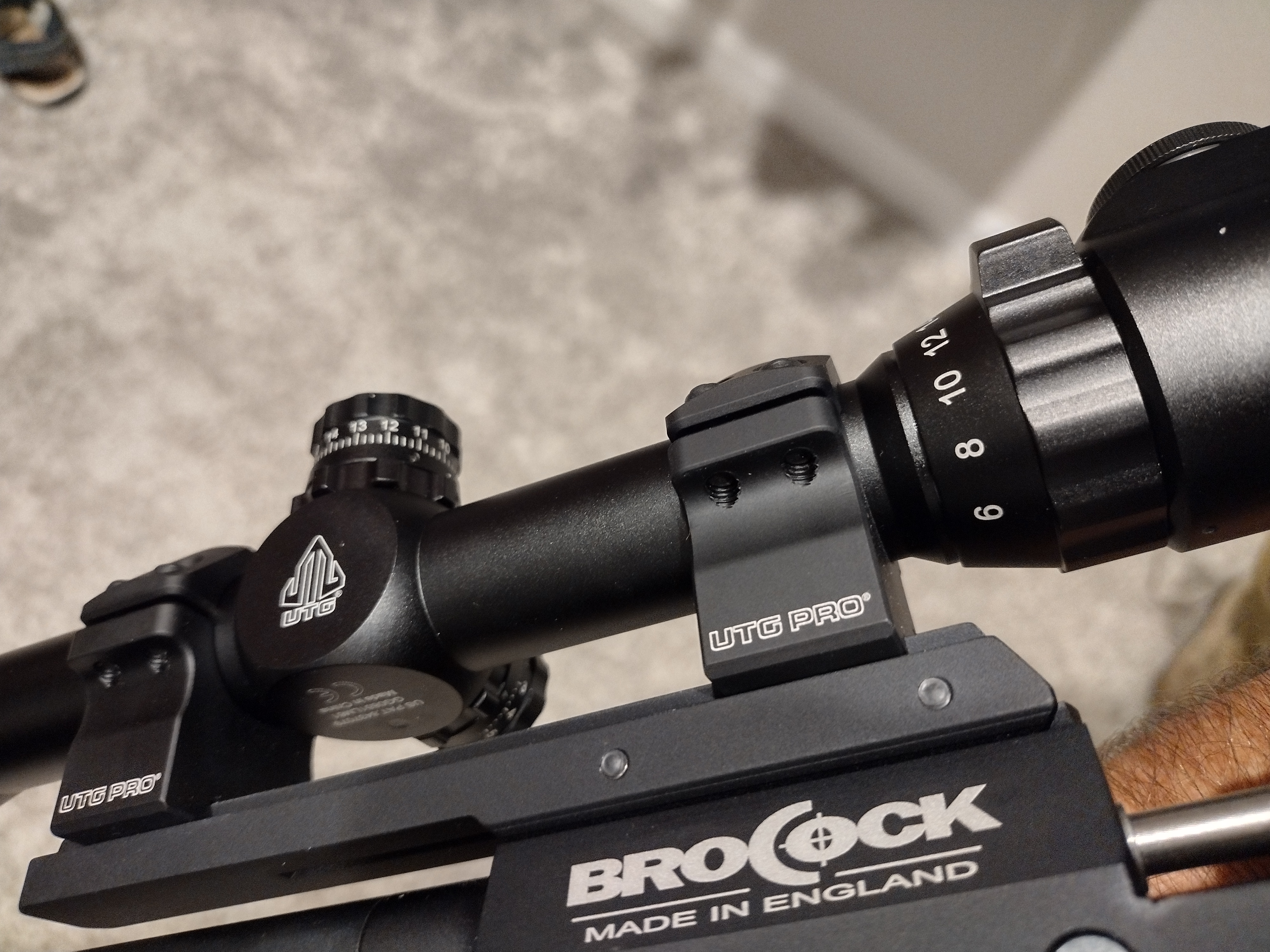

I actually like the UTG Pro line made in the great state of Michigan. Quality stuff
Reactions: Nico5999
Thanks! I'll check these out. Always a fan of US-designed and manufactured!

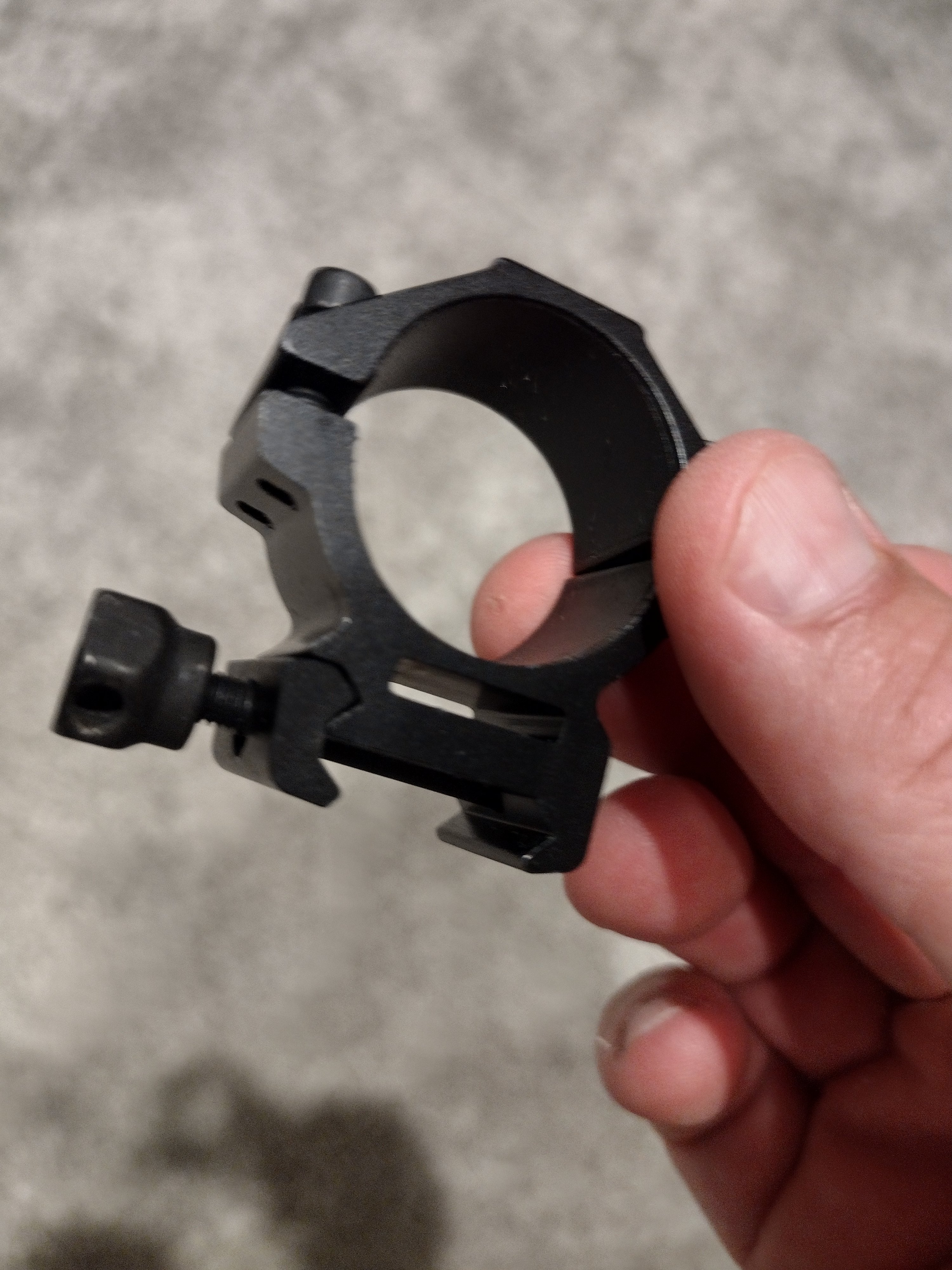

Do these feel off-center at all because of the way they mount?

Here is the affordable UTG non Pro line that is standard with their affordable optics:
The difference between the Taiwanese or Chinese variant and the USA made Pro line is visibly substantial and of course in function. You can really tell the quality and difference. The Torx screws are really nice too and won't fall victim to striping.
