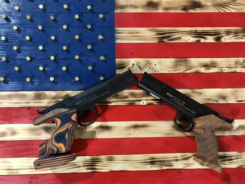

We use JSB lights, and RWS Basic’s in our FAS 6004.
A pellet that we know does not work in the FAS 6004 is RWS Hobby, do not waste your time with that one.
The FAS 6004 is a fun pistol to shoot! With a little work you can bring it up to 400fps to 450fps, allowing other ammo choices. Look at this thread, from Target Talk-
