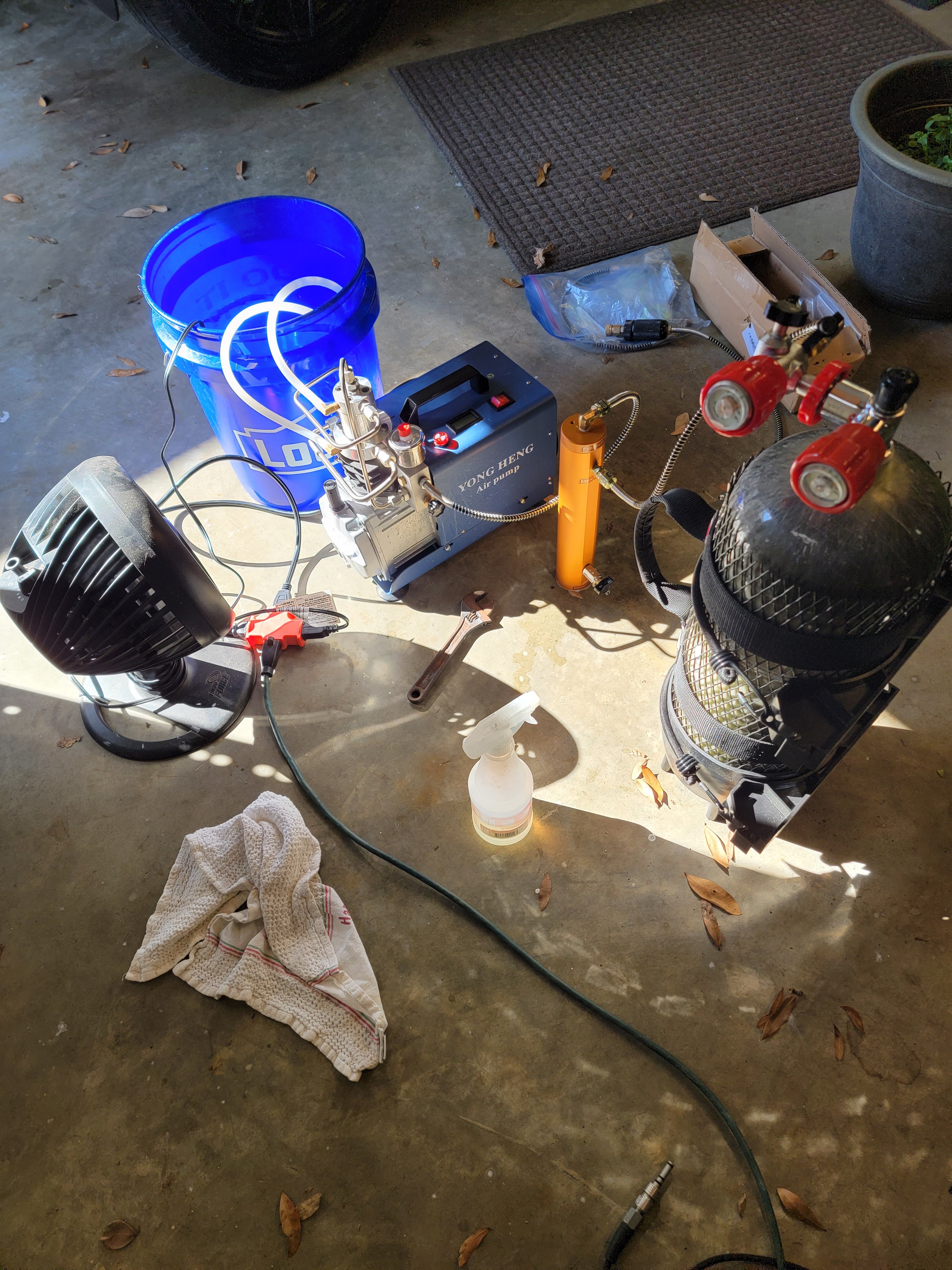

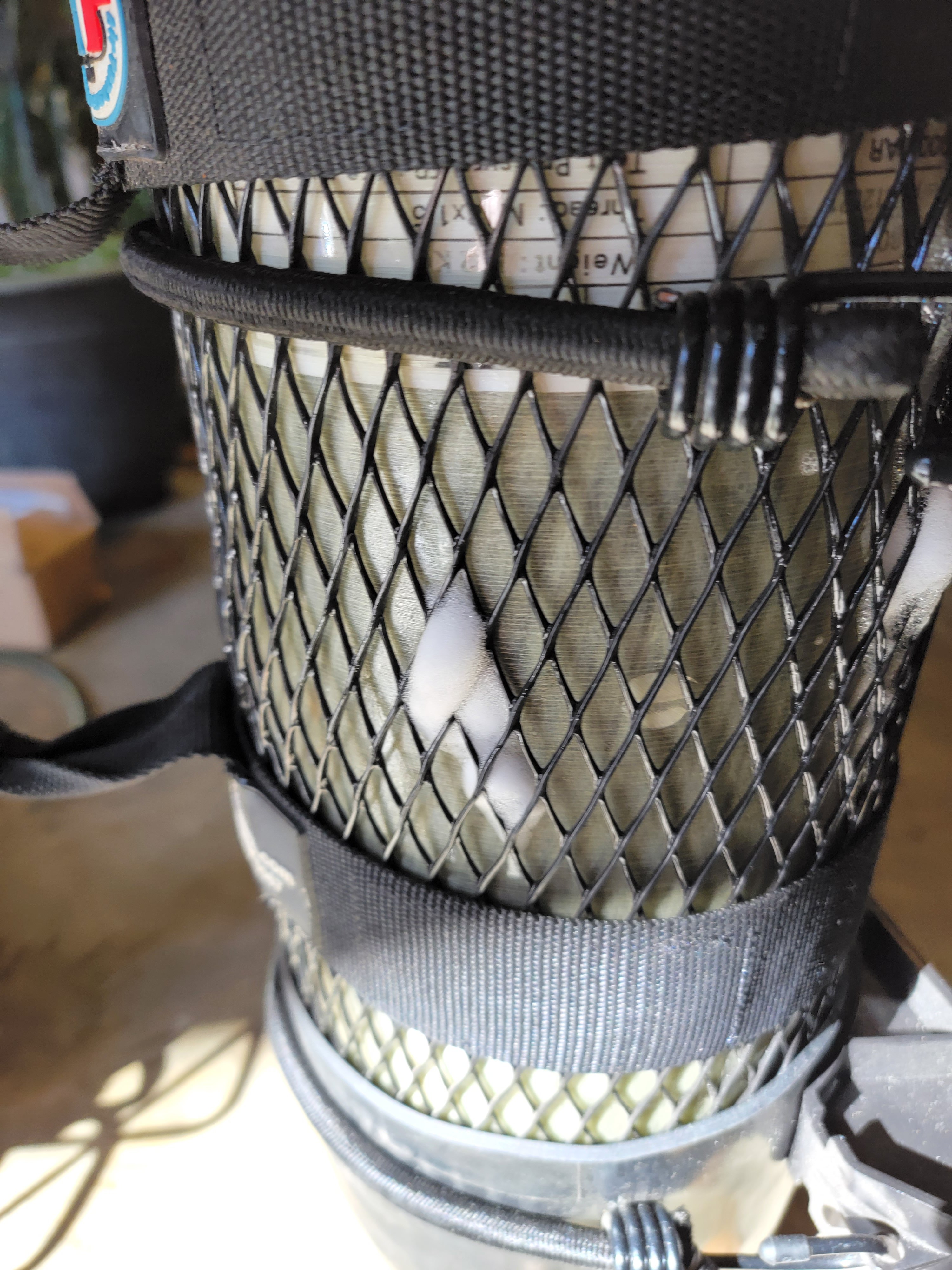

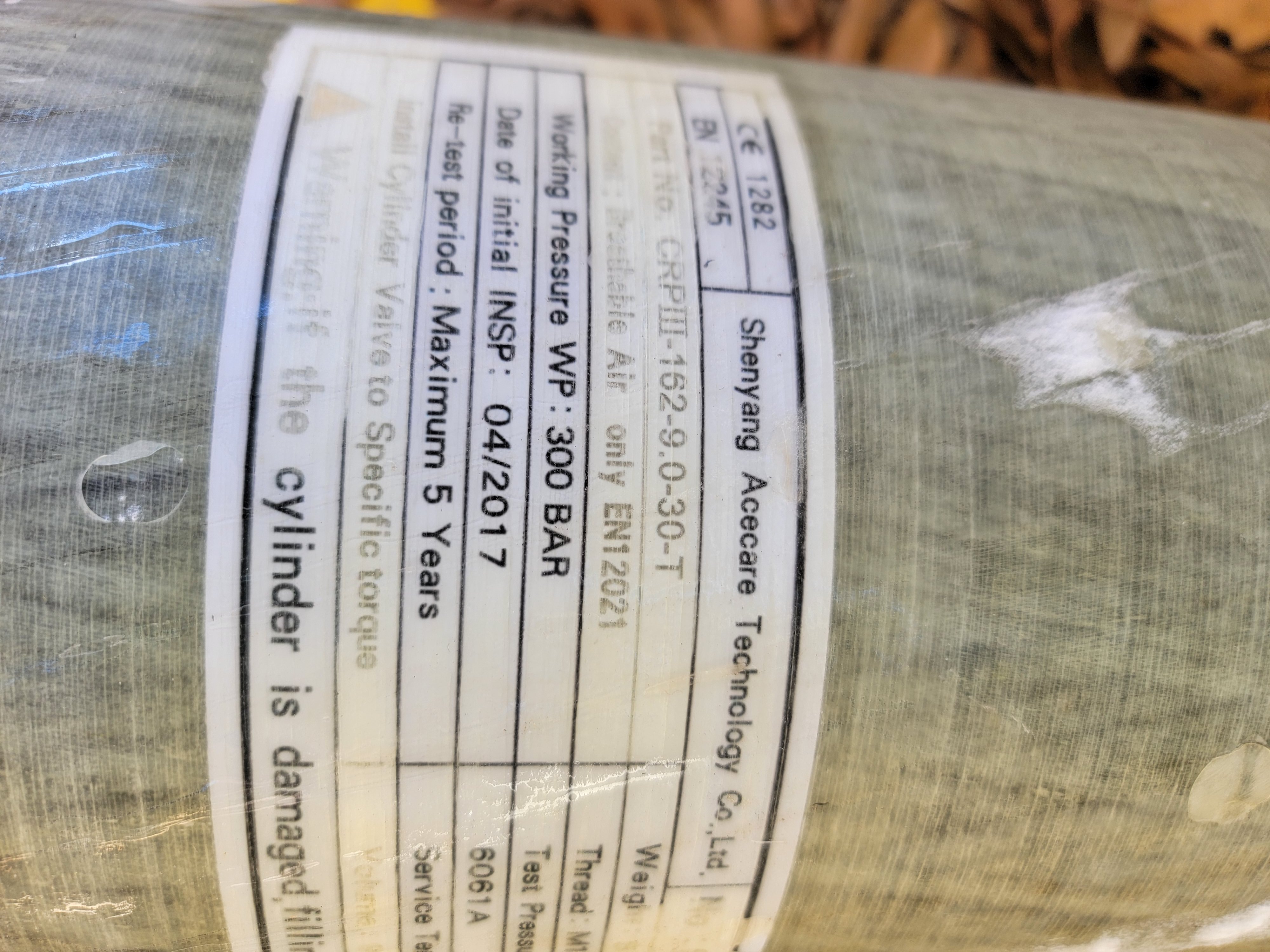

So I was loosing air and assumed it was the valve. I used soapy water and yes my valve on my air tank had a slow leak but I fixed it. But the leak was still happening to my dismay. I hooked everything up to my yong heng and my new water separator. Sprayed all connections and at about 3000 psi discovered that my tank was actually leaking in not one but 2 places. See pictures. I ordered this tank in early 2017 along with a valve out of China as well as the compressor as the costs were so much lower. Because I stopped shooting for the past 3 years and didn't have a good water separator and stored the tank in the variable SC environment of my garage. So word of advise. Don't do what I did.
So I am looking to replace my valve and tank and any advise or links would be great.

Gotta say though, this sort of controlled leak makes me feel better than hearing about a kaBOOM!!! Been a handful of people mention over the years that this is the typical way that a scba tank fails, kinda reassuring to see that appears to true.
I recently had a good friend JUST LOOSE one of these large CHINA tanks .... Inner vessel likely fractured and air bubbles found leaking threw outer wrap in several place.
See: Chinese SCBA tanks
Same result Scott? leaking out the sides of the tank through the carbon fiber wrap?

I think you are luckily as hell that it didn't rupture. that would have left a mark, or twenty.

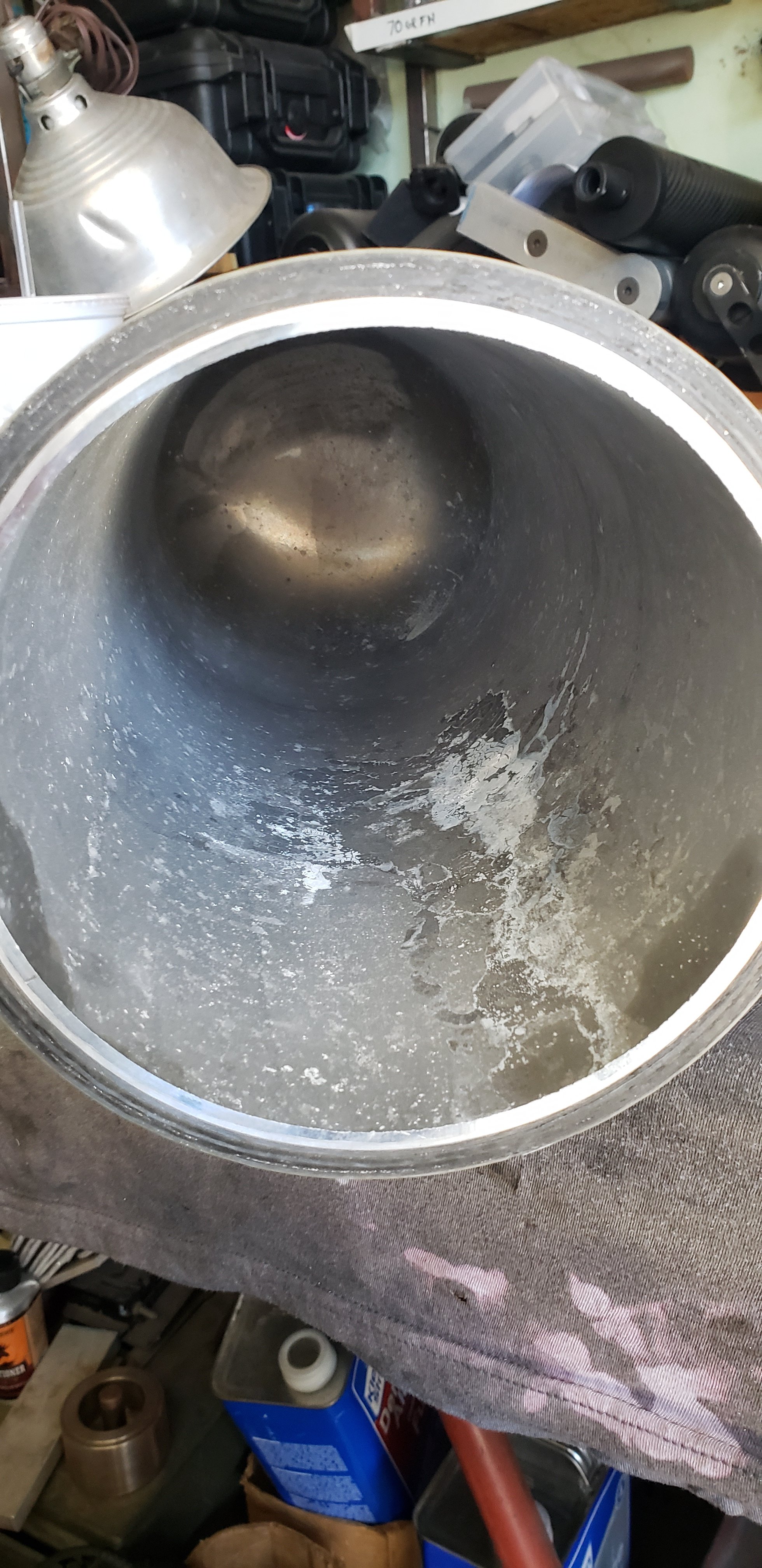

Yup, that is a well documented fail mode for carbon wrapped bottles. Moisture does really bad things to the aluminum liner especially under high pressure and you end up with air leaking through both the liner and the carbon wrap. I have attached a link below to a short video that an AGN member (whose name I cannot remember) posted showing this exact problem. He then cut the tank open and shows the oxidation that was present on the aluminum liner, photo included.

To the OP - Sorry to learn about your tank failure. Fortunately it was a fairly uneventful failure! I am sure the members here would be interested in seeing how much damage there was inside your tank if you wanted to cut it open or check it with an inspection camera.
A good example of why you need an efficient moisture trap that you constantly monitor and why you might want to inspect the inside of your tank on a regular basis. I plan on checking mine internally once a year. Very easy process, just let the air out, remove the valve assembly and run a USB bore light around inside to check the condition of the aluminum liner. Also a good idea to check inside any used tanks you buy that you aren't going to hydro test, before finalizing the sale and before filling them.
After seeing this, I am glad I didn't buy a $300 Chinese tank off Aliexpress.
