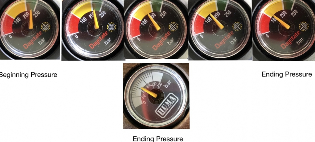

Factory Regulated Daystate Regal Shot Count
There's a HUMA fill probe conversion at the end of the reservoir where the male Foster and fill dust cap used to be with a manometer to read overall tank pressure while the factory under the stock manometer reads regulator pressure only.

Bigragu sent me this link a while back. It's Regal air cylinder gauge and fill probe adapter.
Jking
https://www.hw100tuning.co.uk/product/daystate_cylinder_ends
Thank you, thank you, jking
Exactly what the doctor ordered!
BTW
Did you happen to notice that there are 5 hash marks per 100BAR on the gauge.
Correct me please, but that calculates to 16.67 BAR per mark, correct?
Makes one wonder why, as it's not very intuitive

SilentSquirrel,
if they taught me correct in school wouldn't that be 20.😉 I did notice they were ought of stock though. Just a FYI, I did get one of these for my regulated pressure and it's only off by 5bar and it's incremented in 10bar. I ordered it from Huma at the same time I ordered the regulator. Trenier may have some as well.
https://www.huma-air.com/Mini-Pressure-Gauge-23-mm.-G1/8-BSP
Would be nice to know what size mini gauge the Daystate QF End & Gauge uses. If 25mm was an option this would be a nice one. It's in 10bar increments as well.
https://www.huma-air.com/Mini-pressure-gauge-25-mm-round-body-G1/8-BSP

About the markings on the gauge
At first I made the same mistake
4 lines between 100 & 200 break into 5 spaces each equaling 20
5 lines break into 6 spaces each equaling 16.6 +/-
Take a look at the Huma gauge from 100-150 as an example
