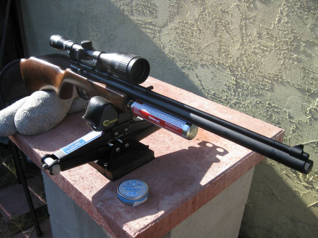

...and for the budget shooter..AS392T $90....Scissor jack front rest...$15

Crazyhorse, that is genius.
Edosan shared a small scissor jack a while back that he got off of Amazon. It was the prefect size for a front air gun support and it was only like $15 if I remember correctly. I think he did a post on it last spring or summer. Pretty cool indeed.

I needed something that would work on all my air rifles in lieu of a bi-pod at the bench. It sure made testing/sighting-in easier . But I did just buy my first bi-pod for hunting recently.
