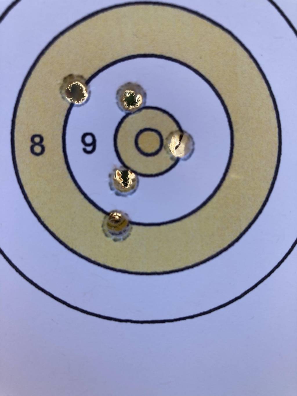

Hmmm, would usually post a group or target like this on the bench rest forum. But, my last 5 shots at 100 yards .25 Impact 43.5 NSA slugs from my EFT bucket and sticks position. It was a drop the mic moment and I put all my stuff away and went home to dinner after this. The 9 ring is 1.2 inches so I’ll call this MOA.
