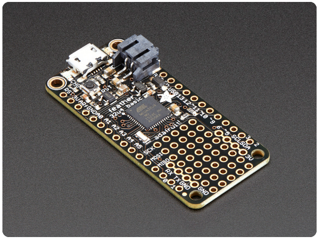

So I thought I'd build a little Arduino circuit to do the job. I've tried a few different options, re-learning some basic things about electric circuits along the way. I've settled on a basic design that seems pretty robust. The core of the circuit is an Adafruit Feather 32u4 "Basic Proto" although I imagine you can find other similar circuits from other dealers. This is a very basic board that uses Arduino coding conventions. All we need from it is we can program it to turn on and off a 3V terminal.

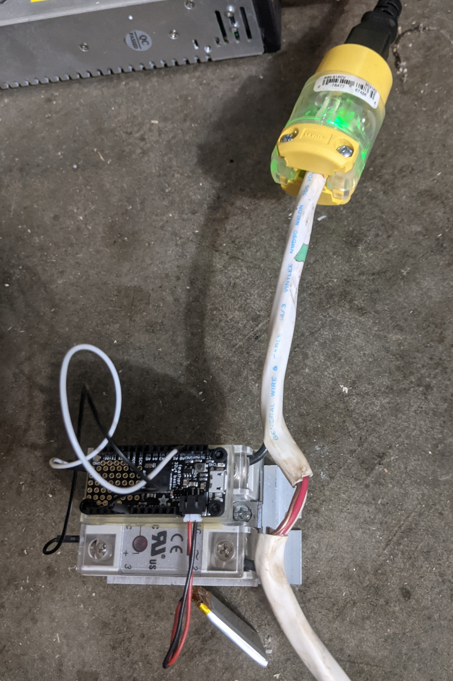

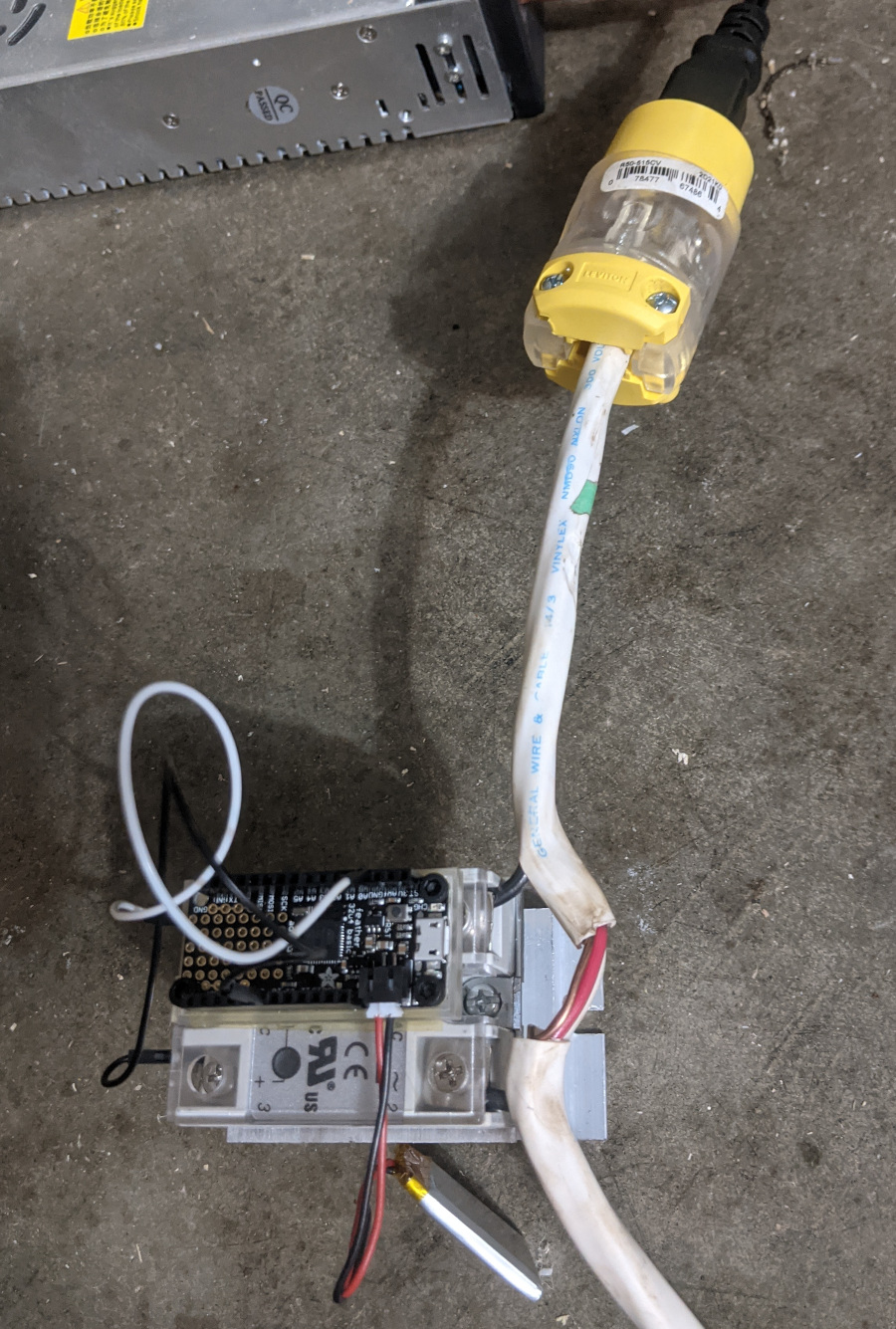

The 3v terminal will be connected to a solid-state relay. The key thing is to find a solid state relay than can turn on and off wall power (120V, moderate amperage), yet triggered by a 3v current. This one by Inkbird does the job.
I've been doing some home rennovations recently -- tearing down some walls, and tearing out the electrical wiring so I have some electrical wiring sitting around that's perfect for the job. You can find this kind of wiring at shops like Home Depot. With these ingredients, I wired them all together, and put little male/female plugs on the wire ends. Getting a female plug with an LED to indicate power is a good idea, as it helps to test the circuit.

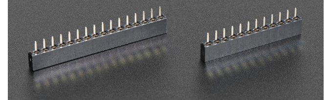

Not certain if you can see it or not, but I soldered on "headers" to my Adafruit board, as it makes it easier to connect things to it.
Not necessary, but it makes life easier.

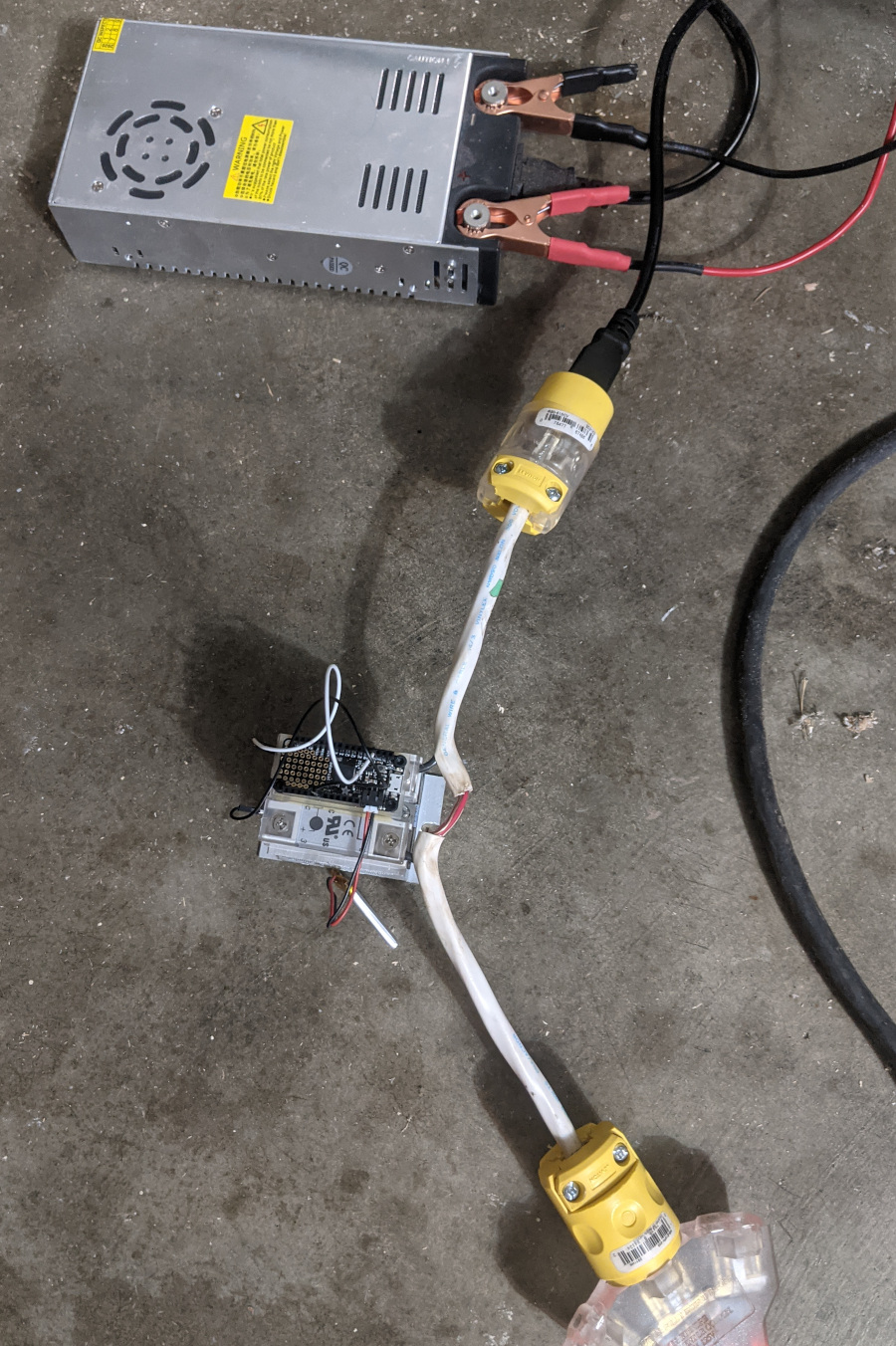

So my little circuit plugs into the wall power supply, and then to my compressor. I leave the compressor's switch "on" so that the Adafruit can control it. I should add, if you aren't very comfortable doing electrical work, one of these socket testers will really help.

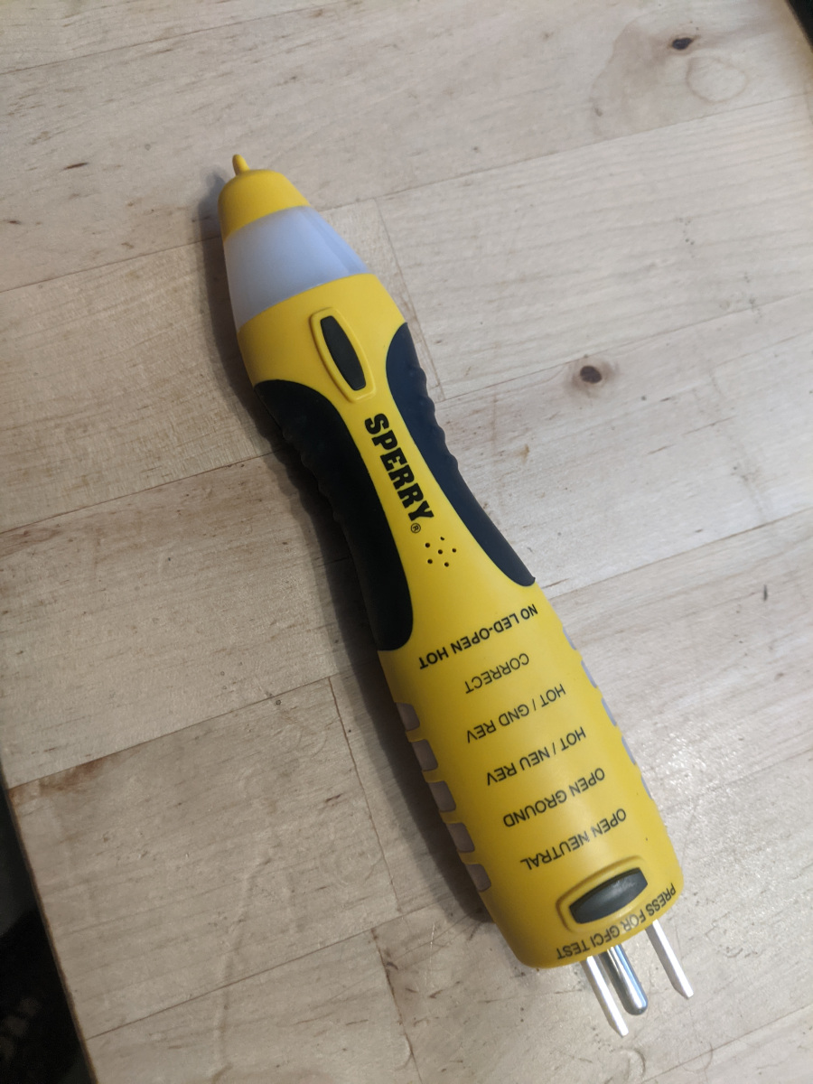

If you plug it into your female socket with the adafruit turning it on and off, it should alternate between displaying nothing (off) and "correct". If it gives you something else, you know you wired things up the wrong way. It's important to know the relay needs to have the hot wall line connected to it. It won't run properly if you've connected your wall neutral (or ground) to it.
Here it is, off.
And on.

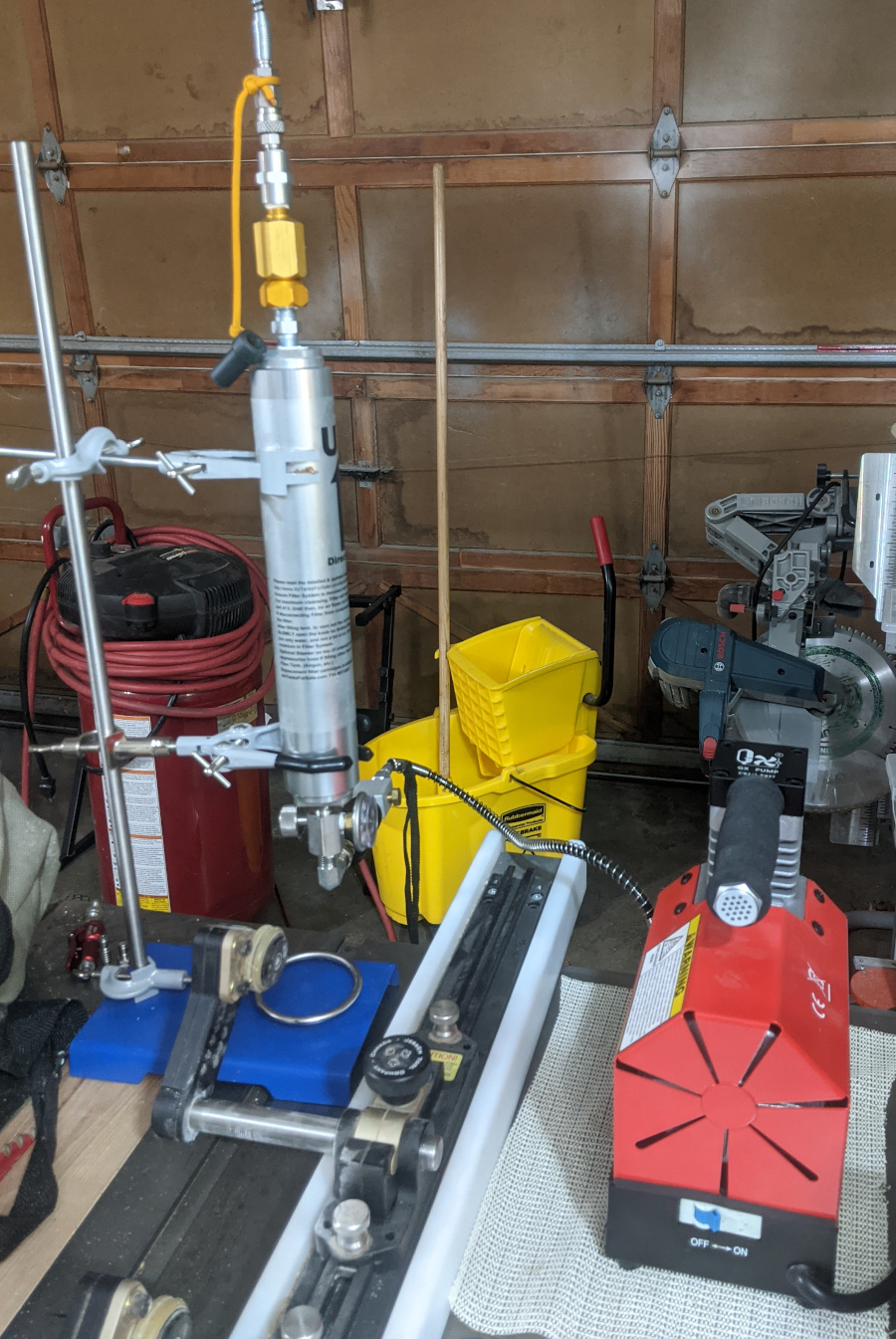

My pump and air filter.

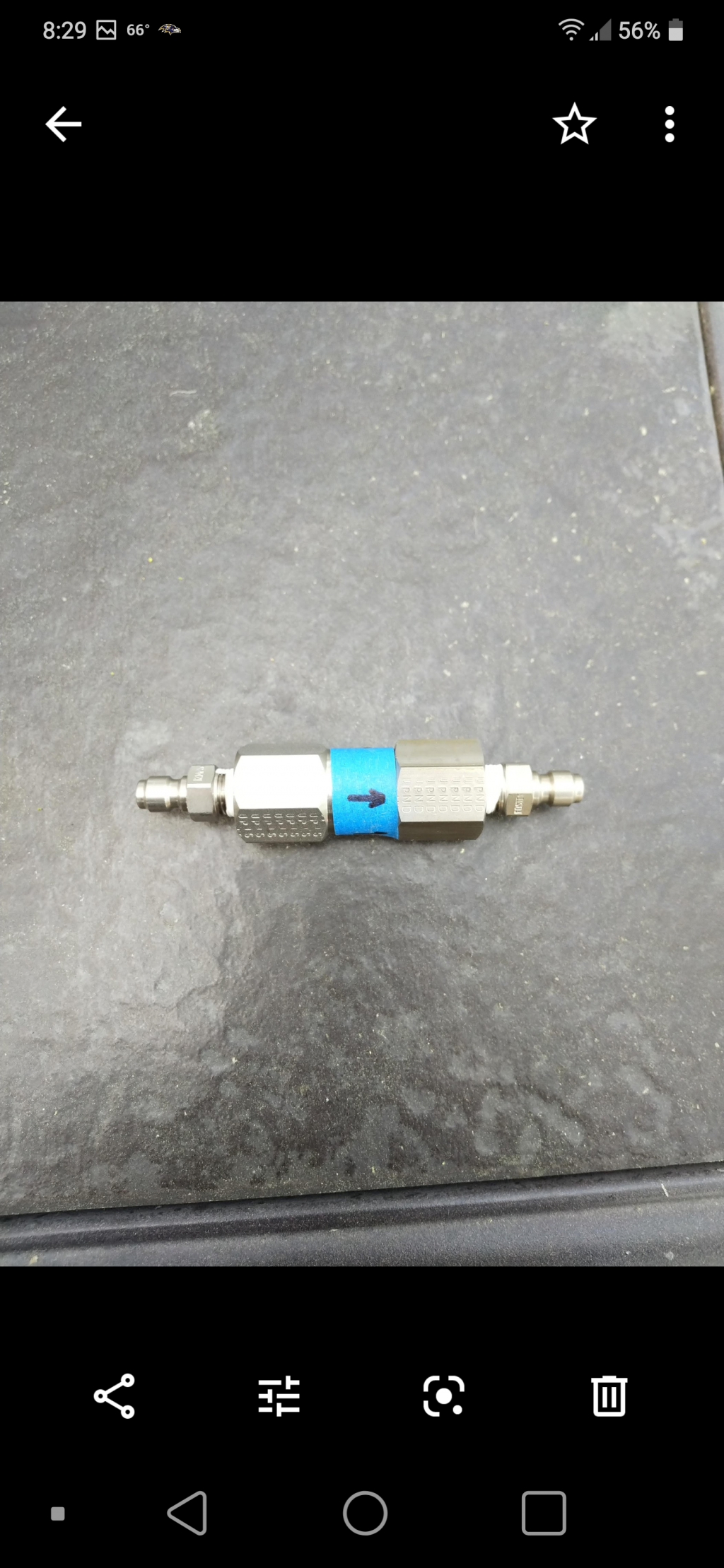

I have read about in line two way high pressure check valve quick connect in between compressor and tank to prevent catastrophic compressor failure such as described.

I was wondering a check valve in between the PcP gun regulator and action so no go boom in case regulator failure and over 4000 psi don't go into a Avenger or Huben or Ataman or any other regulated 4000 to 5000 psi rated fill gun and blow up If it's too much pressure and destroy the valve and seat gushing into the internals when you press trigger to shoot.
I am by no means a high pressure engineer but just think out loud about it.
I'll let this pump run until it develops a problem.
If it does fail, I would likely go the route described by Batman2, i.e. install a check valve between the pump and the air filter. I could program a little servo to turn the pressure release on the pump after every fill cycle. That way the pump would always be starting without any pressure in it and the moisture filter would remain pressurized.
Anyone know an appropriate check valve for this application? And almost as important, where to acquire them? My initial McMaster-Carr search is finding "high pressure" check valves in the 3000psi max range.
All the 4500psi check valves I can find are for hydraulic applications. Not certain how they'd do with air: https://www.onehydraulics.com/products/cs-32-1-7
And they're expensive -- in the $200 range. So far this project has had a pretty tiny budget. Anything that costs real money would be an argument for acquiring a more serious pump.

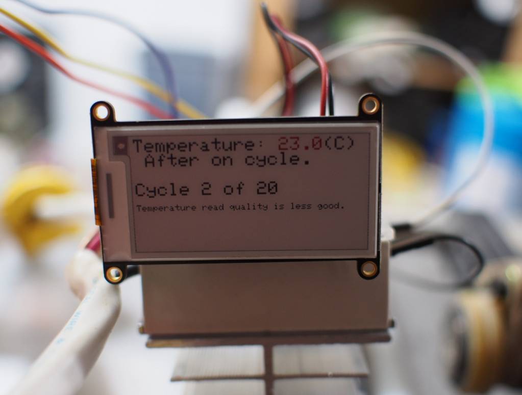

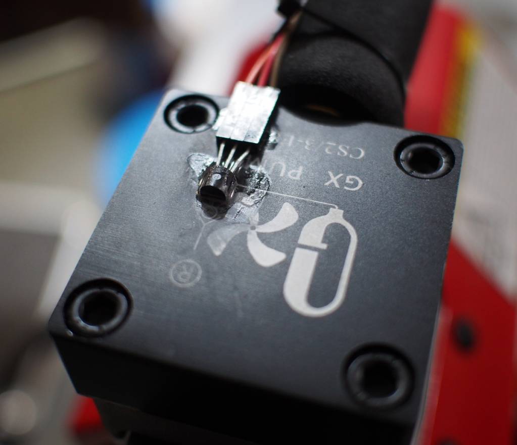

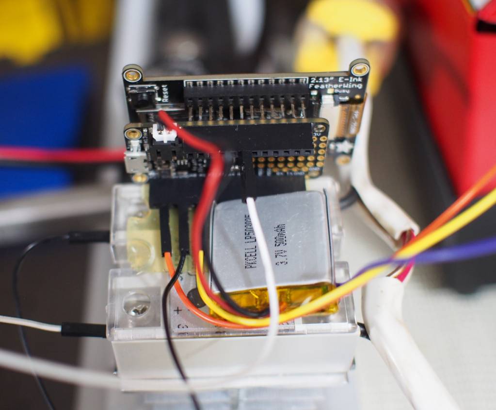

Have a check valve on order. Attached a little thermistor to the circuit, and stuck it to the compressor with thermal paste and a little glue. Also attached a little e-paper display. So now I get updates on how far into the cycle it is, as well as surface temperature readings.
Once the check valve arrives I'll put it between the pump and the air moisture filter. Will also have a little motor release the trapped pressure between cycles. But that's for another day.
Thermistor attached.
E-paper display.
Circuit is a little more complicated now.

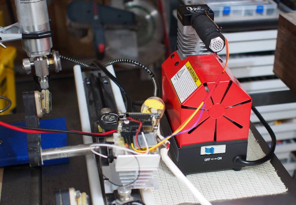

The whole setup.
Usually I would have a fan blowing over the entire unit, but my garage is pretty cold right now. Pump is only getting up to around 28c.
