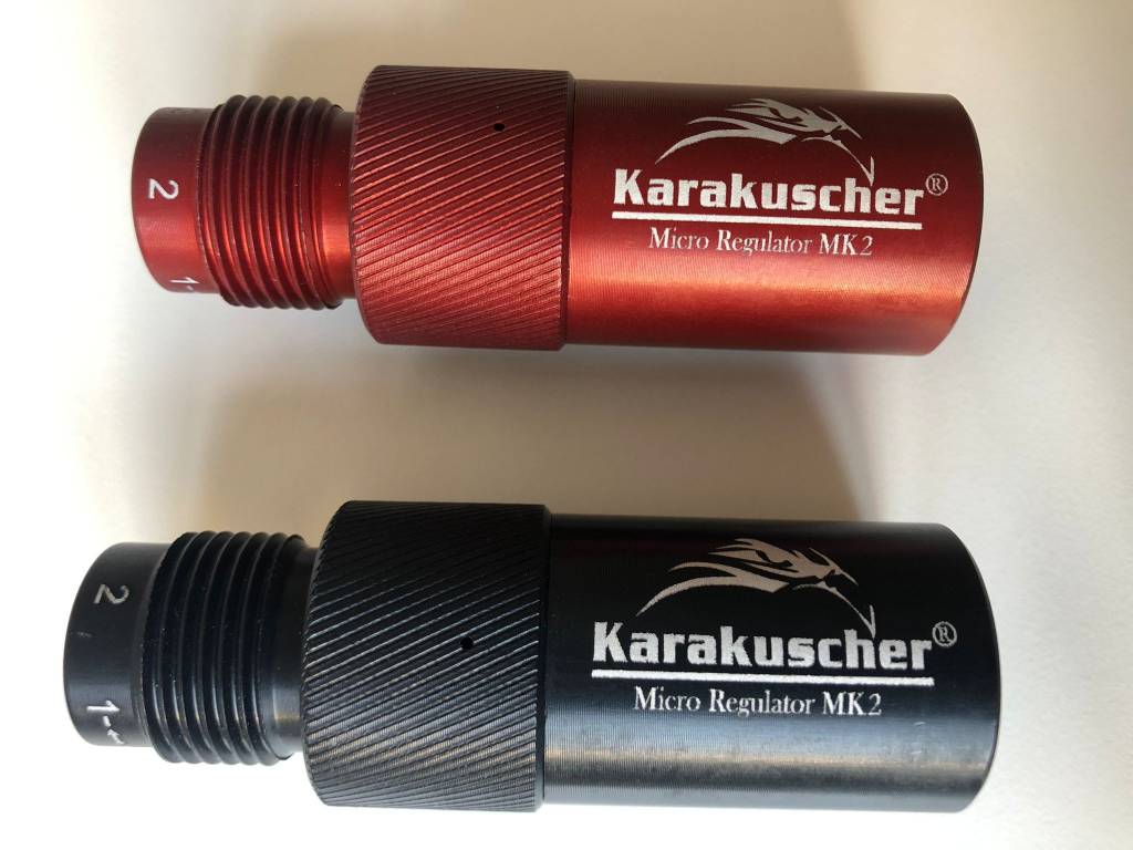

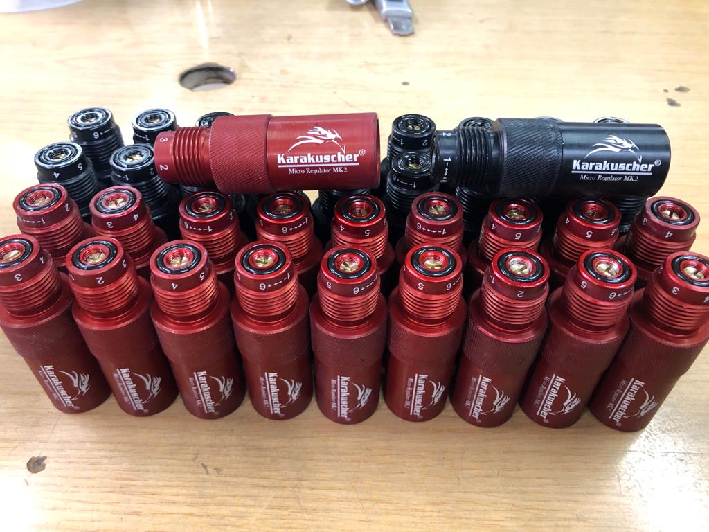

Hi, my name is Ercan, from Turkiye, I m an airgun enthusiast from 2014
I want to show you my new product “Karakuscher Micro Regulator MK2” is an external adjustable regulator for scuba cylinders.
This product is used for airgun shooters who shots on table connected pressure hose to scuba cylinder.
Product can be adjusted by user pressure range from zero to 260 bar.
Also the product can be used for safety filling airguns. It cuts the pressure at adjsuted pressure.
Designed and produced by me,
Engineering support by Doc.Dr. Rasit KARAKUS from Hacettepe University,
Machined high precicision CNC
About my regulator:
Brand: Karakuscher (registered)
Model name of product: Karakuscher Micro Regulator MK2 (Patented and registered)
Usage video:
https://youtu.be/8uApQjWw3uU
Product photos:
https://www.facebook.com/635012423301034/posts/2478054228996835

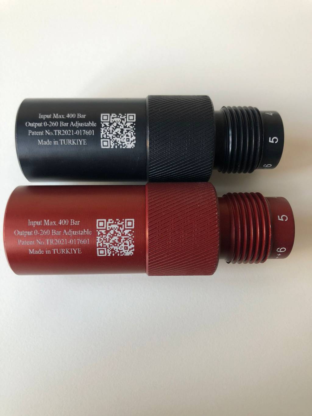

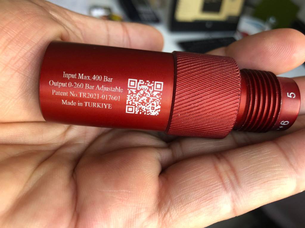

Regulator has a G5/8 din standart input and output.
Max input pressure 400 bar (tested at 450 bar)
Adjustable range between zero and 260 bar adjustable.
Main body is made from 7075 aluminium and coated 55 micron hard anodize red and black
Bellewille springs are made by German
Piston and adjusting screw is made from brass.
Lenght 83 mm
OD 30 & 28,5 mm
Weiht 114 grams
Orings 70 shore NBR
I present to end users life time warranty. (User renews the orings after 50-60 thousand shots or 5 years.)
Product comes in a velvet pouch.

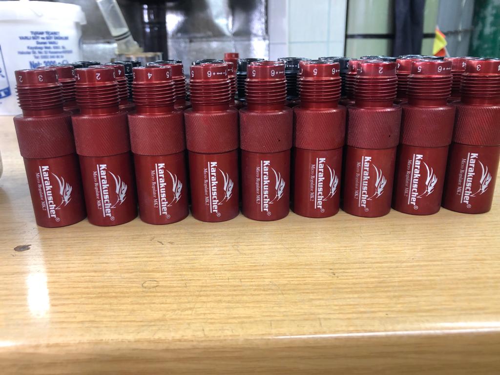

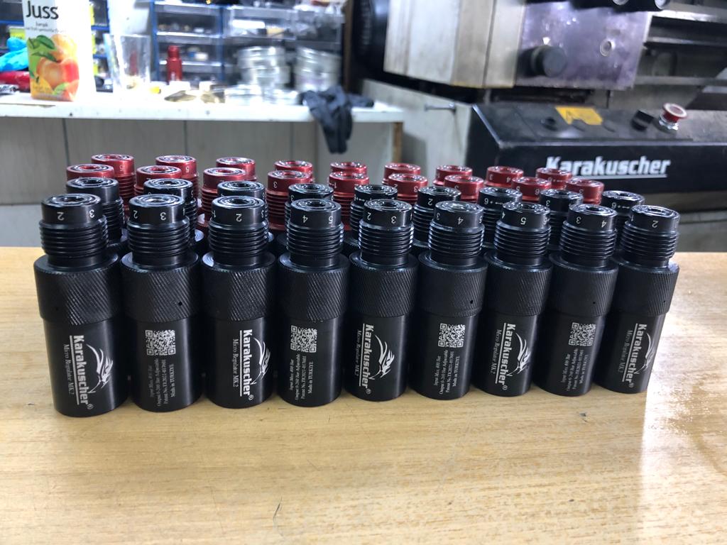

Monthly production capacity max 1.000 pieces
