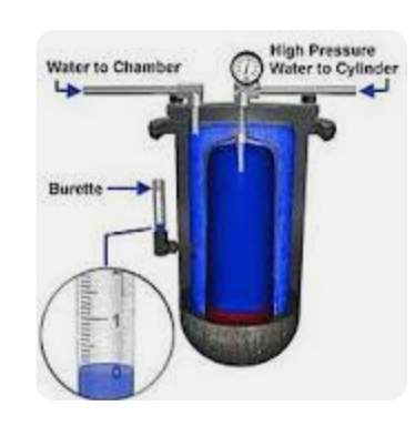

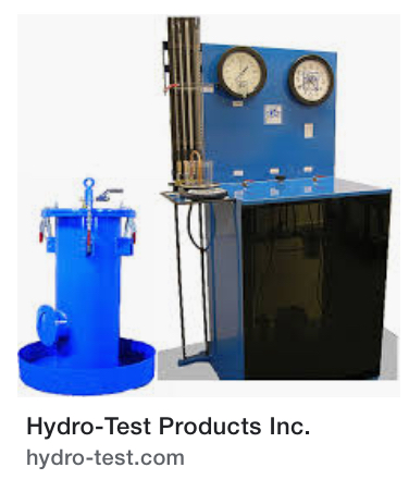

Actually, failure during hydro is not explosive. The tank being tested is completely filled with water and connected to a high pressure water pump. Then it is lowered into another tank also filled with water and a lid seals everything up. The pressure in the tank being tested is raised to the DOT specified pressure. The test ank expands some and causes the water in the other tank. The water that is displaced by the test tanks expansion goes up a glass tube called a burette. The burette is calibrated with graduations. The high water mark is noted and then the water pressure is released and the water level is noted again in the burette. The DOT specifies what the difference in the two readings can be. If the water line drops very little it means the test tank didn’t return to its original size or the acceptable expansion.
In the event that a tank splits open, the water from the test tank merely squirts into the outer vessels water.
First picture is commercial hydro tester for tanks up to about size of common scuba tank. Second picture is illustration of test set up.
