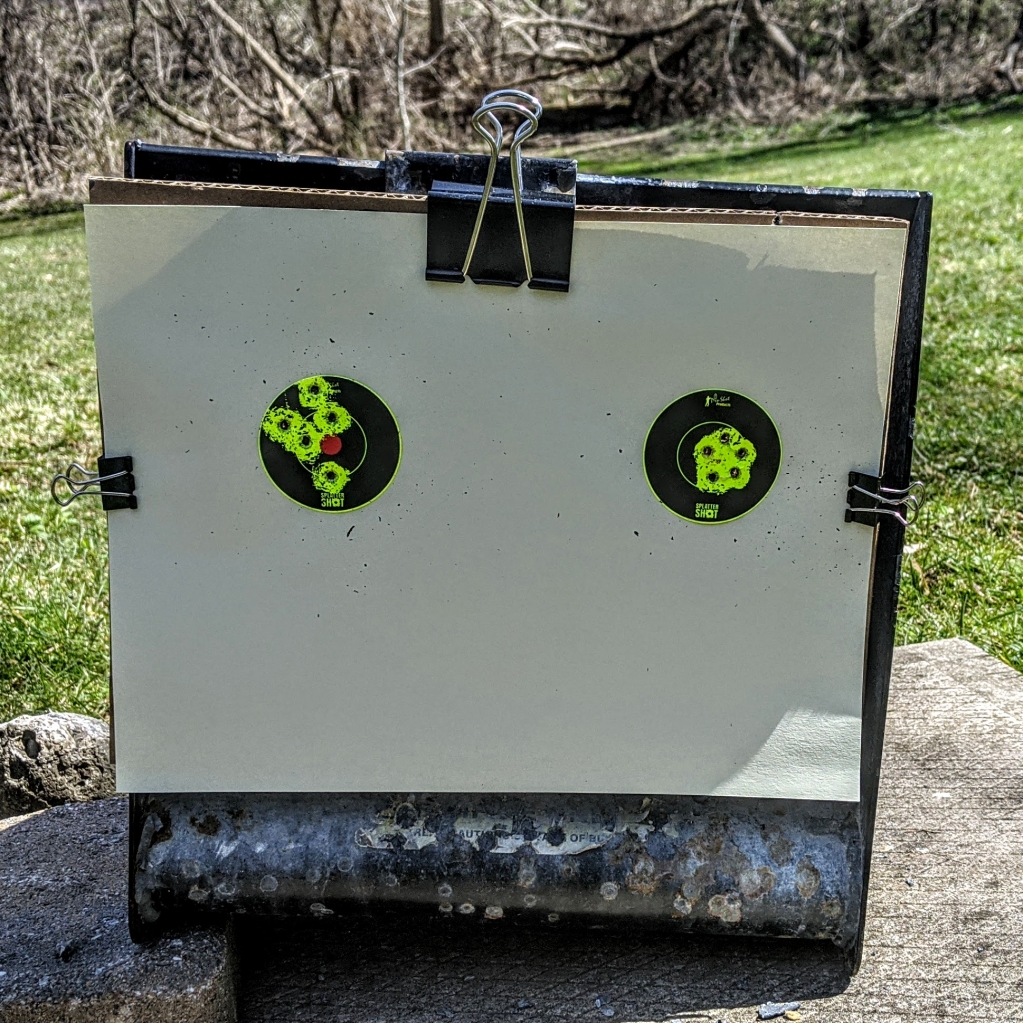

Howdy, I recently bought a used diana 54 that came with a very nice williams peep sight and interchangeable front inserts. I'm 49 and wear glasses with progressive lenses (so I can say that my vision is poor at distance and now up close too). This is my first time owning a gun with peeps and I have had an absolute blast shooting with them. I find a 2 inch target a good challenge in the 20-ish yard range. Here's a target where I was changing between a post front sight and aperture front sight (gun was rested).

Oh, I should also give you a better pic of what I'm aiming at so you have some context. It's a typical bullet box:
