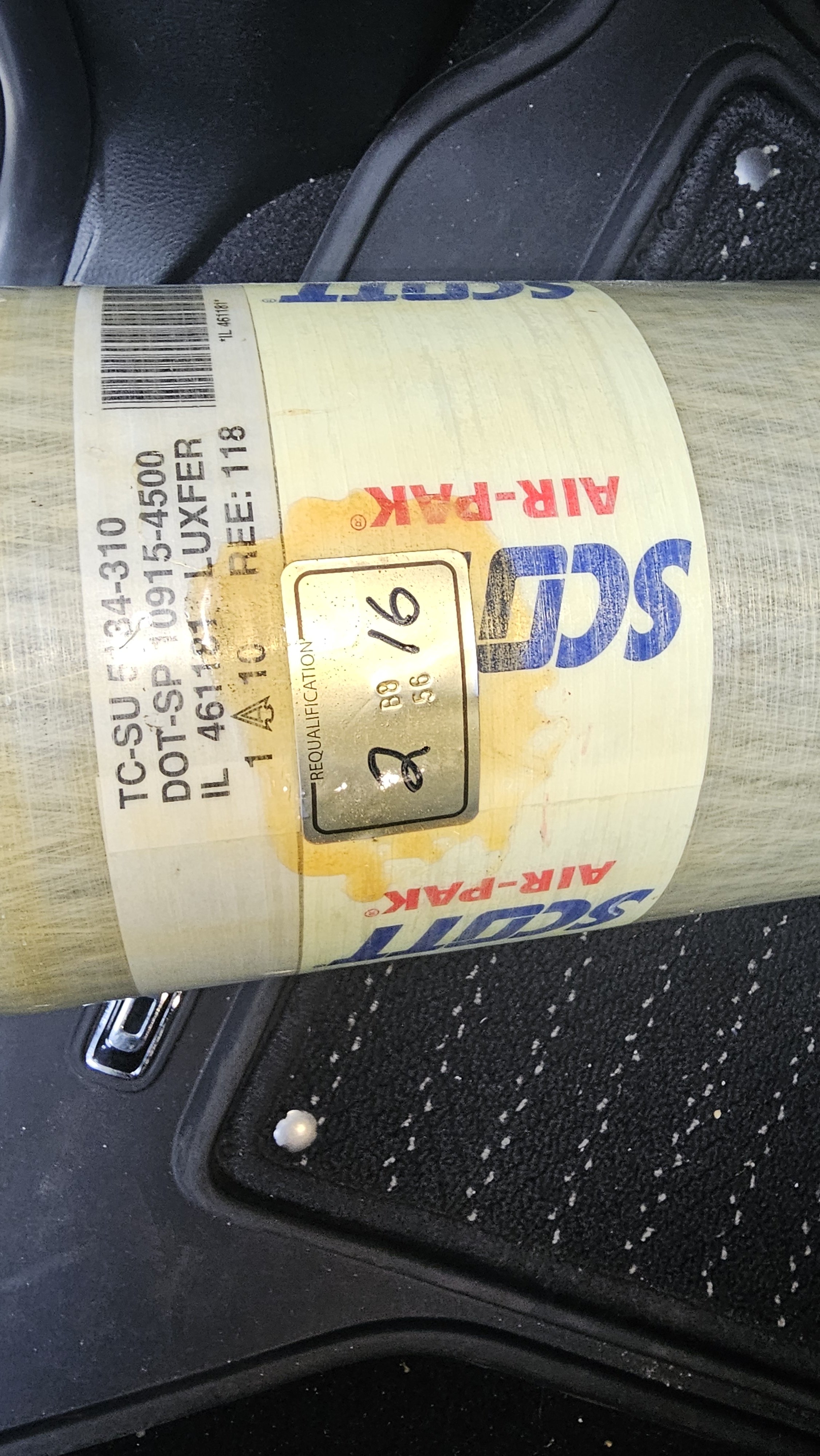

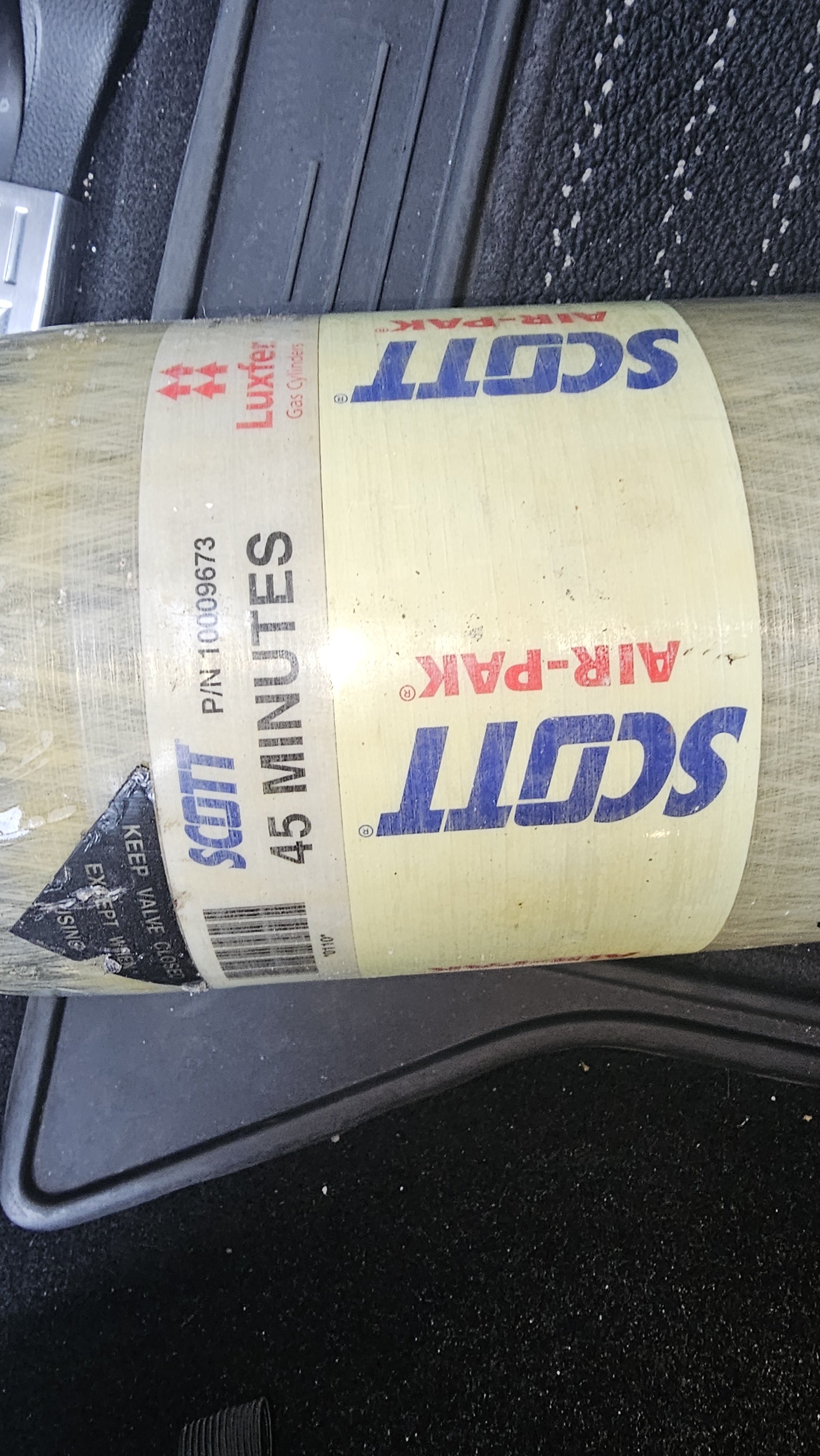

If you search for it you may be able to find the pictures of tanks damaged from overpressure. They were posted here, not by me. The metal tank did pretty much "explode" and was not at a huge overpressure. The carbon fiber wrapped tank had a big chunk of the carbon fiber removed and still "failed" at a huge overpressure. Did not "explode" and fragment all over the place. I wish I knew that level of margin was in all carbon fiber reinforced tanks but I am pretty confident in my Scott tank. Carbon fiber tanks have aluminum on the inside to contain the air and carbon fiber to withstand the pressure (force) from the air. If the liner starts to leak - fails - the carbon fiber should still keep it from fragmenting and/or keep any fragments contained. The carbon fiber will not contain the air.
Aluminum and steel tanks use the metal both to contain the pressurized air and to withstand the force from the pressure. For them to leak there has to be damage or degradation that penetrates the metal and the degradation may expand rapidly resulting in fragmentation and there is nothing in the tank design that would contain it.
I am more confident in my expired Scott tank won't hurt me than I am the aluminum airtubes in all 6 of my airguns won't hurt me. But I don't really worry about them either. My Air Maks Caiman is the only one that says what it was tested to and it is 450 bar. My other 5 came from China but I still do not think they are going to explode.
