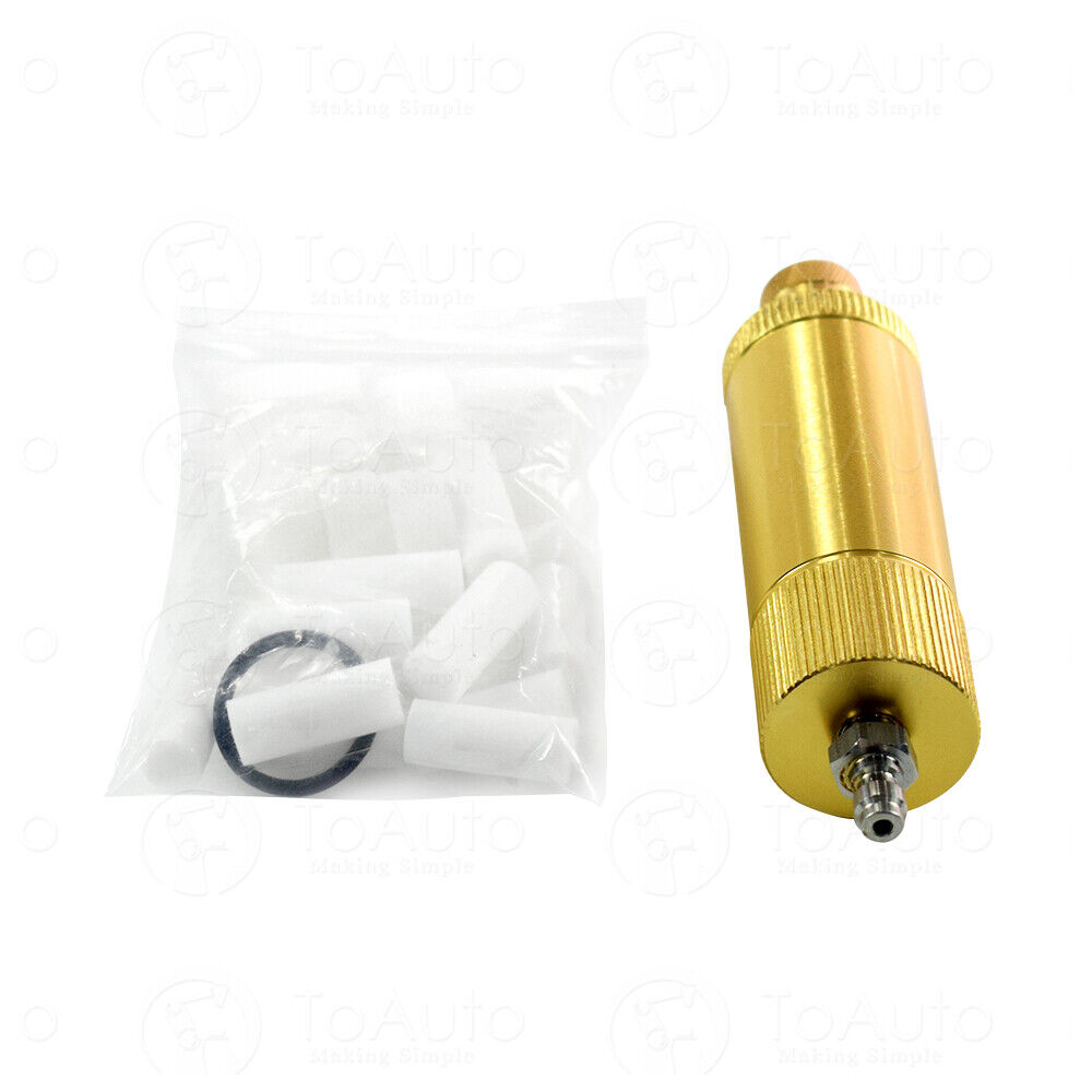

I have a GX CS3 which is the same compressor but without the rechargeable batteries. The water trap is very efficient. As a telltale I added a small inline water trap as well. So far the cotton in the second trap has never shown visible signs of moisture. After filling three guns in a row at about 35% RH, I took the cotton out of the external water trap and checked for water in it and could not discern any moisture at all on the filter, which leads me to believe that the built in water trap is doing its job well. I drain the built in water trap it every 5-8 minutes during higher humidity days, and only after a 15 minute fill on dry days. It has been about 6 months now with no moisture ever showing up in the 2nd water trap.
Hooking up a huge water trap is pointless with this setup in my view. I tried one just as a test and it more than doubles the fill time for a 500 cc bottle, sometimes even taking 10+ times longer to fill smaller bottle / cylinder guns, with no added benefits that I can see. I routinely fill to 250 BAR in the field. I usually stop at about 4300-4350 PSI on my 4500 PSI gun. Taking it to 4500 PSI takes too long and the increase on shot count isn't that much.
