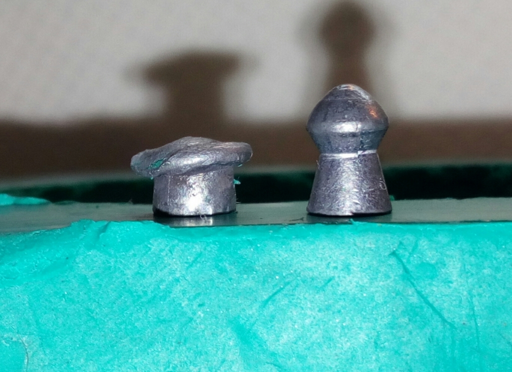

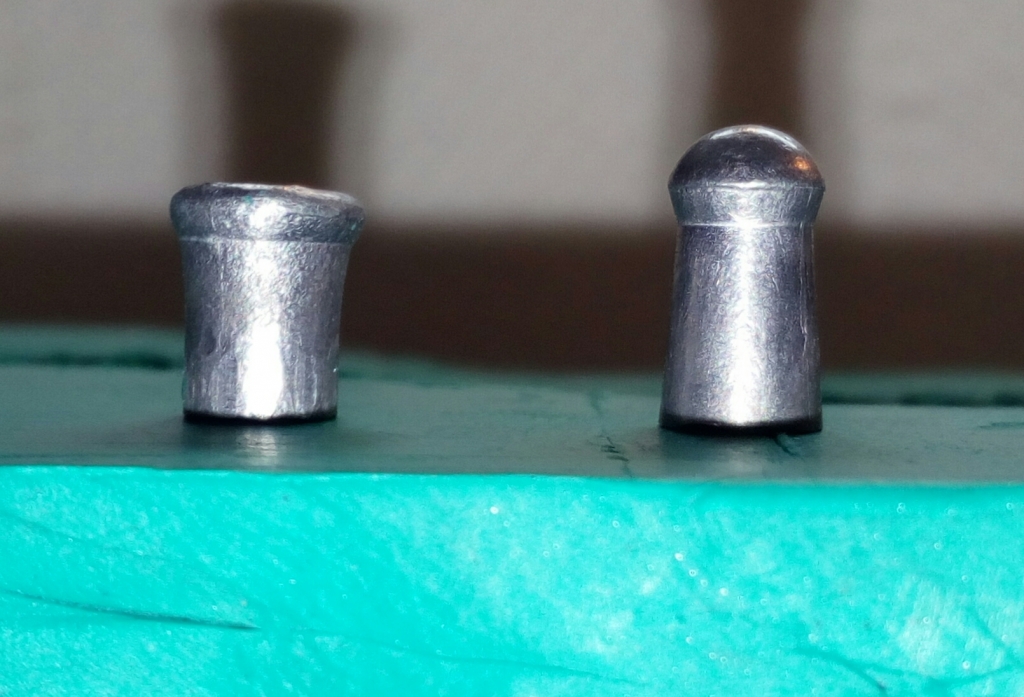

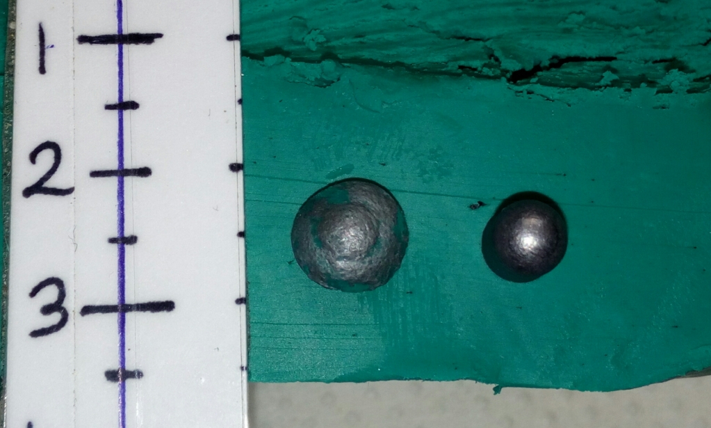

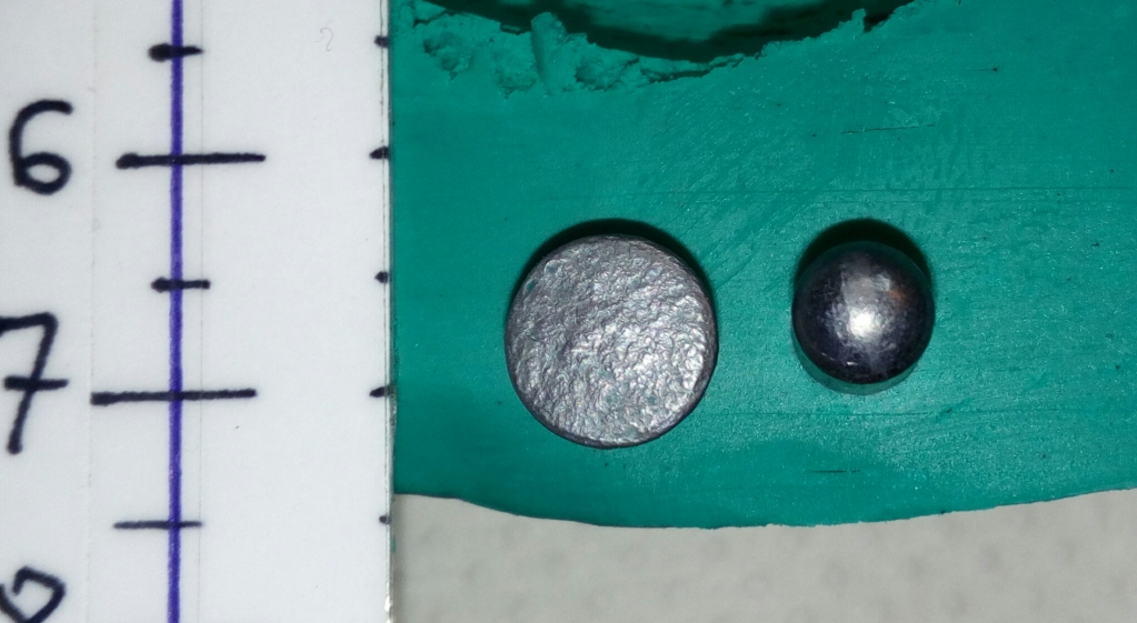

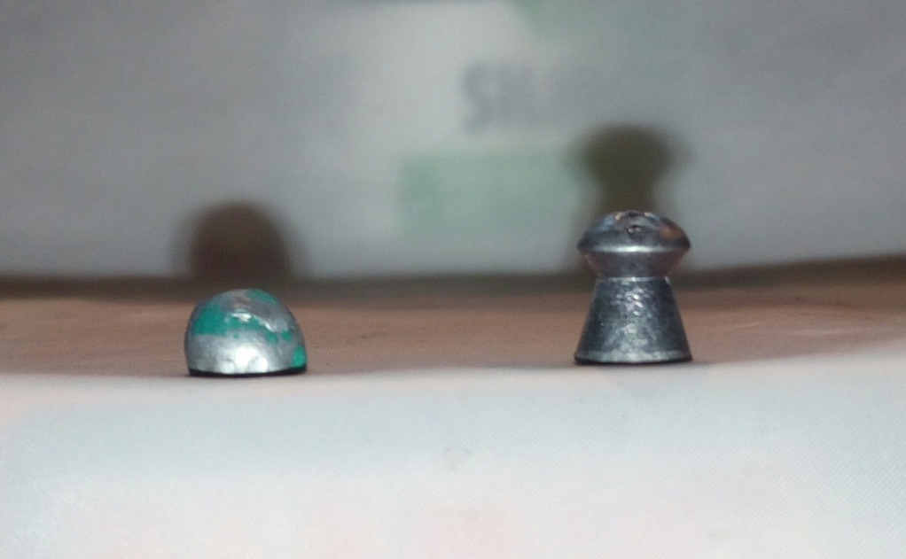

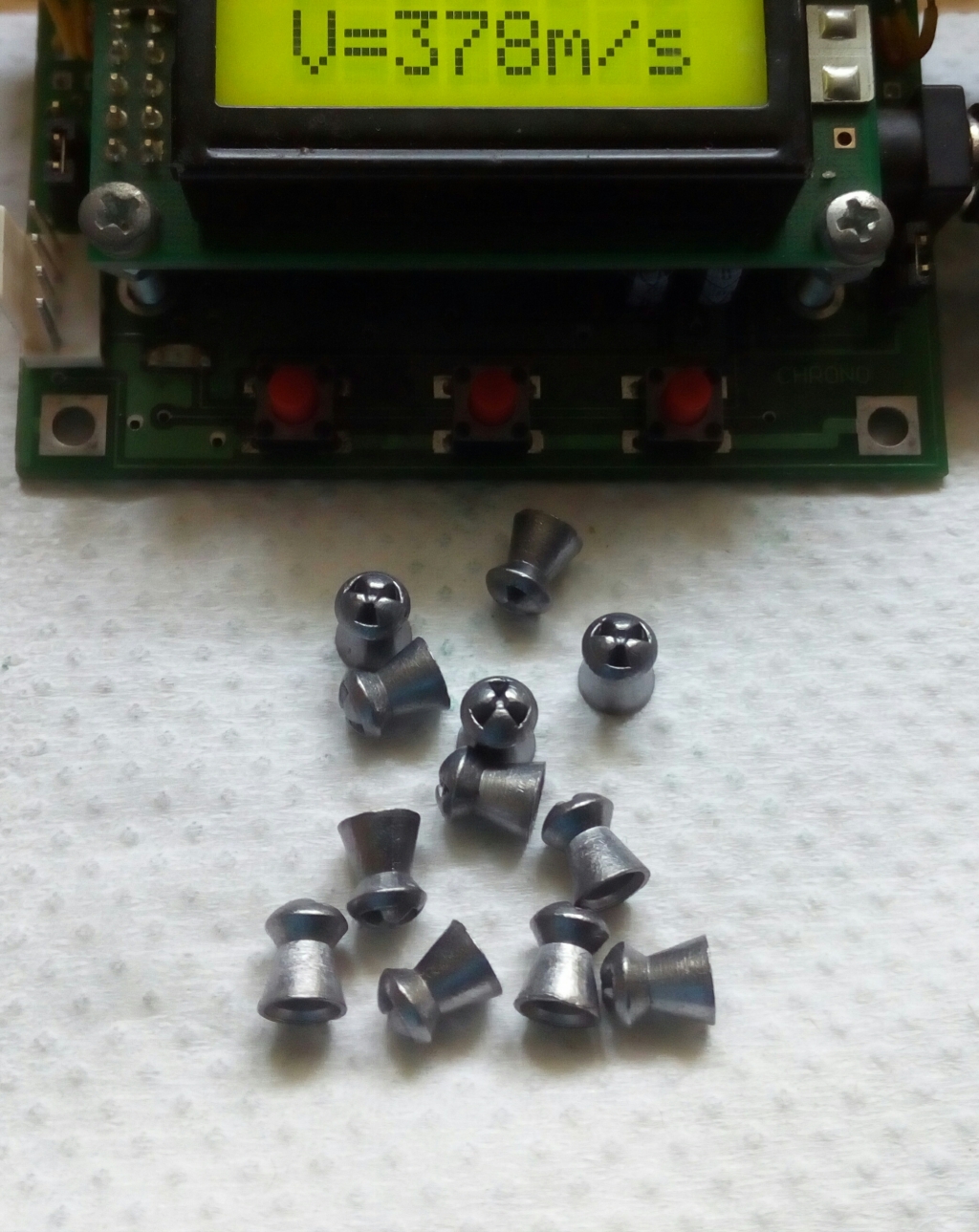

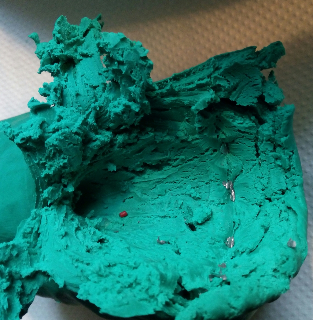

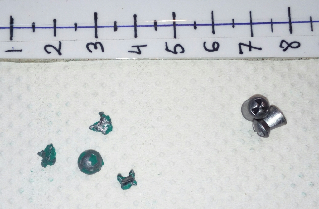

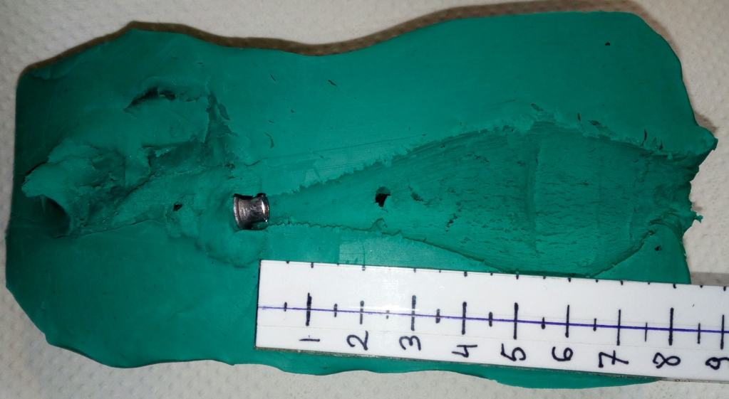

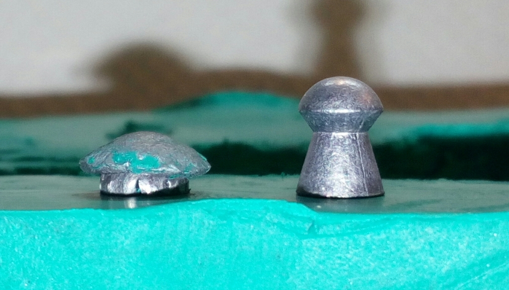

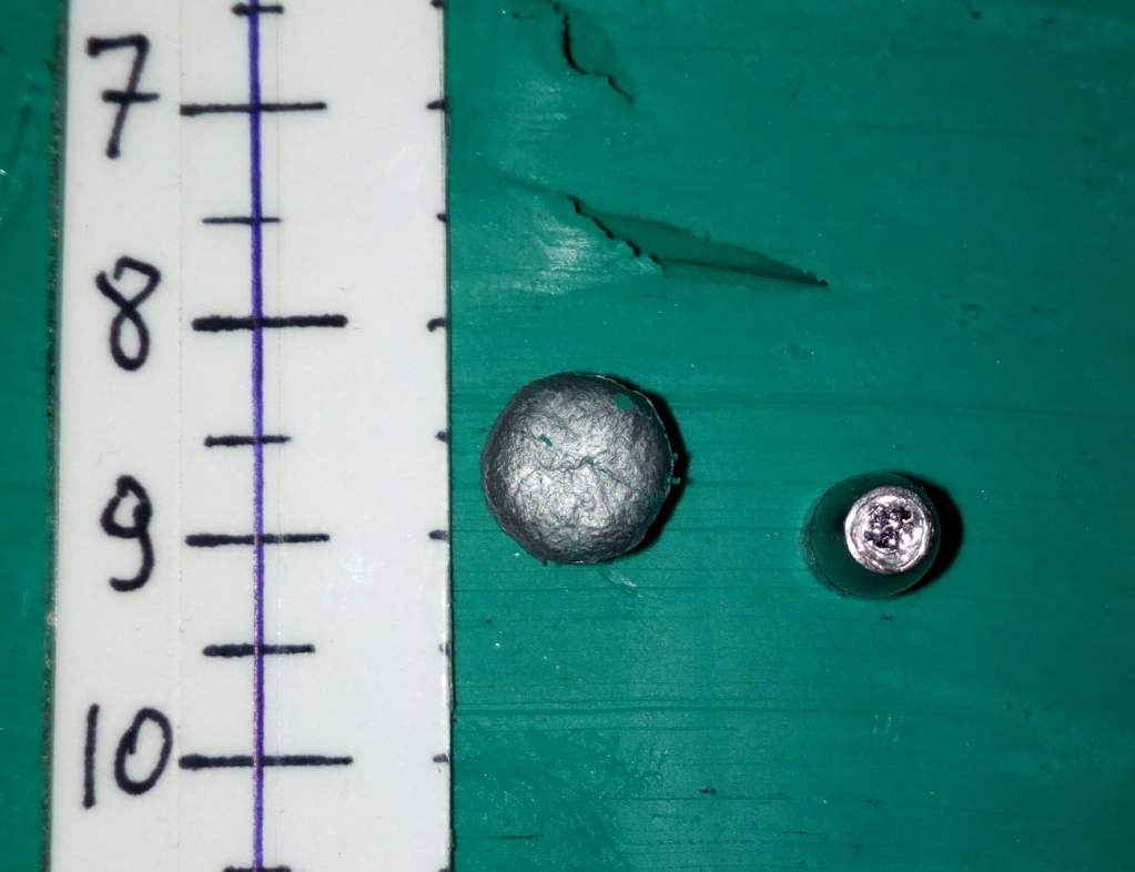

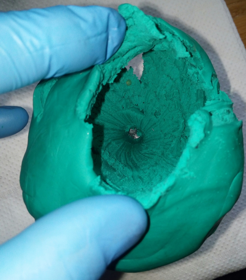

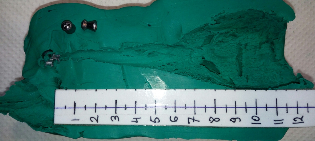

Expansion test .22 pellets and slugs

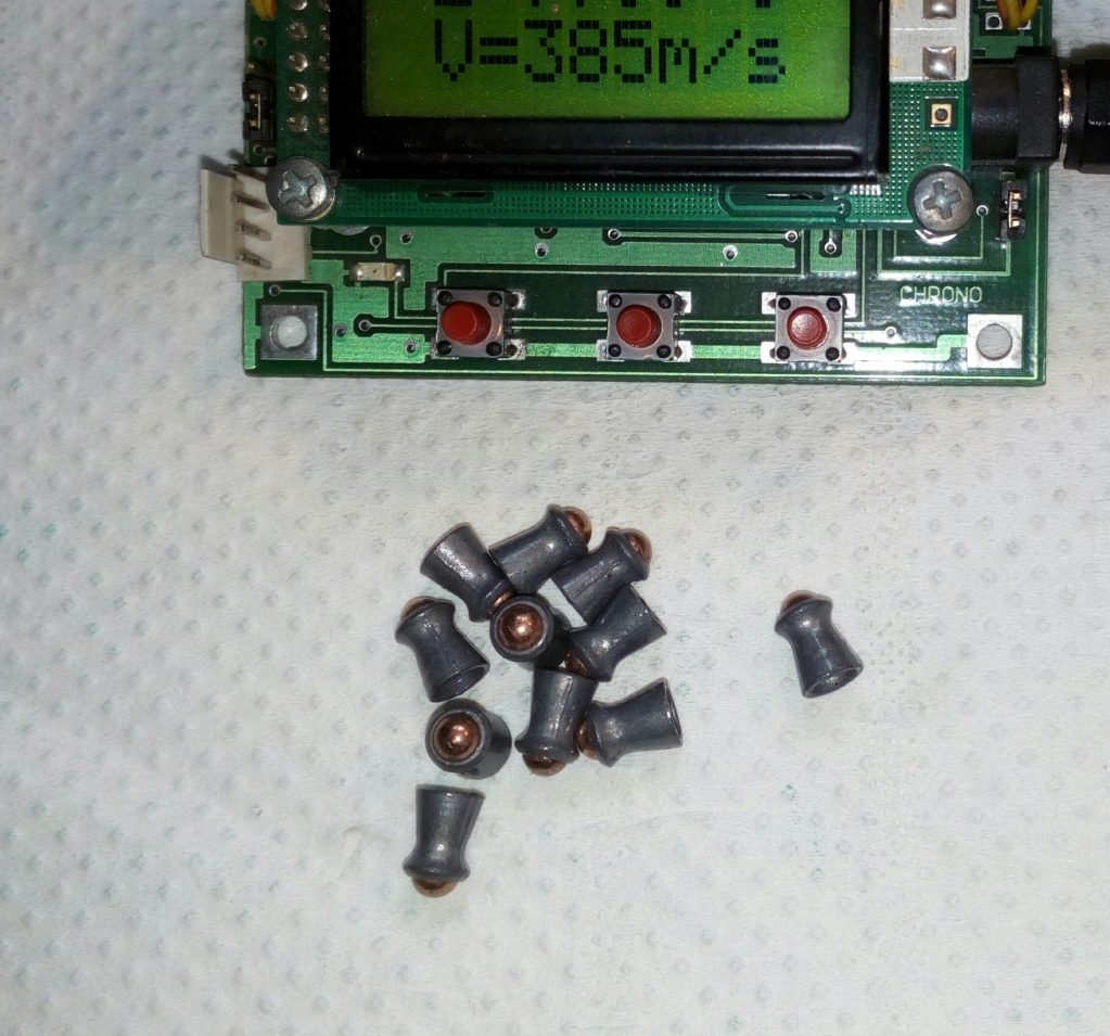

.22 Gamo Rocket 0.95g v0 385m/s (1263 fps)
.22 JSB Hades 1.03g v0 378m/s (1240 fps)
.22 Predator Polymag 1.04g v0 380m/s (1246 fps)
.22 JSB Jumbo Heavy 1.175g v0 374m/s (1227 fps)
.22 H&N Baracuda 1.37g v0 354m/s (1161 fps)
.22 JSB Jumbo Monster Redesigned 1.64g v0 > 330m/s (1082 fps)
.22 JSB Jumbo Beast 2.2g v0 > 290m/s (950 fps)

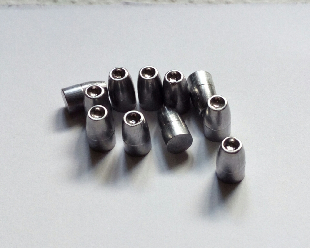

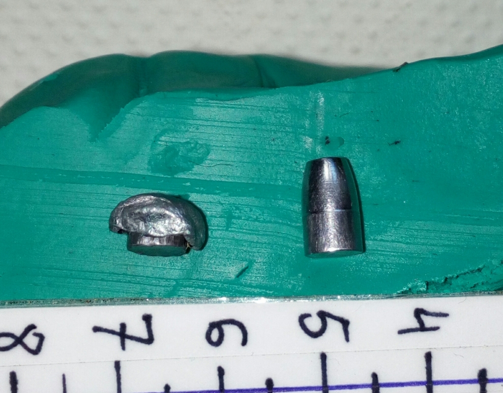

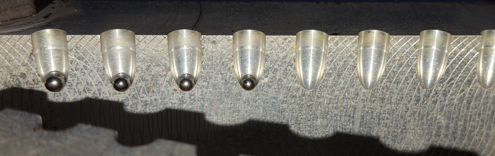

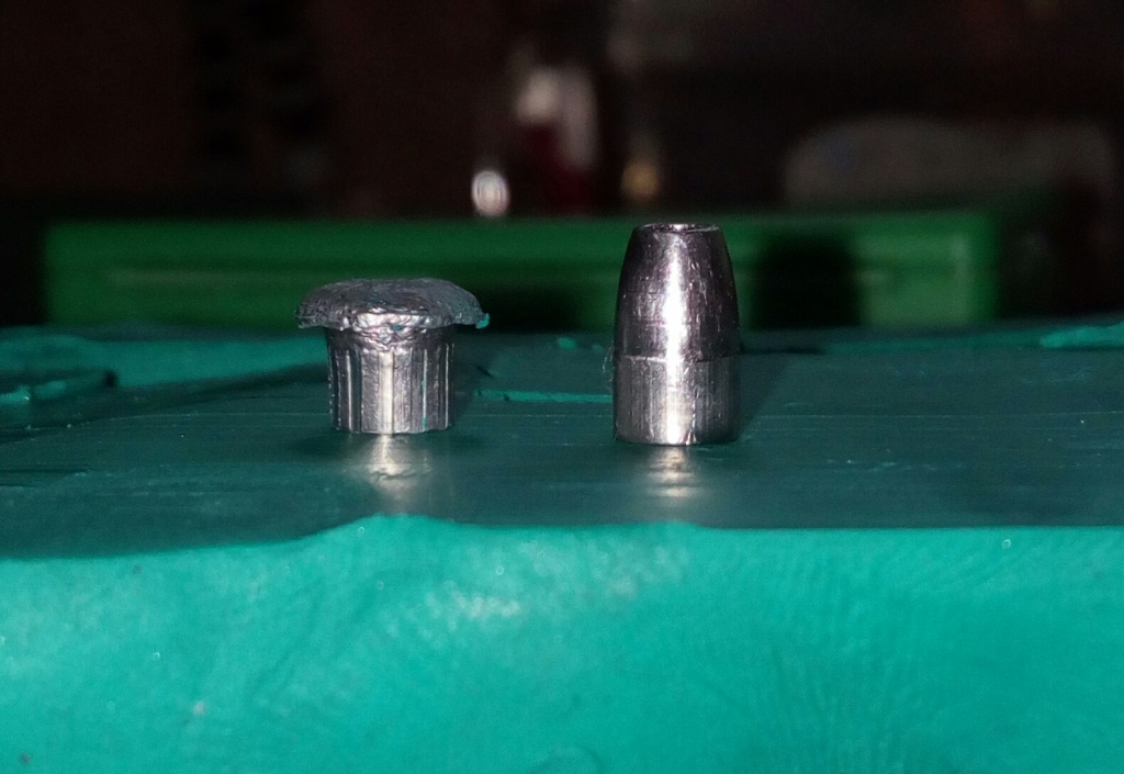

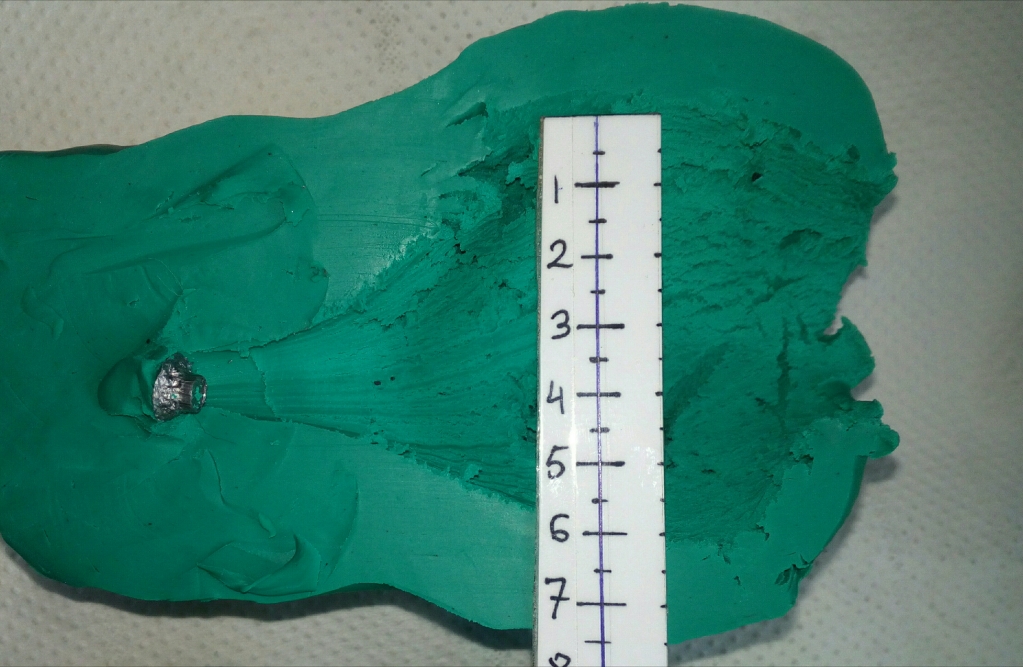

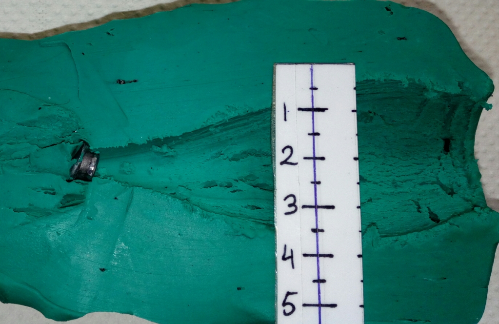

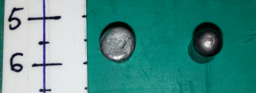

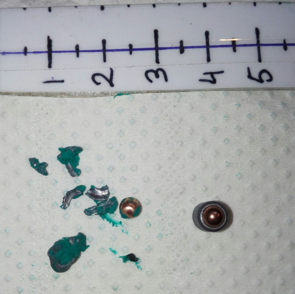

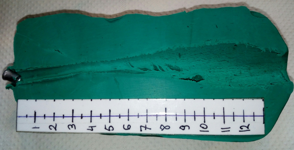

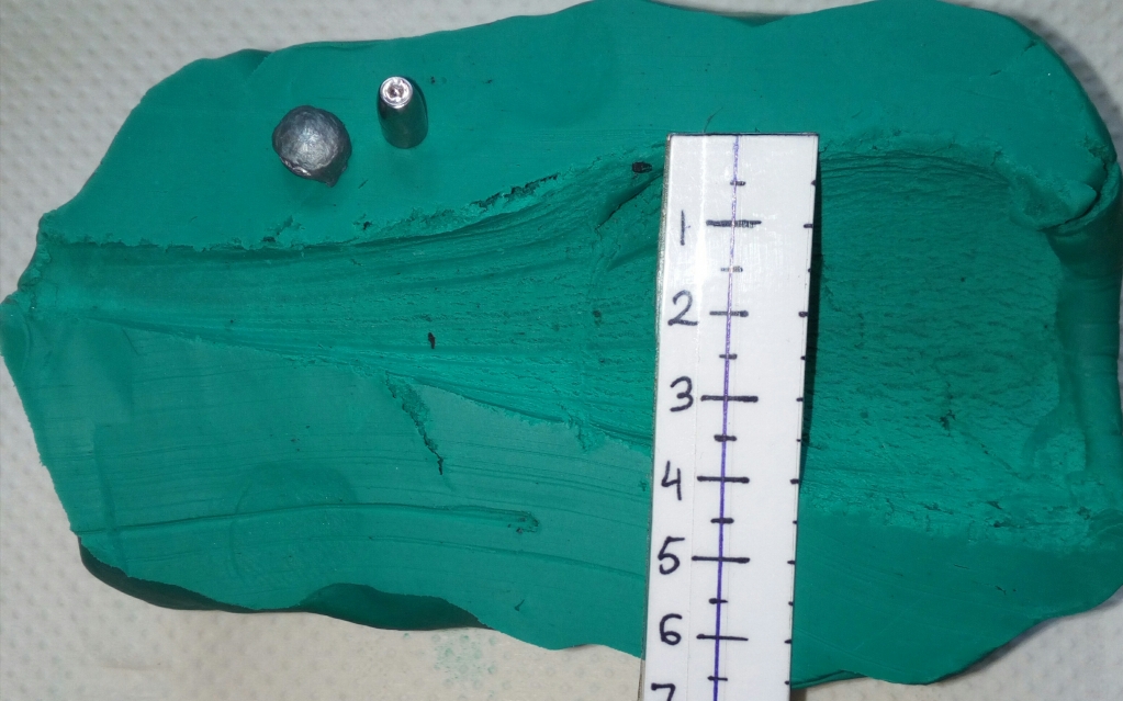

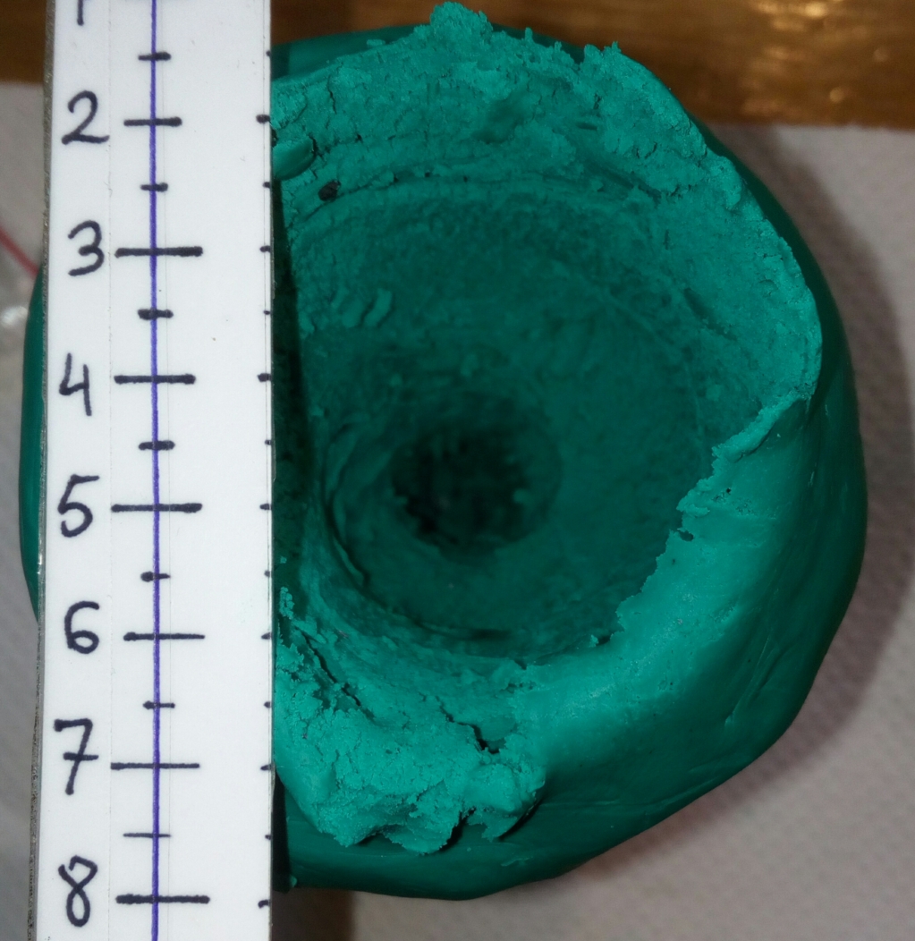

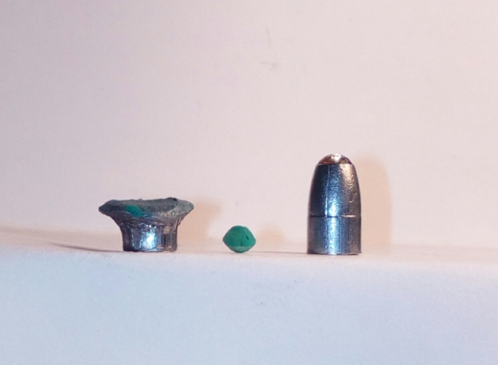

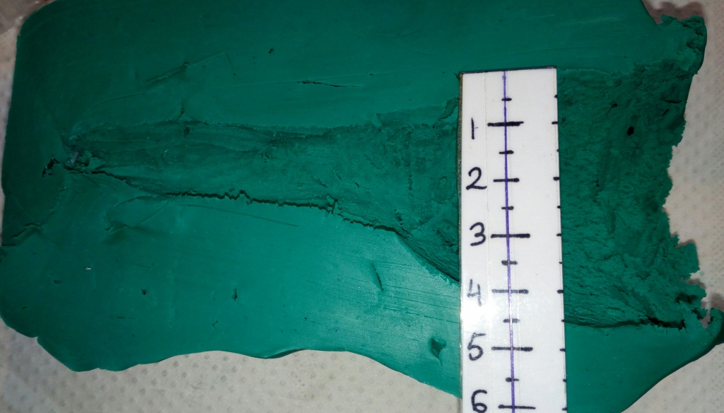

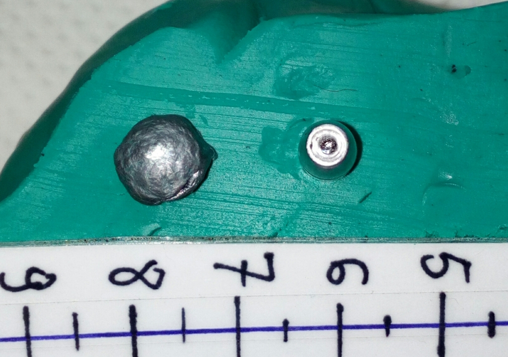

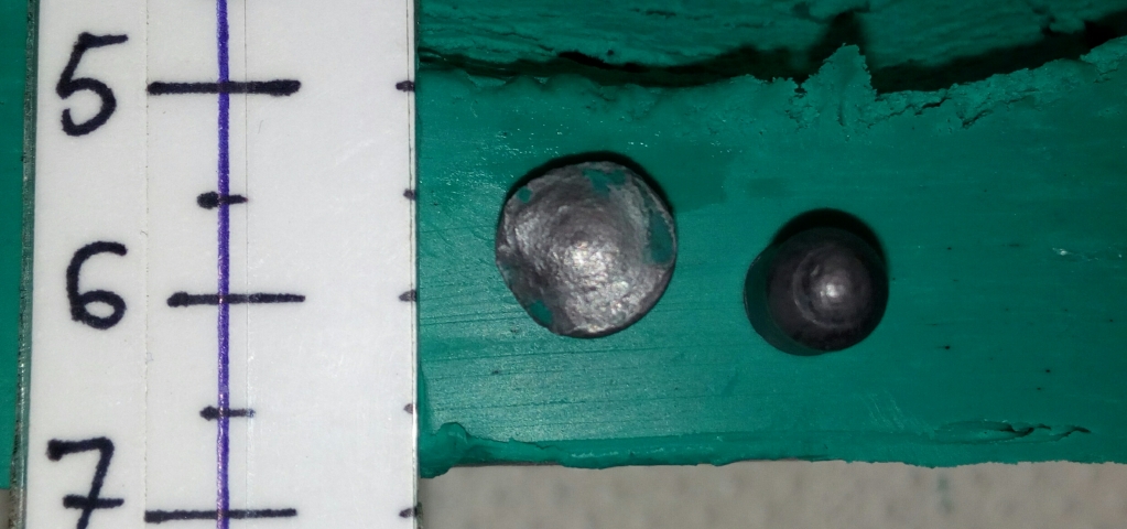

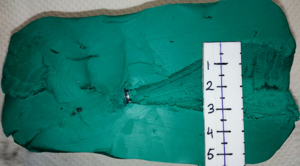

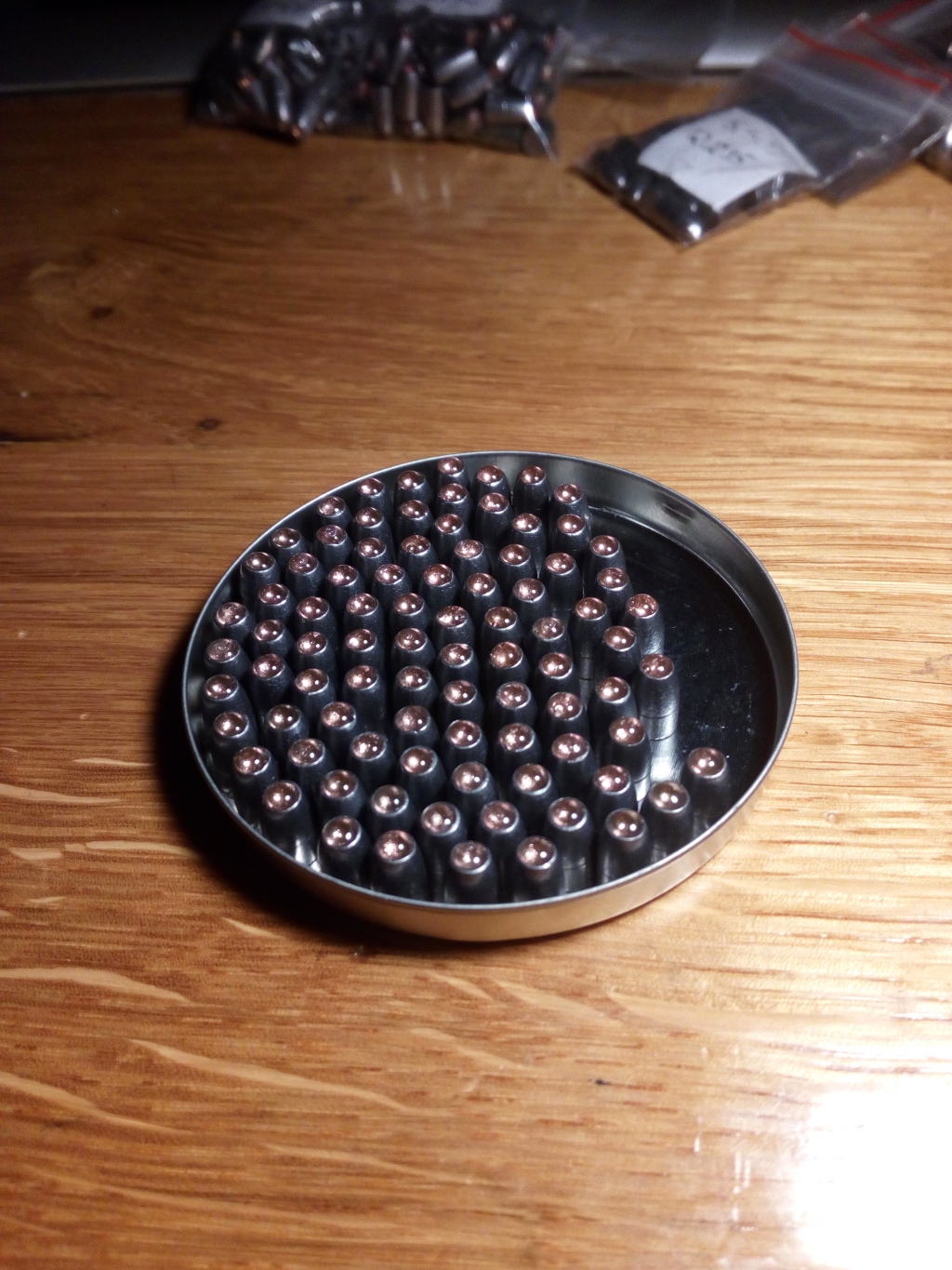

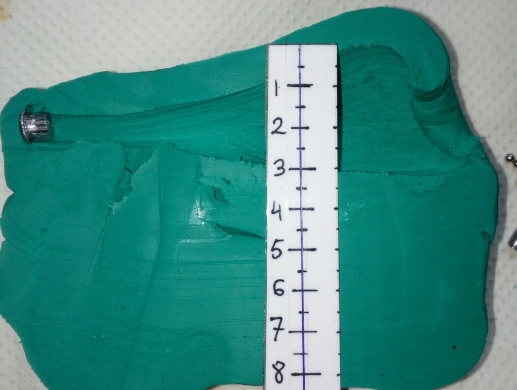

Cast .22 HP slugs. Weight 2.0, 2.05 and 2.1 grams (depending on the diameter of the used ball)

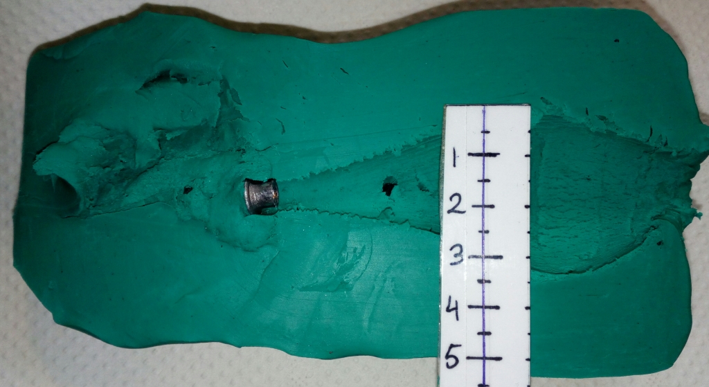

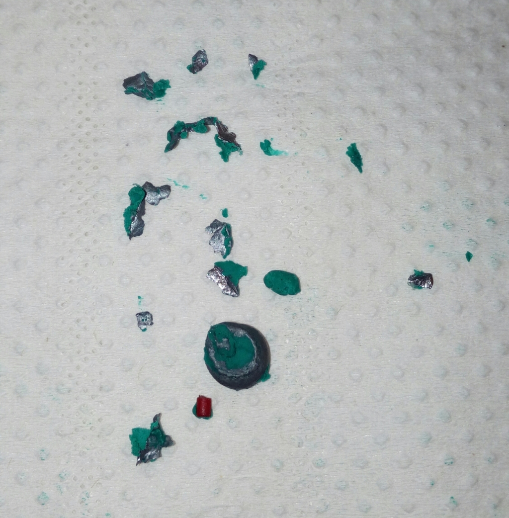

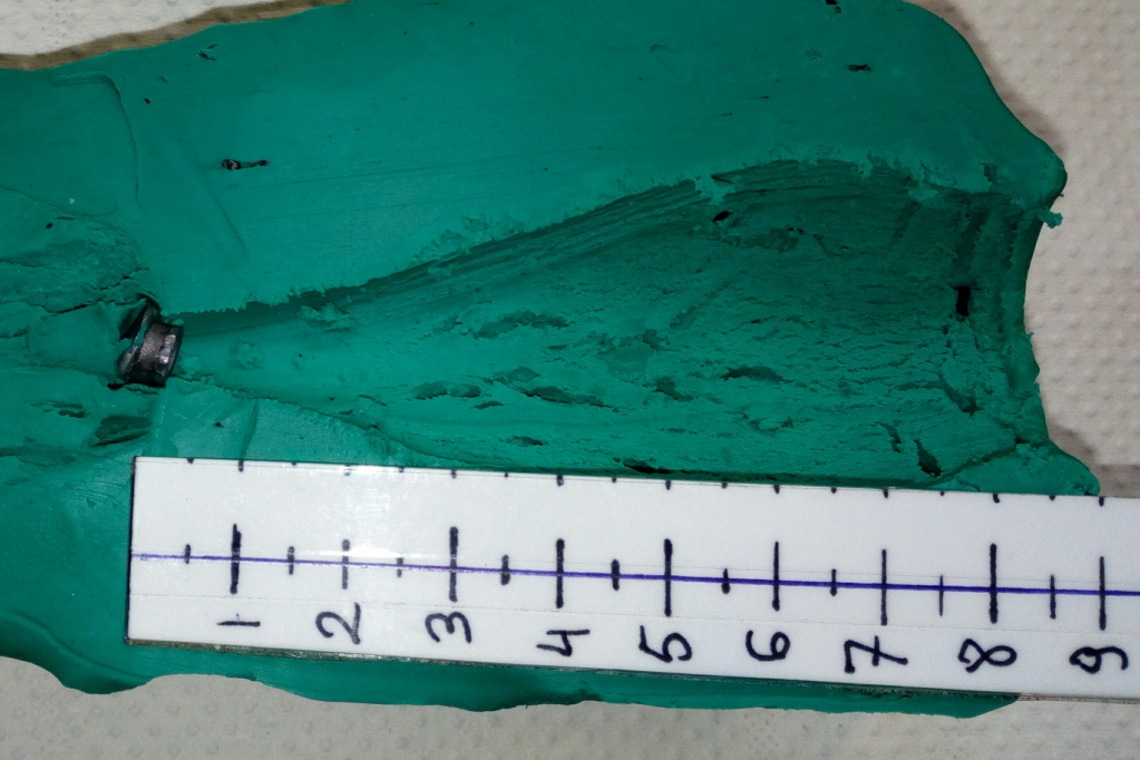

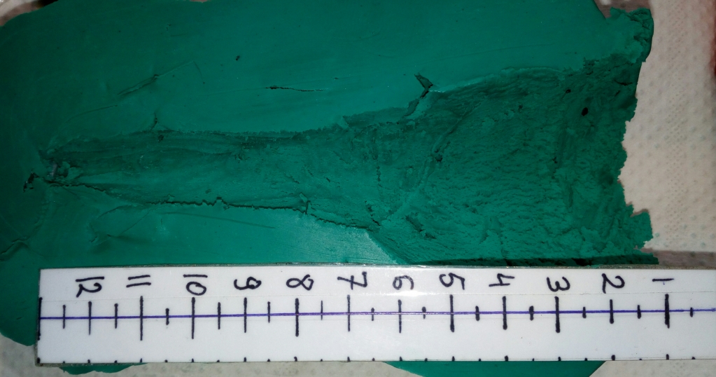

Expansion at speed 315m/s (1022 fps)
Expansion at low speed. 220m/s (721 fps)

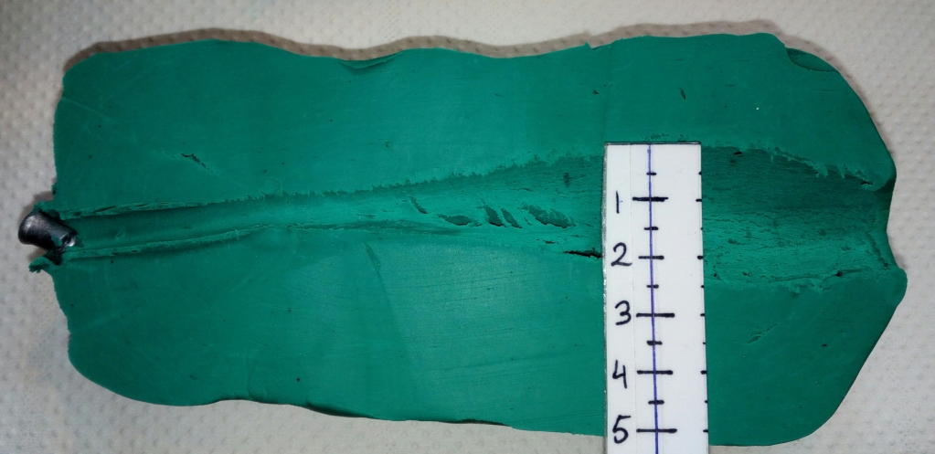

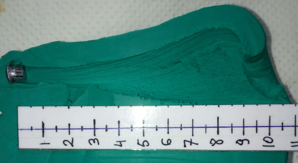

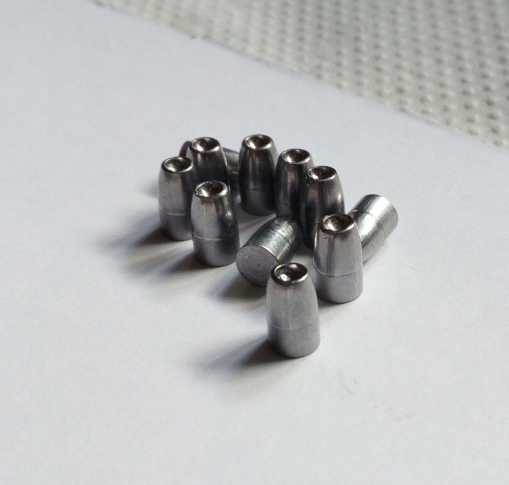

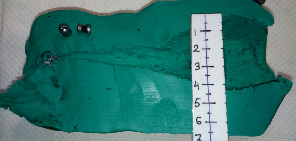

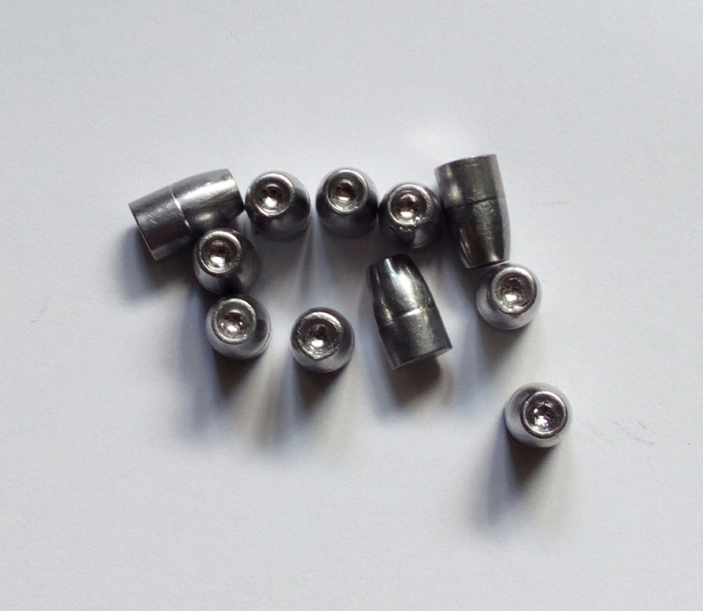

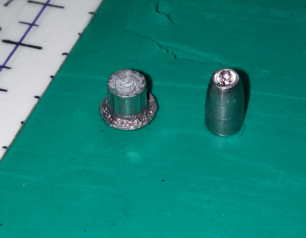

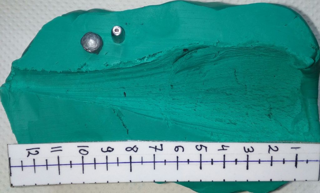

Cast .22 B-Tip slugs. Weight 2.0, 2.05 and 2.1 grams (depending on the diameter of the used ball)
Expansion at speed 315m/s (1033 fps)

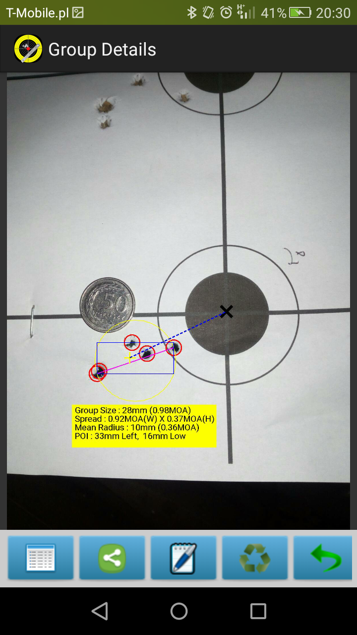

My rapid is set to 75+ ftlbs on 34-36 grain slugs, and shoots accurately from them.
The test of light pellets was just by the way, and I do not intend to shoot them with this energy.
Only JSB Monster Redesigned works decently at 100m, but that it is supersonic and already loud.

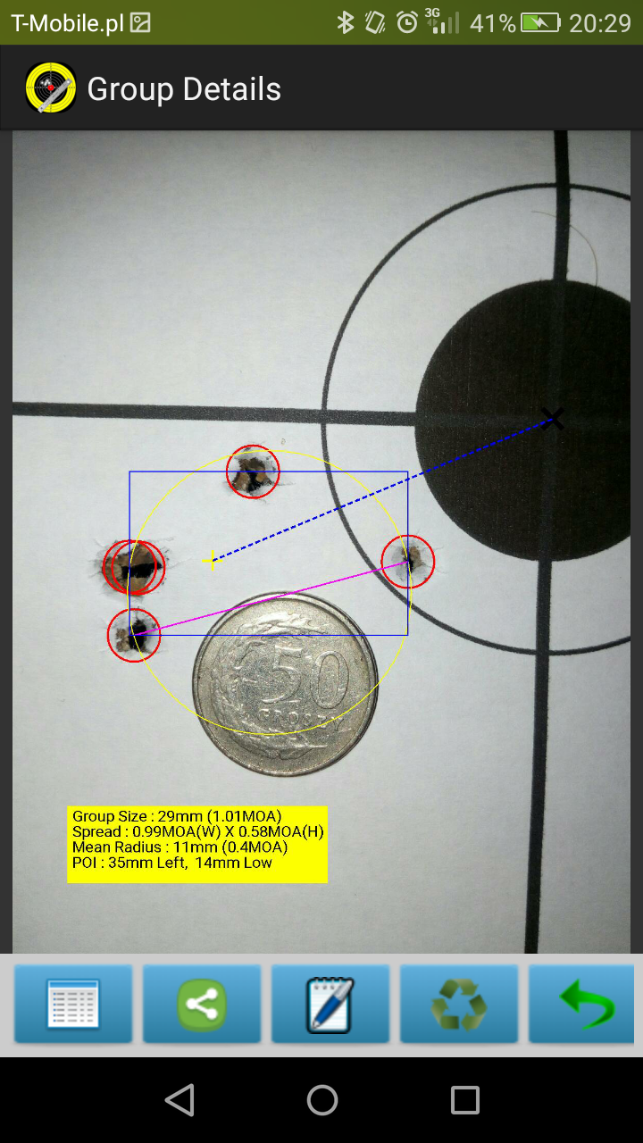

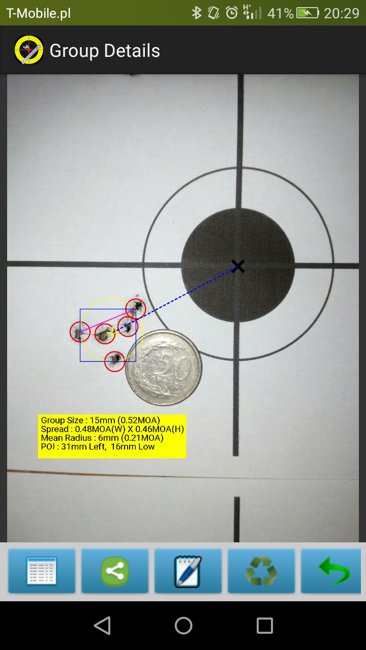

The top 4 groups on 101 meters of my 35.4 grain slugs.

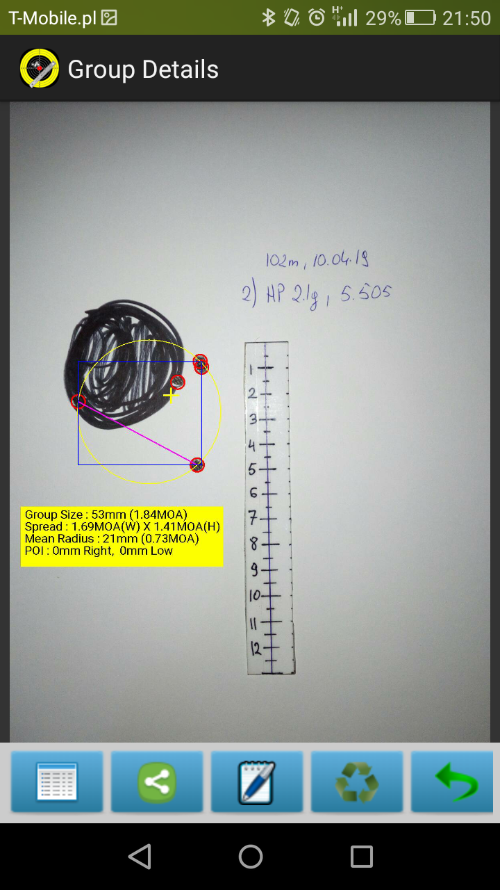

And 2 groups on 102 meters from my 2.1 grams HP slugs.
very nice groups warchlaq
I'm curious what moulds you use to cast your 30 and 36 grein slugs
thanks
I use mold from MP Molds, version 1.
In my opinion this shape of the slugs is better than the version 2, my BSA barrel in Theoben Rapid loves these slugs.
For the production of lighter HP Slugs I use steel balls in 4 diameters, 3.5mm 3.175mm 3.0mm and 2.275mm.
