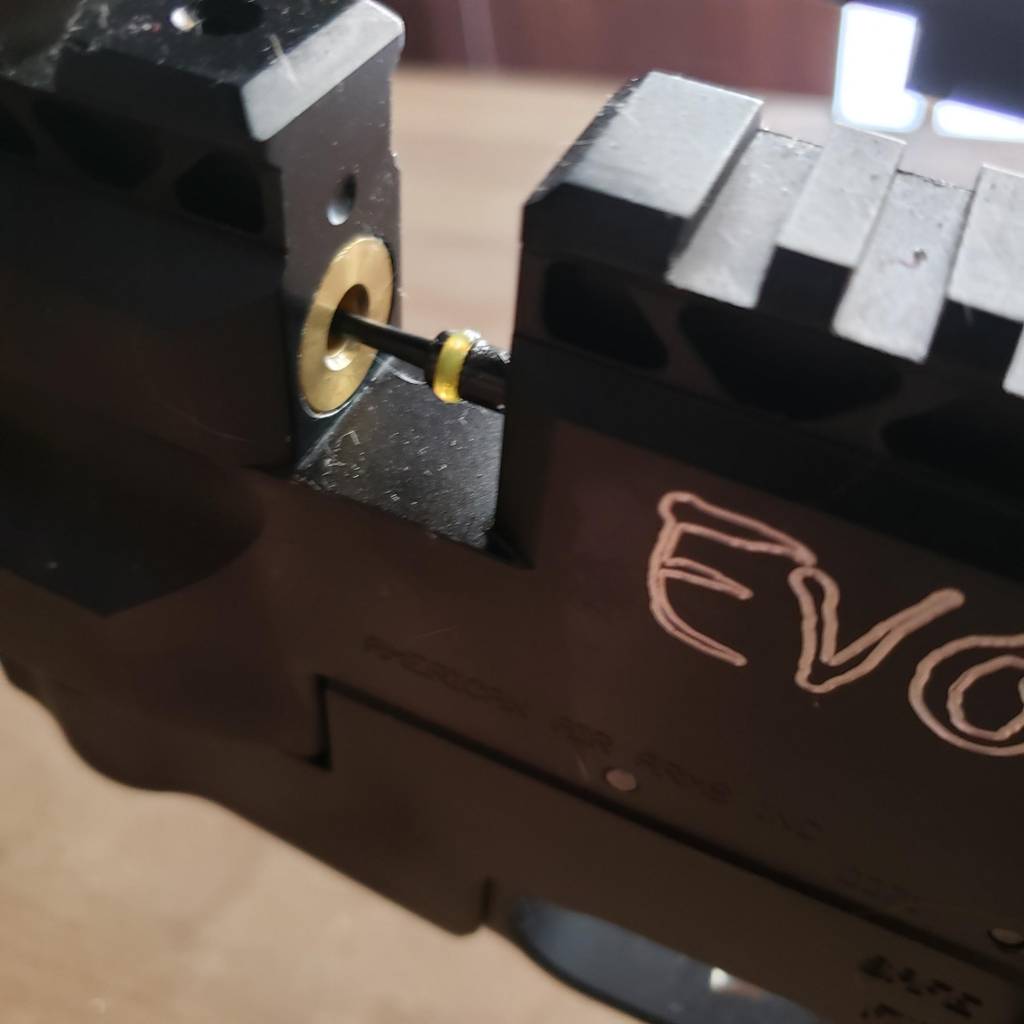

Brand new gun from AOA, got it home and air leak at breach; no o ring on probe. AOA trying to help but one guy says that gun has a breech o ring, another says he’s not sure. They are sending me an o ring by mail but I’d like to go to Grainger and buy one today so I can shoot.

Here is a pic. I'm sure you could pick one up at a hardware store, or even a radio controlled car shop. I did take a look at my o-ring sets from harbor freight. Looks like those will work as well. In any case you should be able to replace it rather easy. Downside is your going to buy a pack or few of rings on your quest.
These are actually urethane molded O-rings with a different compound. It is actually harder and more durable than a regular Buna o-ring that you will get from any hardware store.
Buy them from theoringstore.com link I provided above.
