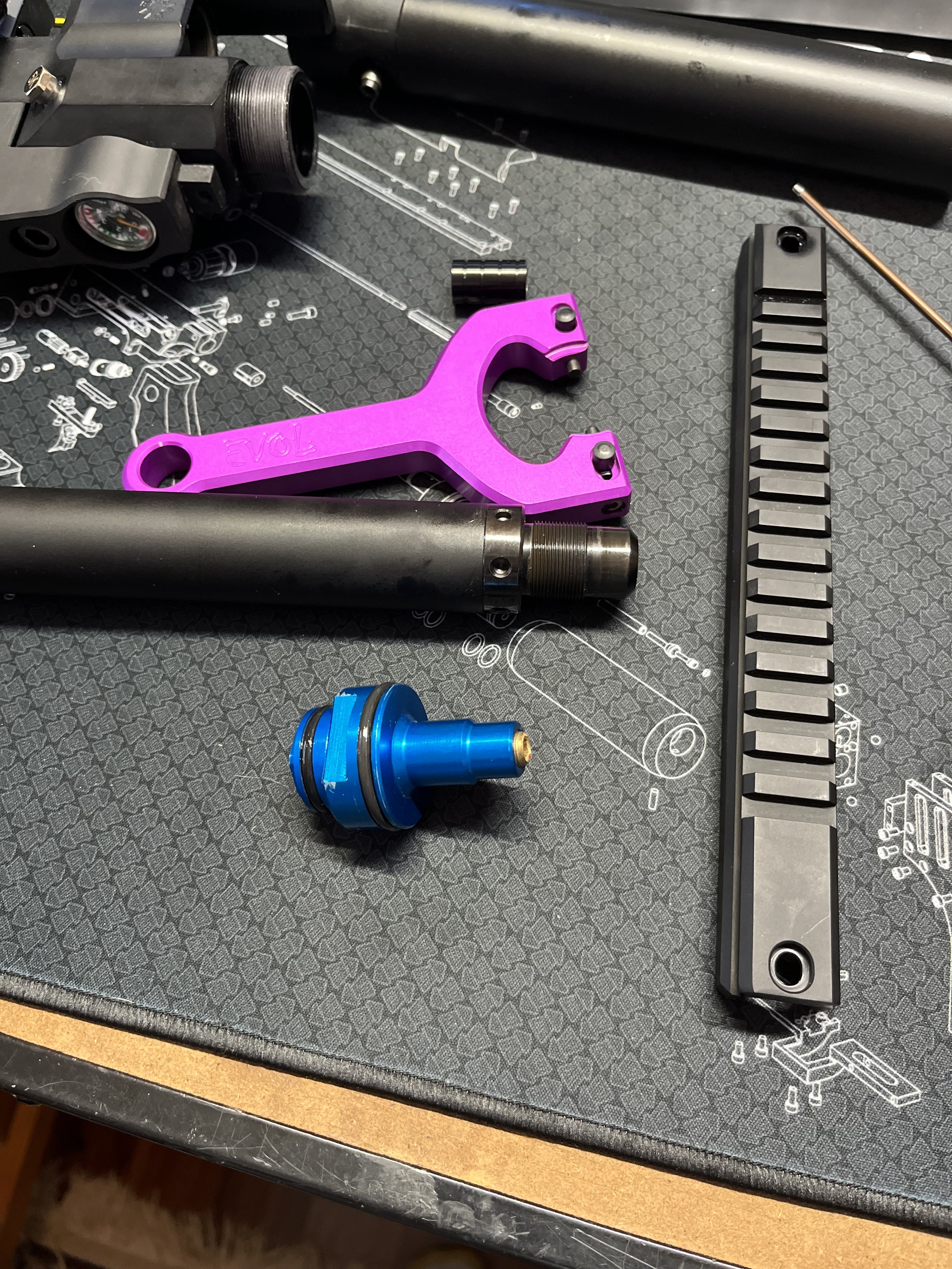

A bit longer than expected to take some photos, but I've been shooting it nearly everyday I get the chance. Came shooting around 40fpe and I've dropped that down to ~36fpe shooting the H&N 21gr 5.50mm @ 880-900fps and the JSB 25.4gr Redesign @ ~800 fps. A laser so far with both.
The STO insert is extremely effective and while I would not call this EVOL loud, it is too much for my back yard shooting. I should be able to get some indoor to outdoor shooting in over the winter though while no neighbors are outside and their windows are closed.
