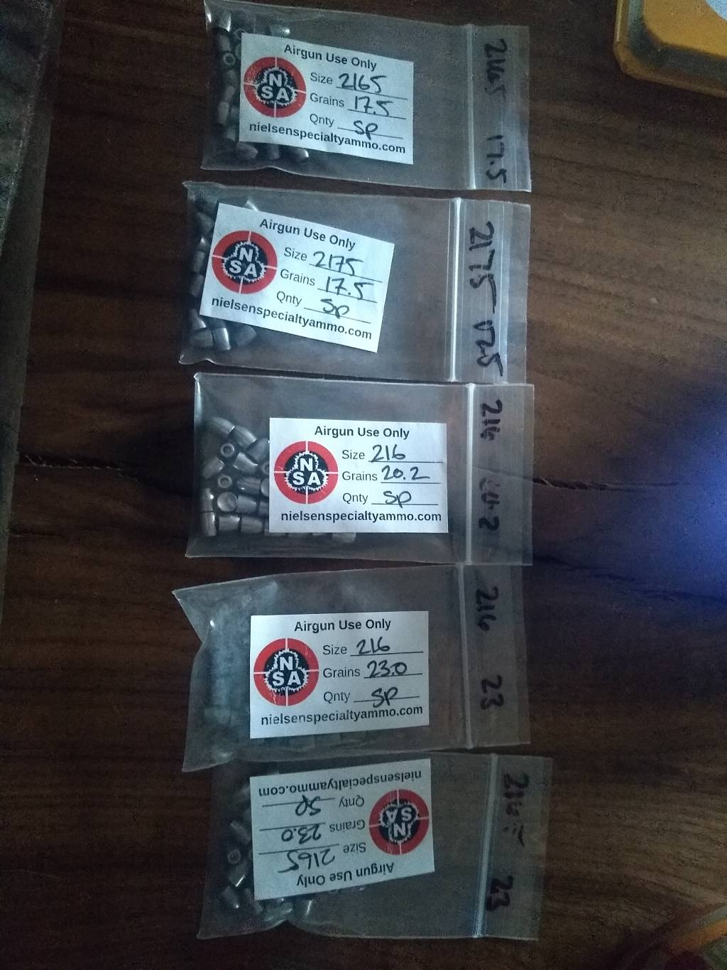

Well got out this morning on such a beautiful day for Jan 3 about 45 degrees and clear skies! Been having some rough weather lately. Temps are quite above normal as well. Anyways did my slug testing with the NSA Samples I got in. These ones are showing some real promise and ones I'm going to work with further. The speeds are 950fps with the 17.5gr, 890fps with the 20.2gr and 830fps with the 23gr. Thats just where I bumped up the speed for now no fine tuning but will do so when I decide which one to go with. Groups are at 57yds. Some are really good others not so good. Will need to stretch it further at 100yds to see which ones hold up best there before fine tuning.
It appears that all of the groups have nearly the same poi spacing between each shot, regardless of group poi shift and speed. (With a couple group standouts each way, of course). This may be because of the majority of those packs are .216" diameter slugs, and the barrel may like a tighter slug. A .217-.218" diameter may work well to tighten up that pattern without a need for tuning to correct the difference between slug and barrel sizes.
