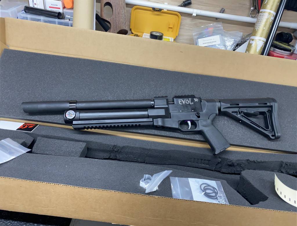

EVOL has landed!!!!

Imported it from Krale in Netherlands they have just started stocking them.

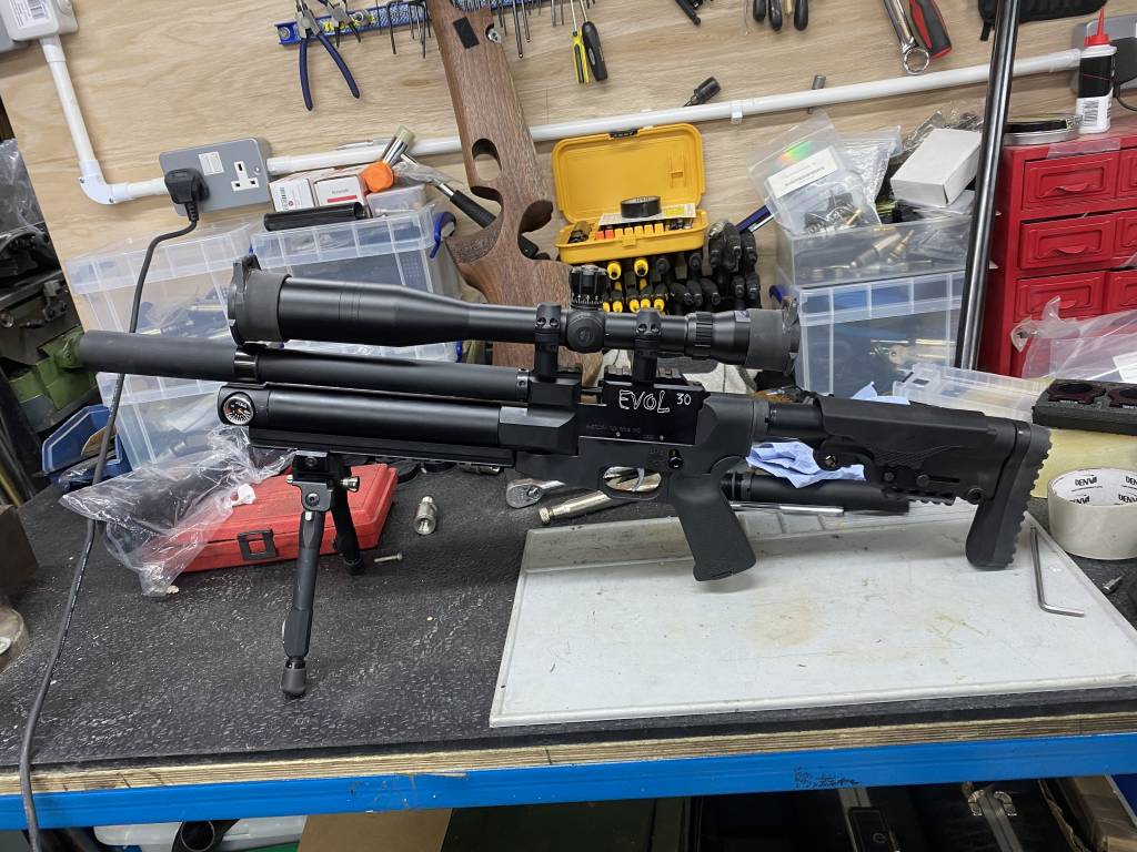

Have swapped the stock for one I took of one of my RAWs and put the scope on so far
Compact and rock solid platform. Glad to see AAA is branching out with distribution so everyone can have the ability to purchase and appreciate the craftsmanship there.
A quality .257 barrel would be the best of both worlds in power and keep it user friendly.
Wow - the is pretty sweet looking r1guy. There may soon be two in the country if I can't keep my CC stowed away. I was comparing the power of the Magnon on AOA and the .30 Mini at Krale. Magnon is spec'ed up to 75 fpe and the Mini is showing 77.5 fpe on Krales' website.
@r1guy - do you know if the barrel is choked or not? Wondering if it's a slug shooter.
