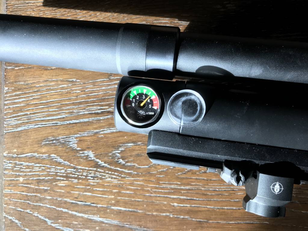

Got my new .30 and starting to get some led through it. As everyone says, the trigger is truly awesome. One slight issue is the glass on the tank pressure gauge fell out before shipping. When I received it and put it in it's a lose fit. When I go back and forth from inside to outside for filling the plastic condensates on the inside. Haven't noticed this on any of my other guns. These gauges aren't filled with gas, are they? Anyone else ever run into this with gauges?

Haven’t had that issue, but my manometer lags and makes jerky incremental increases as I approach 4000 psi. I usually go off of my tank gauge when filling. The gauge that came on the gun may not be be best quality. We can likely upgrade them fairly easily. I just deal with mine. To address your question about the gauge being gas treated, I have no idea. If it’s a new gun I suggest contacting the retailer or manufacturer about your issue. Can you post a pic?
Here's a pic of what's going on.

That’s just me speculating about the quality of the gauges considering your issue and what I noticed with mine. I can live with mine for the moment. I have more pressing issues and things I’d like to get before swapping out manometers on my Evol. As long as it’s shooting consistently and not leaking I’m content. If I had the glass fall off of mine I’d want to replace it. So hopefully your warranty covers this issue.
What’s this about another regulator? What issue are you having with your regulator? What’s your reg set at?
They should not be gas filled, nor have fallen out. If damaged like that in shipping, the shipping company should replace the gage. There is usually a small hole drilled in the back side of manual air gages, probably for atmospheric balance inside and out. Someone could have got water vapor in the gage checking for leaks. With the gun aired down for safety, you can use a hair dryer on low heat to evaporate the condensate from both the gage and lense before reinstalling the lense. When good and dry,inside, apply a sealing adhesive around the edge of the metal frame and snap the lense pack in place

Airgun hobibyist, thank you for the info on how to approach this. If it wasn't new I'd go that route. Still nice to know the hair dryer trick. And that they are not gas filled.
I also learned today that the correct names are manometer and regulator. Which are self evident if I just look at the words for a second. But I learned something and that makes today a good one. I'll do like Michael suggested and go to my retailer.

We are happy to replace your gauge, it is very simple to replace. These are all SS gauges made to our specs and have been very reliable compared to past manufacturers we have used. As posted above, they are vented to the atmosphere so sometime they will get moisture in side when traveling to different climates. Generally they clear up in a few days.
PM me with your details.
