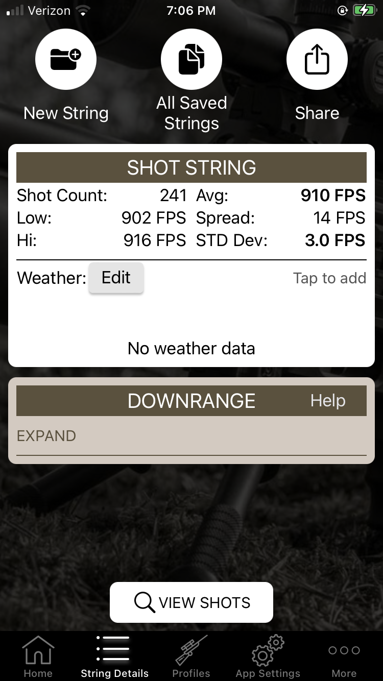

Check out this crazy chrono reading, lol
That’s with ammo straight out of the tin

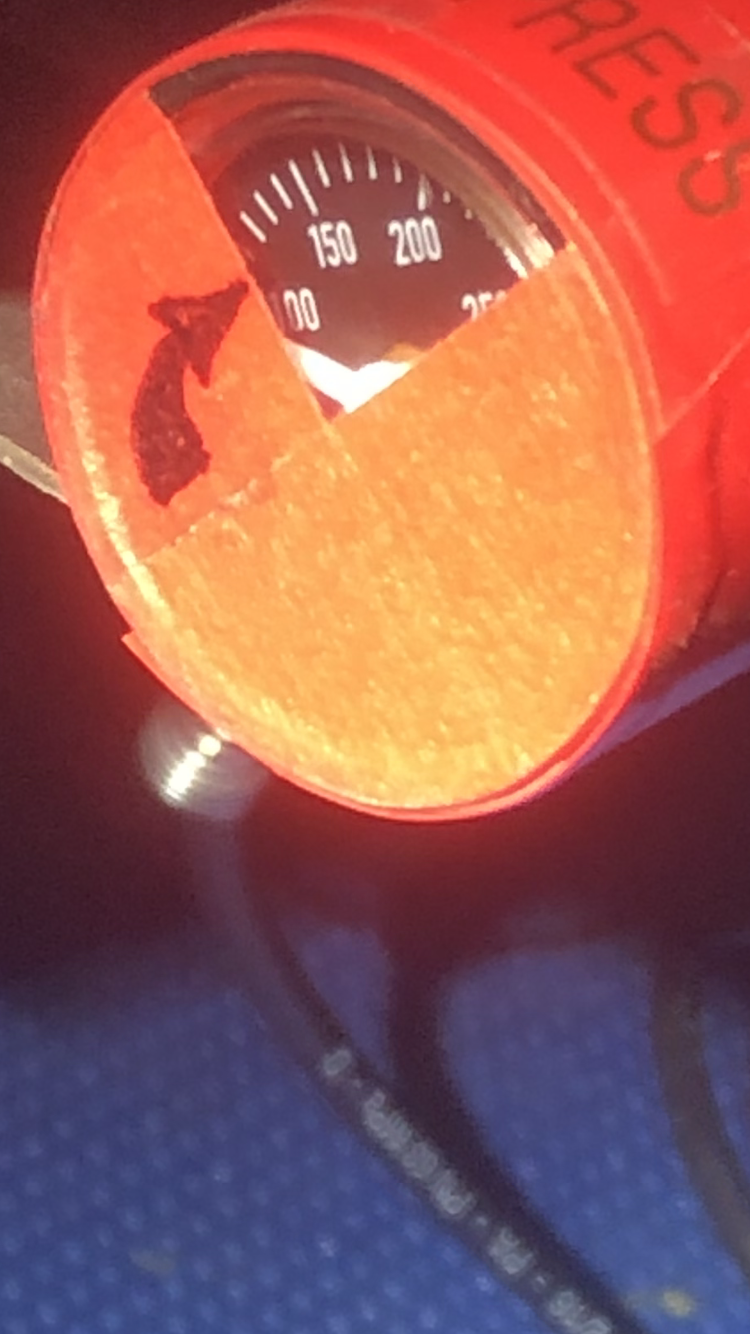

Added reg. But what’s even crazier is on day three of that chrono string I was on a shooting role and didn’t want to top off so I shot almost five mags and took my bottles fill pressure down to 85 bar and even with my HP set at 94 bar the gun just kept staying consistent in velocities.
Here’s a pic of my fill pressure gage before topping off- the edge of tape with arrow pointing to it is inline directly with 150 bar
That would definitely be a serious no no for regulated non electronic guns to shoot that low below reg
