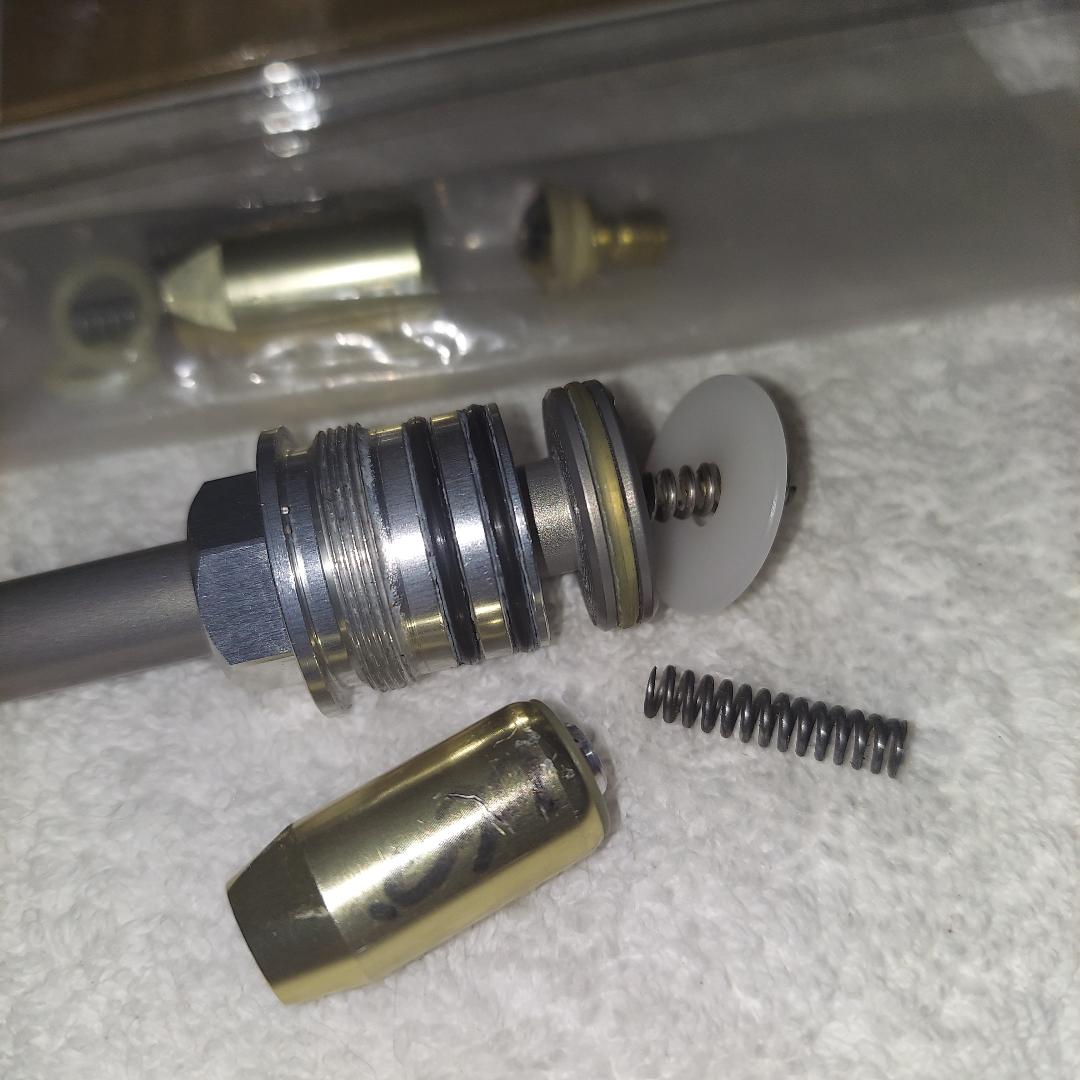

So far, I’ve only enlarged the high-pressure regular body. I’m a little chicken now that things are working so well…. I still may.. we’ll see 🤪

Unfortunately not, the adjuster cap will come off completely without removing the wire, and like I said on the sub 12 version the reg is deliberately not adjustable and lacks the plastic insert used, so I made one from delrin, wound in the adjuster by quite a few turns and all I saw was a slight drop in the pressure.
I am intrigued by the LP reg adjustment, so you have opened up the air paths in both regs now? And the final mod was to open up the spool valve poppet?
As my LP reg was not adjustable on the sub 12 version I did make an adjuster for it but found that winding it in did very little even after several turns, and it also seemed to reduce pressure rather than increase? Whether this is due to lower pressure in the HP reg making it not very responsive, I don't know?
My HP reg pressure sits around 1300psi and LP at 150psi this achieves my maximum allowed fps of 720 with a 10.34gr pellet but until I drilled out the poppet valve to 1mm the spread was always well over 10 fps now it stays around 10fps or lower.
The conclusions I draw from this is that although in theory small apertures are not a problem with HPA, but there is an application control it seems in the speed that the HPA can transfer so the aperture is a limiting factor, now I can understand this in relation to the poppet valve but not sure about the regs as the same?
Because of the speed of the air dump as the spool valve opens the poppet air feedback through the drilling is crucial to the speed of operation as the air is already leaving the gun behind the pellet and I suspect this is where calibre must come into it as this will also dictate the diameter and speed which the feedback closes the spool valve.
This is just my take on the way it works and could be completely wrong, as I am only just trying to learn the foibles of the system.

Can you give me your thoughts/knowledge on the way my LP reg is behaving?
And is the feed from the HP reg orifice controlled or just solely based on the HP reg pressure, IE because the HP pressure is low the resulting pressure available to is also limited.
If the LP reg pressure is the supply for the opening solenoid then increasing it can only have a limited effect on the opening speed as it's controlled by the electronic pulse/ dwell length and by its own orifice size and those between?
PS also have you tried increasing the poppet drilling size larger than 1mm? Once I get my spares, I will be giving it a go just out of curiosity.
