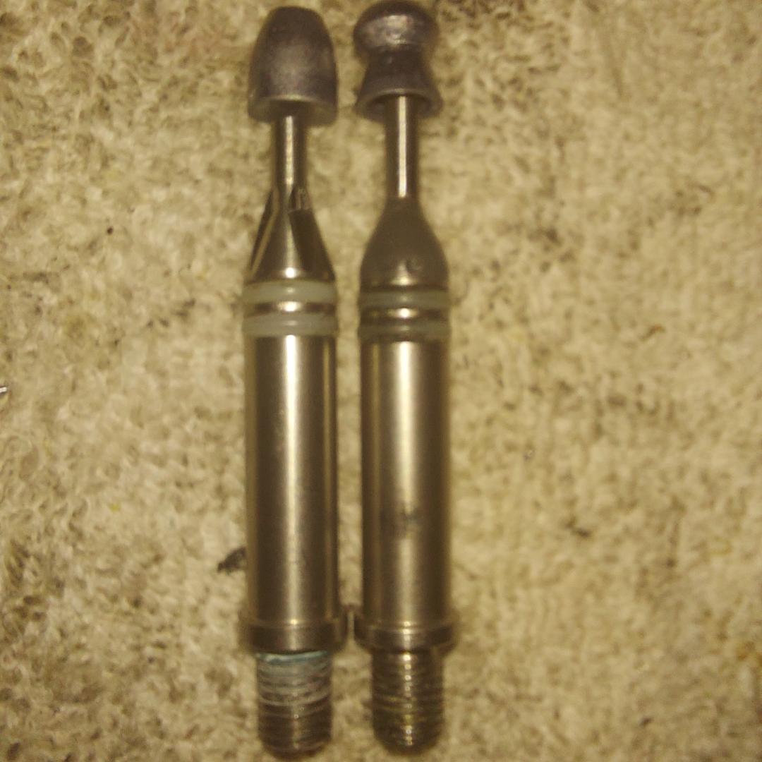

I’m going to replace the two O-rings on the poppet seat next as well as the pellet probe which I have done once before and see what that does
Well, I heard back from Skout.
Originally, all of their pellet probes came with two O-rings, but they’ve since switched to using just one. 🤷‍♂️

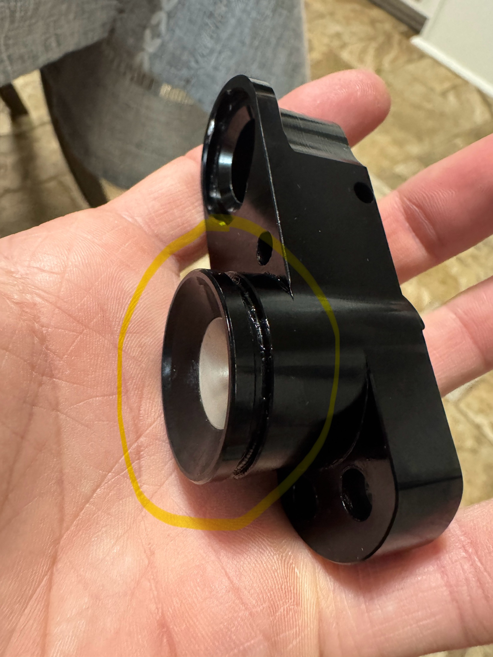

As for the small puff of air I noticed coming from the breech block during firing — turns out I was right. Skout confirmed that in some cases, a small amount of air does escape during a shot. Keith explained that if you look closely at the breech block, there’s a small hole located just below the valve seat (the part you swap out when changing calibers). Air can occasionally escape through that hole.
he said you’ll notice it through the seam in the valve block
Interestingly, they used to plug that hole, but decided to leave it open as a kind of built-in safety vent. The idea is that if the spool valve ever fails and allows air into the chamber unintentionally, this vent can help prevent a misfire.
While I understand their reasoning, I’m not completely sold on the idea. I may try plugging it myself just to see if it has any impact. Keith mentioned that the tiny bit of air loss shouldn’t affect pellet velocity — and maybe with larger calibers that’s true. But with something like a .177, even a slight shift could be enough to push a pellet off target by a couple millimeters. That may not sound like much, but in the type of precision shooting I do, it can be the difference between a hit and a miss.

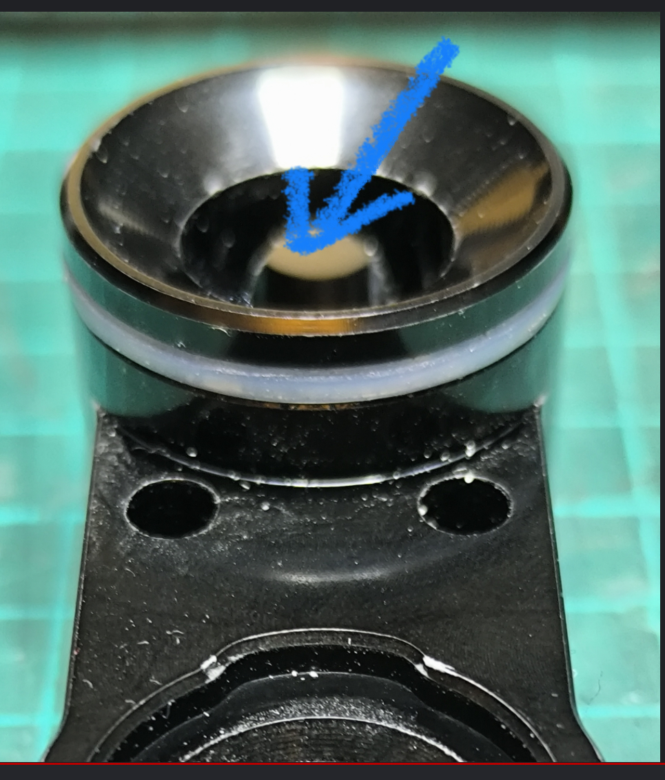

Although I thought I am not quite seeing it, after examining my pics it does seem entirely possible, and I am surprised that it's not more prevalent?
If you look at the first image, the small hole doesn't look that small to me! And if you consider the two O ring seals are placed either side of the aperture its quite easy to see that air can easily escape around the valve block/seal due to the restrictions imposed by the pellet and any further restrictions like I have with my TP filler, looks like I will have to now try firing a pellet with the valve immersed in water.

So in your first picture I can see the hole that I was talking about in the valve block. Yeah … not so small of a hole.
I think I’m going to plug mine and see what I get.
