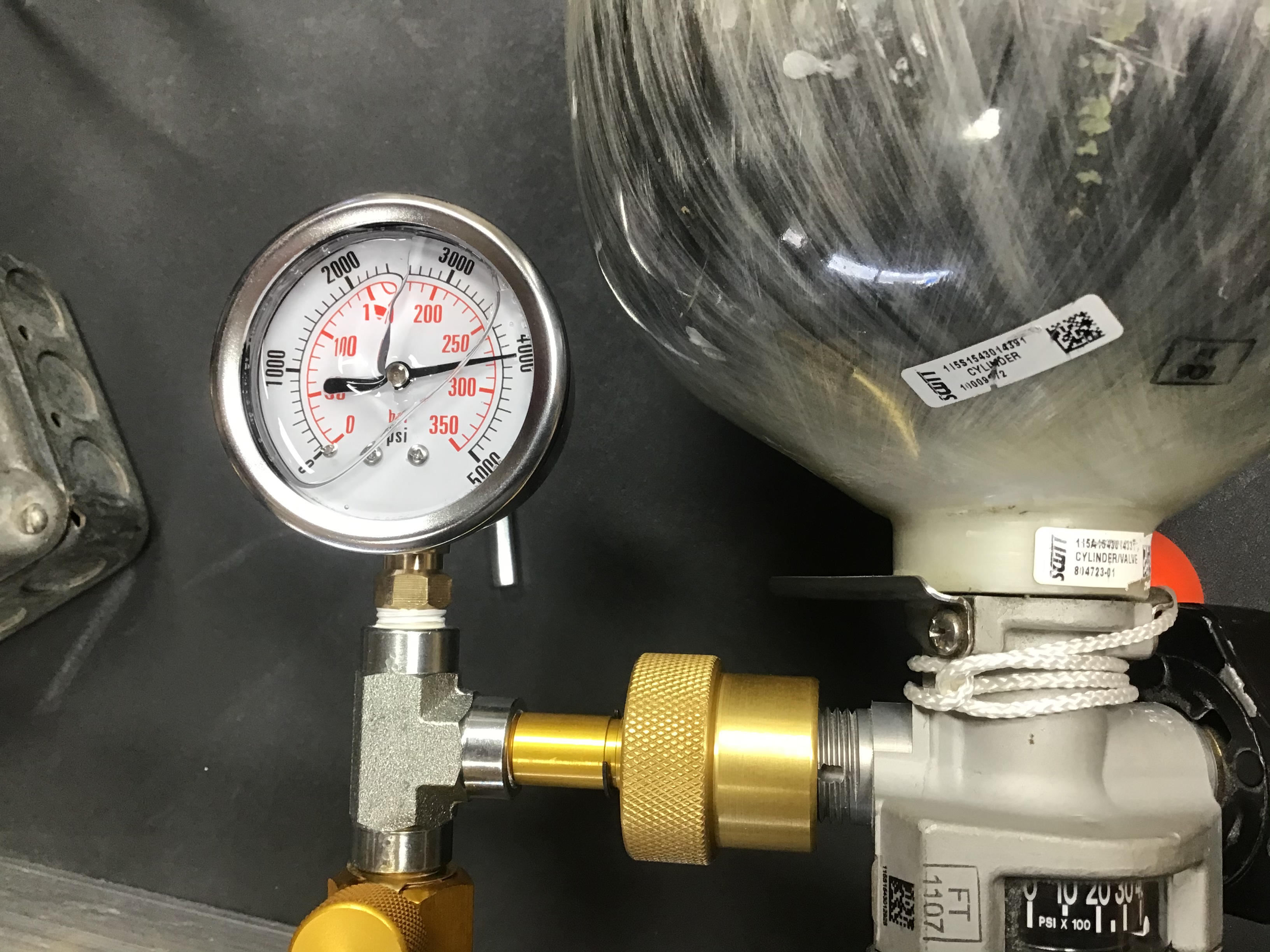

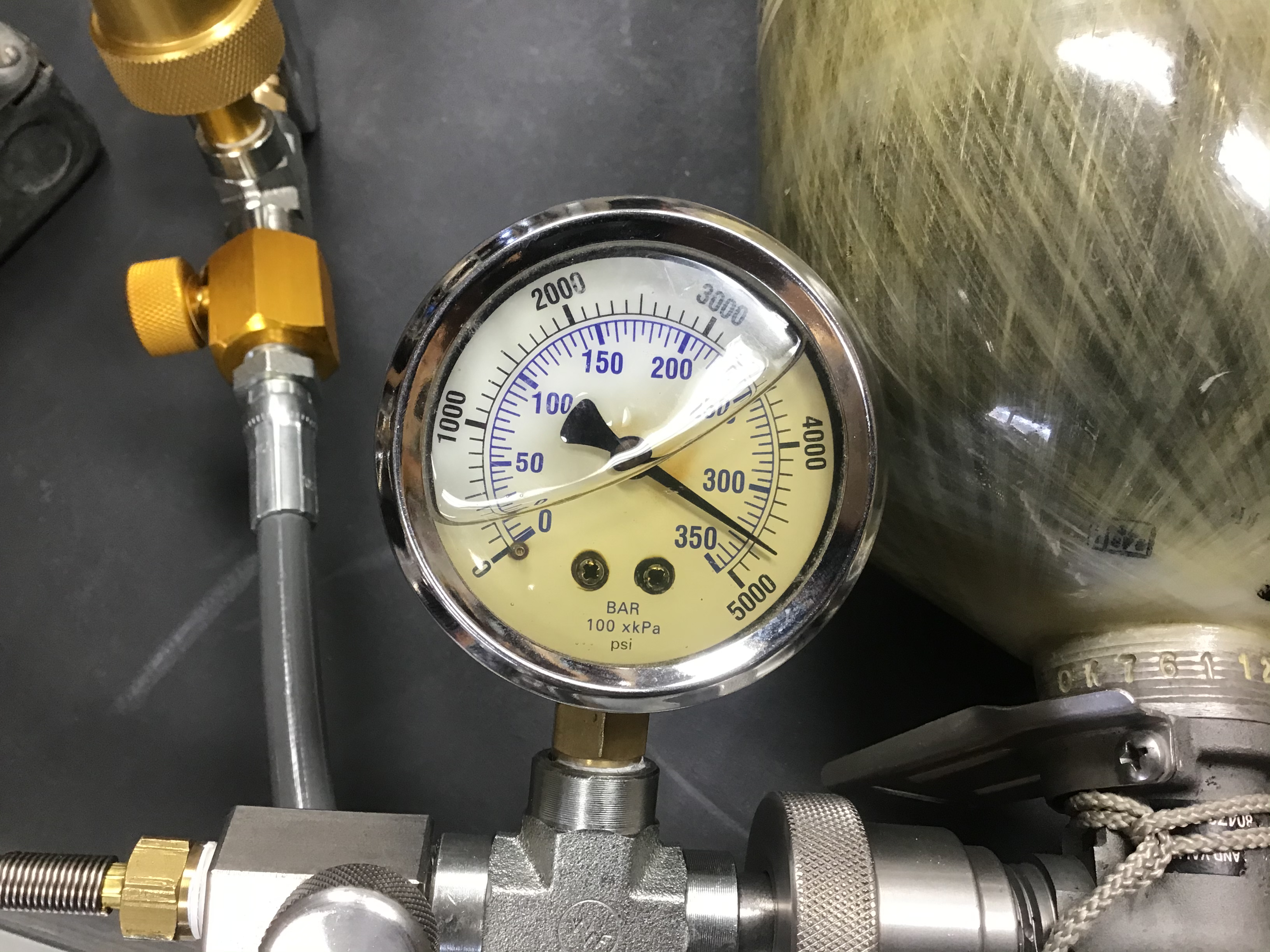

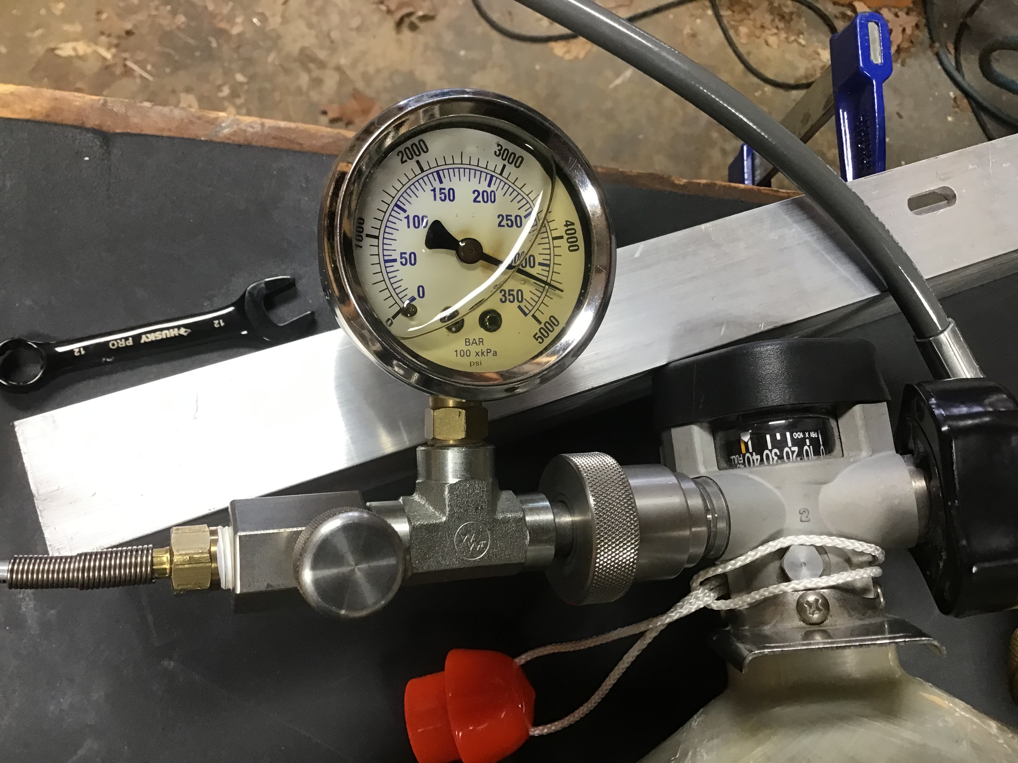

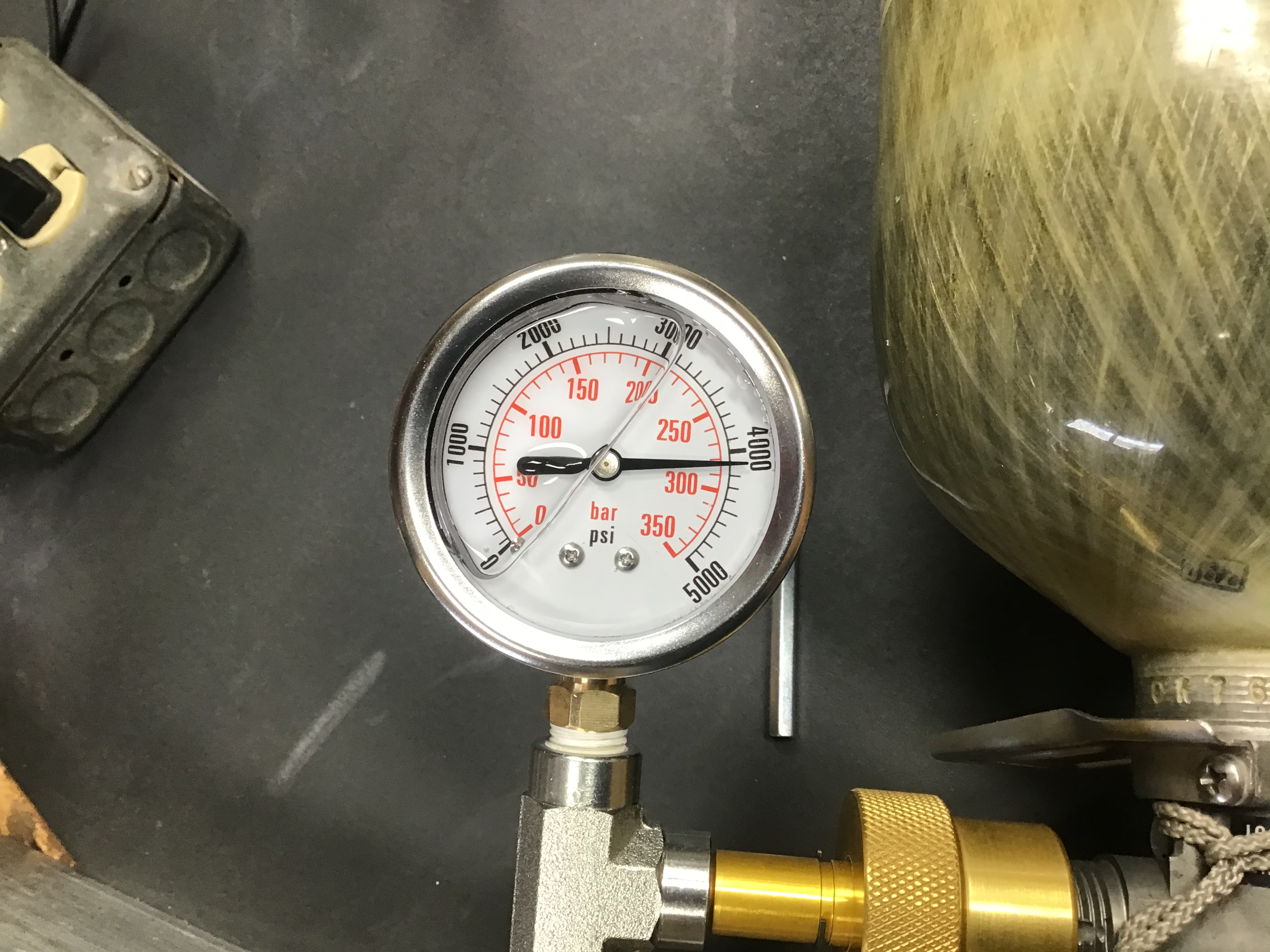

I purchased a used scba fill set out of the classifieds month or 2 ago. Unknown to me how old it is. Most likely a couple of years.
Anyway, turns out the gauge is reading 40 to 50 bar high. It almost seems like it gets worse every time I use it. Gonna need replacing.
Anyone else have this happen?
I started to question my fill pressure in my tanks when my guns wouldn’t fill completely. Took a little while for me to figure out and to put together another fill set to compare it to.
pictures are old bad gauge vs new “good“ gauge — multiple gauges seem to match the new ” good” gauge — no other gauges I have match the readings from the bad one. Two sets of pictures of 2 different tanks
