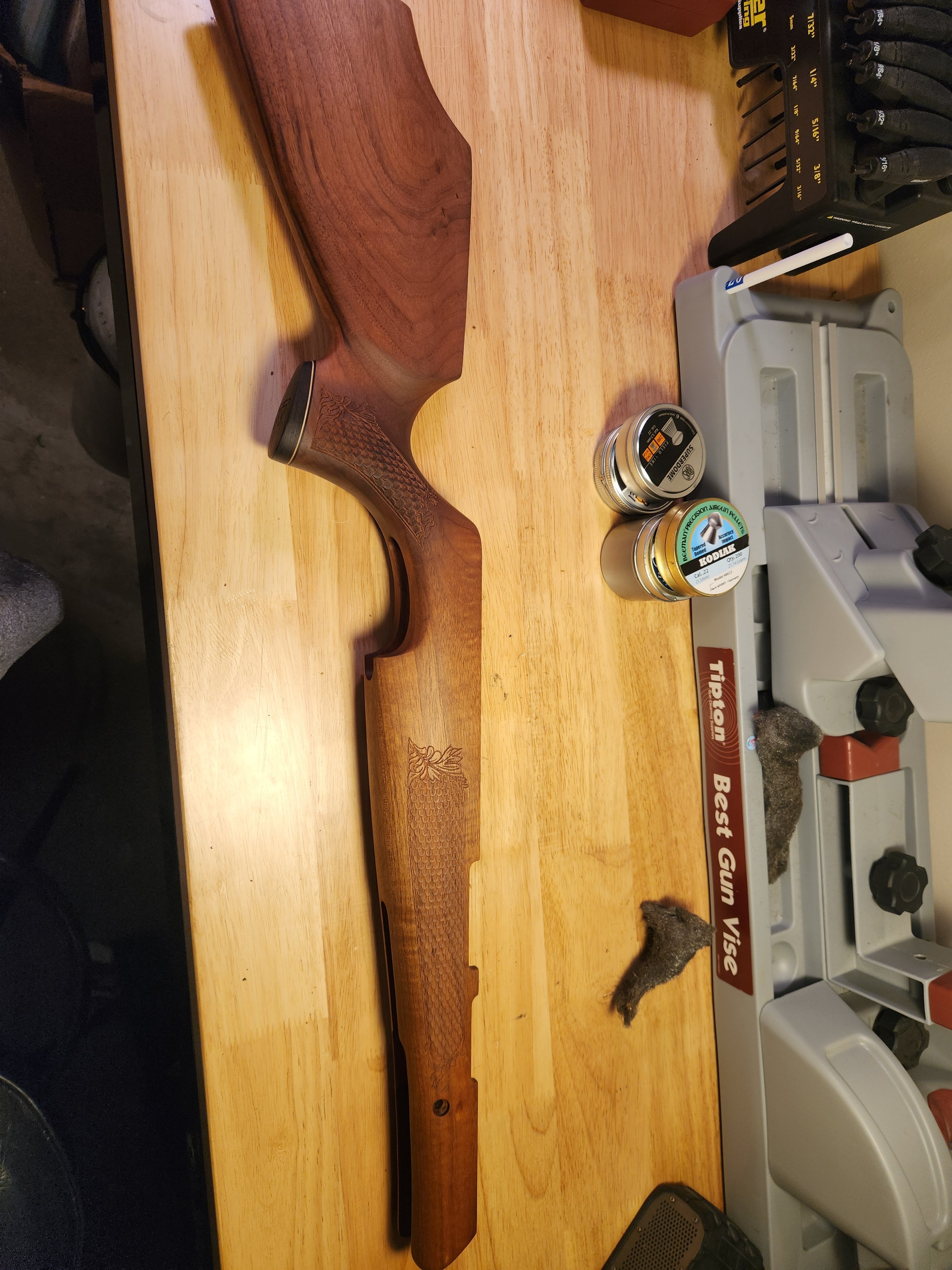

Thank you guys, the instructions suggest cutting it with mineral spirits.
As for the hand squashing method, what do you do about the checkering areas?
Do they look same color or are they completely different color when youv'e finished?
In the checkering areas I rub it in with my thumb. They will look the same colors as the other areas.
Just remember to use a very small amount of linseed oil at a time. Don't glob it on.

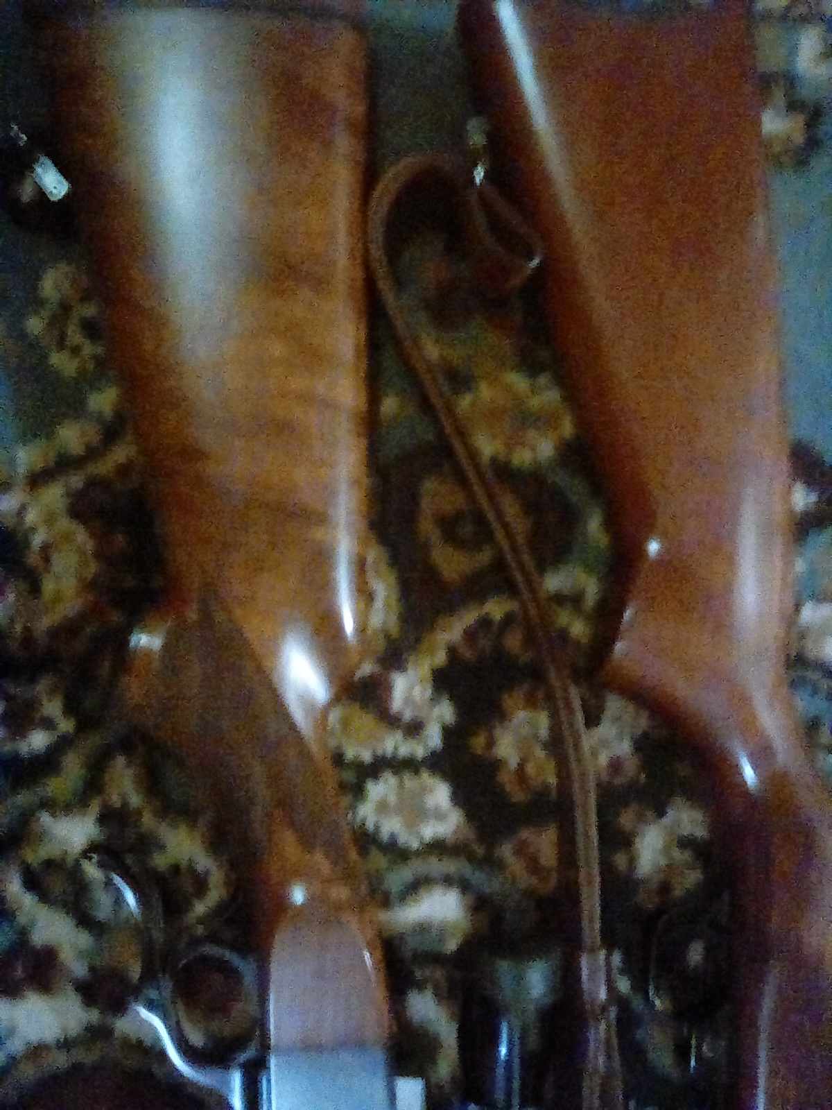

Here are a couple of the results I've had. The one on the right came out a little to glossy.
Reactions: bf1956
I use an old toothbrush for the checkering….suggest you thin your checkering brew, as you are only looking to seal it.
When the final finish is achieved, then one light appiation of blo... right?
Spoke to my old gunsmith today, he suggest straight BLO, on a cottton T rag. Wipe it on liberally, use an acid brush for the fishscales, wait 15 min wipe off with a paper towel. Let sit overnight. Repeat for a week.
I applied first cost and it already looks better.
By the time my new spring kit arrives, the stock should be up to snuff.
I will try send an after pic if this works.
